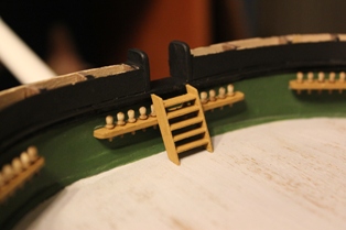

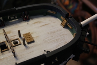

I am about to glue the rail caps to the bow and stern. I am making the grate walkway on the bowsprit, and other items that need to go in this location. The hammock railing was/is more work than I had first thought!

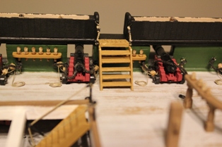

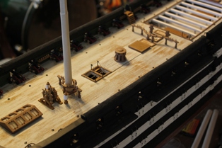

I have finished the Hammock 'Netting" and the bow and stern bulkheads. I am working on the access from the bow ladder to the bowsprit. It is finished, except I will not install it until The bowsprit rigging is in place since all of the standing rigging passes under it or to each side of it to the hull.

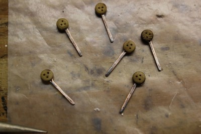

I am now installing the lower dead eyes. I expect this to take some time, so I will post a few photos as work progresses.

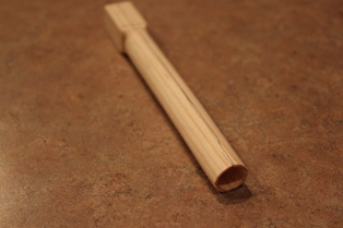

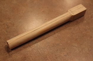

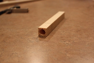

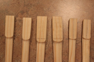

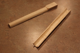

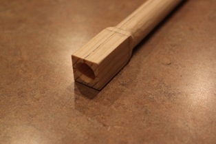

I took a break from the chain plates, and decided to work on the masts some. Here are some photos of the process I used to make the cheeks.

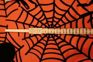

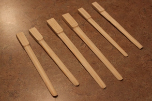

While I am having the dog bones made by a friend, I have moved on to the masts. Here is what I have done so far. I had a tough time coming up with something to make the mast hoops with. I could not cut sheet brass straight enough, and brass stock was too thick. I ended up buying some "French tinsel" on a spool from a fly tying parts website. Wrapping it around the mast three times gave me the thickness I needed and also a nice even width.

That looks like sharp work! The photo background is definitely errr....
.... challenging to view !
Is there a close up of the underside of the platforms...?

I'll post some underside views soon. I do have cheeks for the other two masts. I am doing the main mast now. As for the cheeks being banded, I am using photos of the OHIO and drawings of the VICTORY to guide me. The cheeks are banded in both cases. The Yards and Masts plans for US 74's by Charles Ware are pretty crude. I could not tell if the cheeks were banded in them. It seems there are some number of cheek designs. The Constitution for instance incorporated the pounch and the cheeks in one piece. Sorry about photos not being enlargeable, I still do not have the trick down yet. I still have to install the bibs as well. Thanks for the heads up on the block rigging on the bottom of the platforms. I know it is a matter of personal choice if sails are rigged, either furled of brought up. Full sail hides a lot, and I do want some sail on her. I was thinking of unfurled top gallants and perhaps a spirit sail with the rest furled? Any suggestions anyone? If I put on sail at all, would I need to include every sail line? Do not know much about the sailing aspect of ships, So I do not know if some sail line was stowed or other wise lashed up when the sail is furled? I will need to do some research.

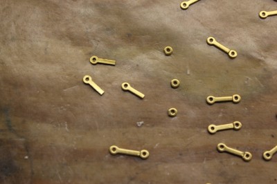

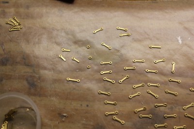

My buddy says it is too hard for him to make the dog bones in the size I want (he tried). So, I bought some 15 mm pre made dog bones and cut out three mm and super glued them back together. I may need a drop of metal filler on the crack and then file down to fill in the crack. I will see how much a couple coats of paint does on a couple first. I have also made the dead eye strops for the platforms. I am almost done banding the cheeks and installing the bibs as well.
Jim, I think I got the photos to open correctly? I am limited to 150 mps on the up load?

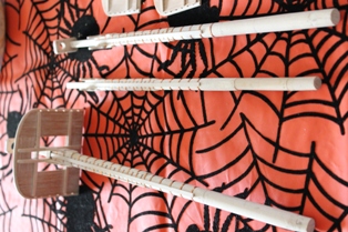

I am making progress on the masts.
I need to send my new camera in to be serviced. The built in flash is not working.
So, I will be with out this camera for awhile. I will install the dog bones along the hull, by the time I am done with that, I should have the camera back (10 days or so).
OH, And I should have the Halloween table cloth stored away.

Been a while. I have been conversing with the gentleman who built the USS OHIO that I have provided a link to in a previous post. He has been 10 years building this ship and will finish in time to display it in a new nautical Museum opening in Pennsylvania in April of 2011. I had many questions for him about how he did certain things. Like how he attached his chains. I have done one side now, and will finish the second side in a few days. My camera will not be back from the shop until around the 22nd. So, It will be about then that I post more photos of my ship. I have also made progress on the top and top gallant sections of the masts. I just ordered the book "The Rigging of English ships of war 1620 to 1860". I should be able to get a better idea of what needs to go on the undersides of the mast platforms, or so Steve (name of OHIO builder), suggests and I believe someone on this forum also did. Bob, was that you?
Anyway, I can at least paint the masts before I put on the blocks on the platforms. I find that my mizzen mast is about half an inch to far toward the stern. I hope I can adjust this without it being to obvious. I lines up with the chain plates better if I move it. Don't ask me how this happened, I am scratching my head trying to figure it out my self. There is a yahoo group that is devoted to US Ships of the line that I have been viewing and thinking of posting a few photos of my ship to. If anyone is interested, the link is on this forum on page six posted by PC Coker.
