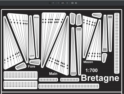

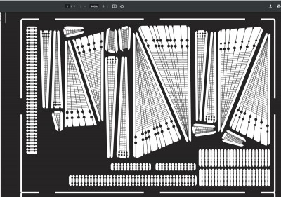

apropos Ratlines...
I had some ratlines drawn up and etched for me for my upcoming( * at some stage *) 1860 BRETAGNE project
my Bretagne will be 1/700
These are relief etched
The thing with PE shrouds and ratlines-they in scale AND Robust in small scaless
your 2 models are more than twice the scale
- which will allow greater variation of line thickness
and more effective relief etching
--whilst retaining the repeatability and symmetry( as well as strength))
( many -( but not all ==>McNarry Reed etc )-- small scale ratlines are either overscale or very un-even
with your painterly skills you well add magic...to the PE in 1/300 scale
The artwork below is the 2 sides for Bretagne @ 400 % enlarhed (!)
note the dead eye sets and the relief etched footropes
Mine were done in Stainless steel , --- brass is just too soft and vulnerable during the remaining rigging process

Many thanks everyone! :cool_1: :smallsmile: :cool_1: :smallsmile:
Wow Jim, those look great! :thumbs_up_1: :thumbs_up_1: :thumbs_up_1:
In 1/700 scale, I would definitely go for PE too. Certainly the best choice by far!
But in 1/300 scale, the main mast shrouds of Victory are 0,3 mm in diameter, the mizzen shrouds 0,2mm. At that thickness, I have to admit I like the 'twisted rope' effect Philip Reed achieves with copper wire. Both the twisting and the soft copper will also be very helpful for the heavy battle damage I will have to inflict on them I think. So, I would like to give that method a try first.
But if I fail miserably, I will of course turn to photo etching! ;)
