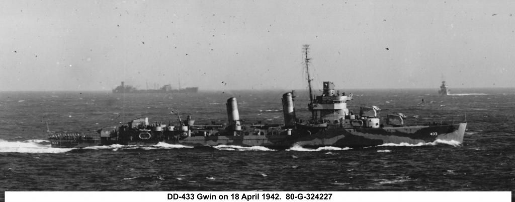

A photo of USS GWIN on the Doolittle Raid dated 18 April 1942, shows that she only has 50-cal MGs onboard (all twelve of them). Gwin also has a longer pair of drop depth charge tracks than her sisters.

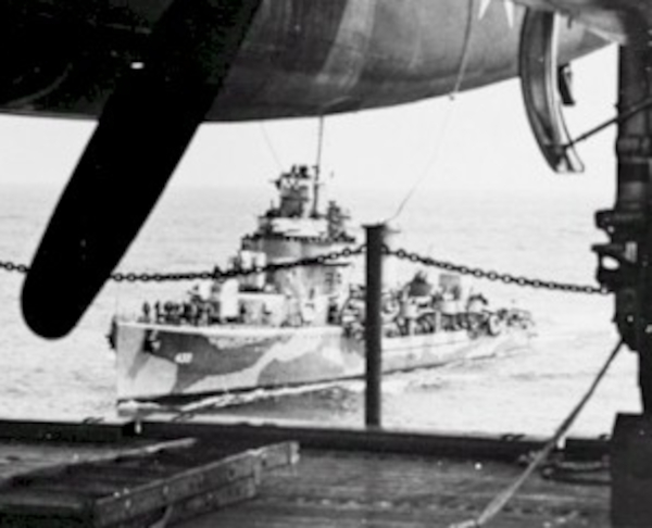

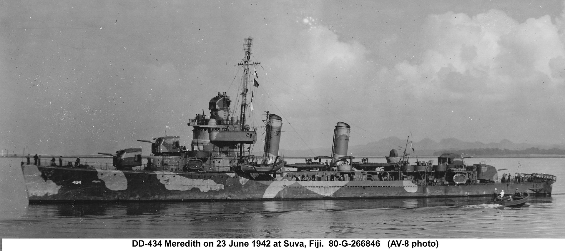

Photos of USS MEREDITH on the Doolittle Raid dated April 1942, appears to show that she has at least two 20-mm guns replacing the middle pair (port/starboard) of 50-cal MGs on the aft deckhouse. It is undetermined if the two MG's forward of the bridge are 20-mm guns or 50-cal MG's. A photo dated 23 June 1942, shows that MEREDITH has the two 20-mm guns on the aft deckhouse as seen in April 1942, plus two forward of the bridge. With a total of eight 50-cal MG's.

Now I grabbed the beautiful starboard side shot of Gwin in her Ms 12 mod paint, I've been looking, and can't find a similar shot of her port side paint, I do have the shots of her off the Hornet stern quarter during the raid and I can discern the scheme for the port forward quarter, it's quite a bit different than the starboard side..... do you know of any images of her port stern quarter? I have the abilities to draw up her approximate port scheme in Gimp if I can get a shot discerning the pattern...
The scheme holds a lot of similarities to her sisters being they all came from the same yard and use the same basic pattern, but Gwin's has enough variations to be quite distinct and definitely not something I can copy over starboard to port, the two sides were very different.... (and there is enough photo evidence to show that difference plainly)

THANK YOU!
Those two bottom pics of the Greyson and Kearny are wonderful very clear and very close to what the Gwin wore...
This is an image of the Gwin that I cropped out of a pic of her coming up on the starboard quarter of the Hornet during the raid...... (shows most of her port side but at a very steep angle)
That's the best image of her port side I can find, you can clearly pick out the pattern as far back as the propellor guards....

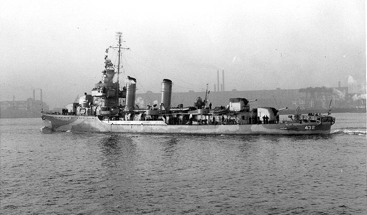

I also have an image of the Kearney DD-432 showing the stern port quarter.... (shows how they wrapped the paint around the stern)
And the Greyson DD-435 port stern quarter.....
That adds to the info needed to recreate it as much as possible.....
Thank you very much, I think both the Kearney's and Greyson's scheme is very close to the Gwin's scheme, not exact but very very close.... Except for the stern wrap....
EG

Ok, this is going to be a dumb question, well there is no real "Dumb" question but I'm confused and need some clarification......
This image show Gwinn without her Mk4 radar on top of her Mk37 gun director....
Now I've seen many many shots of destroyers with this radar, so many in fact, it's ubiquitous of the type....
And yes I know that censors were scrubbing out radars on photos meant for wide distribution. (usually the mast top search radars)
Except the clip I got shows no sign of such scrubbing.....
So I start checking....
USS Meredith.....
Also doesn't have it and the pic hasn't been censored... Doesn't even have the mounting bracket for it yet the crew poking out the top hatches of the gun director are plain.... (her SC radar is clear and in plain sight as well)
And the base pic of USS Gwin from April 12th, during the raid shows the same....
No Mk.4 Radar on top of her Mk.37 gun director while her mast top SC radar is in plain sight.....
So both ships didn't have the Mk.4 installed while on the mission?
Interesting... I can't see the censors taking out the Mk.4 without taking out the SC.....
Opinions from the experts please?

- Posts: 3871
In one of my earlier posts, I listed that USS GWIN and USS MEREDITH both didn't have the FD (Mk 4) radar installed as of April 1942. In the aerial PHNY July 1942 photo I posted, you can see that USS MONSSEN has a FD radar and USS GWIN does not.
Here is another image of USS GWIN (DD-433) I forgot about that I had. I found this one in 19-N negatives that there wasn't a print of the photo in the 19-LCM files, showing the location of her battle damage. So I scanned the 8x10 B&W negative. I was pleased to find this image since it has been a question mark whether she had been painted in MS 21 prior to the November 1942 battle.
It is NOT of the portside, but does show her Ms 12R(mod) pattern in December 1942, prior to it being painted over with Ms 21 after Battle Damage Repairs. Note that she doesn't show a Mk 4 antenna in this photo either, not even the brackets can be seen. Many times when a unit was going back stateside for major repairs, "useful" equipment that could be installed on other units remaining in the forward are, was stripped off. This practice carried on through out the war. (One of the reasons that USN Yards did "Arrival Surveys" to find what was missing.) But, it doesn't seem so in this December 1942 photo.
