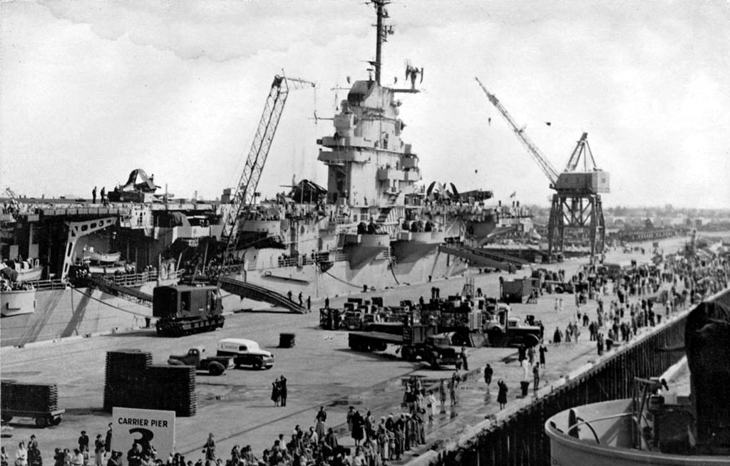

Here are the two actual photos of Oriskany.
Thanks for any suggestions on what would be the best way to do a conversion.

It doesn't look like the Lindberg kit has the widened hull you'd need... appears a PITA either way.

ORISKANY was a long-hull variant of the ESSEX class and, as such, starting with a LEXINGTON (CV-16) kit simply will not work. I would usually suggest using one of the post-war Dragon long-hull kits, but Dragon has never been able to get the bow shape, portside hangar doors, and flight deck length correct for a long-hull. This has been very disappointing because the errors have been so severe, and there does not appear to have been any serious effort by Dragon to correct them.

Doc wrote:I'd like to build a straight deck version of the USS Oriskany but at the same scale as my angled deck version. I've aquired the Lindberg USS Yorktown which is the right scale for my needs.
Here's my question:
Do you think it would be easier to convert this model to Oriskany...or convert an angled deck model of the Oriskany to straight deck?
You have a lot of work either way. As was mentioned, the Lindberg kit hull isn't blistered to the proper width. Unfortunately, neither is the Revell Oriskany. I don't think Revell had any idea about what had been done when the half-finished ship was modified under SCB-27A. The hull blister was literally built into the hull structure, with the original side plating at the ends of the blister removed and rerouted around the outside of the blister. This made the side plating continuous from bow to stern. The longitudinal stringers were rebuilt, so the "blister" longitudinals were the actual hull girder. But above the hangar level (which, on an Essex, is all superstructure above that level anyway) the original hangar sides remained. This produced an apparent "inset" for the hangar sides. Revell missed the blister and kept the original WW-II hull width. They then had to narrow the hangar to get the inset. This is why the escalator outboard of the island doesn't line up above and below the flightdeck level, and the island itself has no structural support below the flightdeck level. (Since this is all plastic, the deck is sufficient to hold it up, but this structure would never work on a real ship.)
The Lindberg kit has an issue with the bow, as well. It has the long-hull deck plan with the short-hull profile. The hangar side openings are all wrong, and there is a profound lack of detailing. About all you will have is the flightdeck and the lower levels of the island. Both will need to be improved, but everything else will have to be totally built or rebuilt.
The Revell kit will have the island, but the flightdeck will have to be reshaped, and some type of planking detail added. Then the after elevator will have to be represented on the deck. The hull will need a total rebuilding to widen everything up the the flightdeck level. The enclosed bow will have to be opened and some sort of forecastle deck fabricated. The starboard deck-edge elevator will have to be removed and the 5" sponson constructed in place of it. You will need 5" guns, 3" guns, and the tubs for the 3".
And the list goes on . . . .

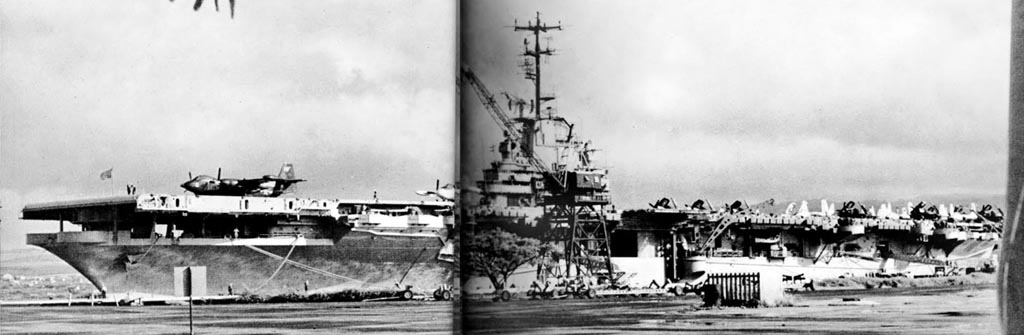

Looks like they carried the tailcode "SR". Two photos from Terzibaschitsch's CV book of Tarawa in 1955 show that she carried SH-34 helos, S-2's, as well as AD-5W AEW Spads, and AD-5Q ECM Spads. All are in Gull Gray over White with the S-2's in overall Gloss Sea Blue.
She also has plenty of twin 3"/50's at this time so you'll need to find some of them in 1/700 which AFAIK no one makes short of a couple found on Dragon weapons frets (1 per carrier kit).
If you want the photos I'll scan em for you. Let me know.

Alright here you go man; All the info the book has on the Tarawa in the 1950's. Plus a photo of CVS-39 that someone on here should find useful :wink:
Photoshopped 'em a bit to up the contrast and composite them together
If you want them at their full 300dpi resolution message me your e-mail.
150DPI
Hope these help man! :)
