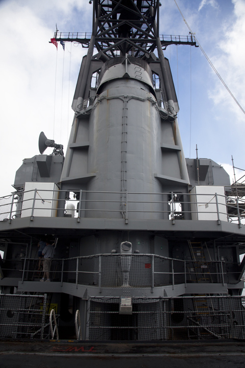

Note that the aft tripod legs start on top of these stub bulkheads at the back of the stack.
Cheers: T

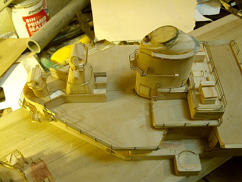

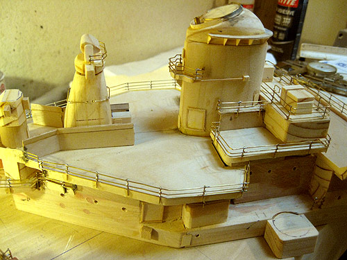

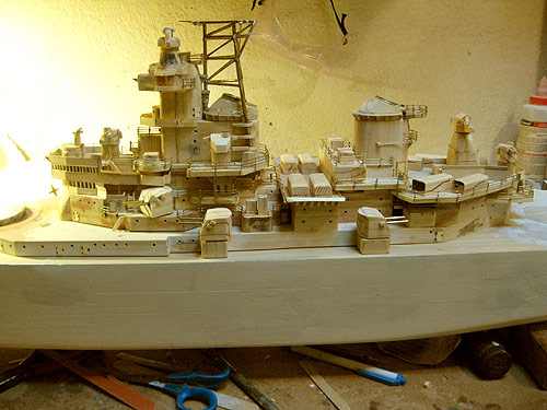

This is todays posting of photos.
Mostly working on railings. Lots of railings.
Went to get coffee.

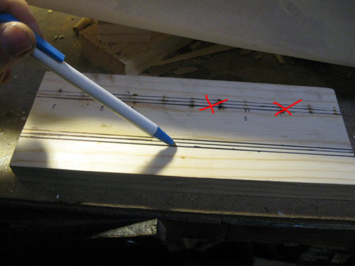

Checking in from new Zealand, lots of progress. What method are you using to solder the rails and the mast works? I had just started the mast when I left.
Cheers: T
Luky
Posts: 221
Joined: Tue Dec 11, 2012 8:27 pm
Location: Guerneville,CA
Re: 1:192 USS Missouri modern configuration
Post by Luky »
On the railings I use .020 thousandths wire.
I know it is too large, but it looks ok and is workable.
I use a pine block and make three lines with a ball point pen.
I press hard and the soft pine leaves a indentation for the wire to lay into.
All three rails fall into a .200 thousandths space.
I put blue tape in several spots to hold the wire in the grooves.
I use short pieces of wire .020 for the uprights and solder them one at a time measuring the distances between the uprights to fit the model. Then when I have a section finished I trim the ends making sure that the rails face outwards. Also when the section of railing is still taped down I take a finger sanding board and file the backs of the uprights of any excess solder.
After the section is bent to shape and it will fit right onto the model perfectly I mix up some Devcon 5 minute epoxy and apply it with a tooth pick to the spots where the rail will sit.
If for any reason I need to solder part of the railing while it is in place you need to put a small aluminum (rach clip) on the wire close to where you are soldering to keep the entire upright from becoming unsoldered.
The heat usually makes the epoxy come undone so repairs should be avoided.
IF the section being made fits as perfect as possible without pushing on it to make it fit
then you will not have many problems.
On large sections I just glue half then come back and glue the other half.
The big SECRET is trimming the rail.
Use finger nail clippers. They work perfect.
Went to get coffee.

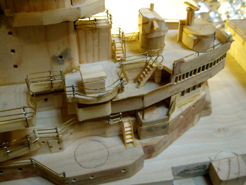

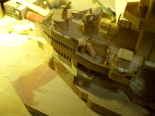

More photos.
I reworked the ladders again.
Scale 1:192
Went to get coffee.

I also reworked the bottom of the mounting of that "tuna tower".
It may not be perfect but thanks to your photos it is a lot better.

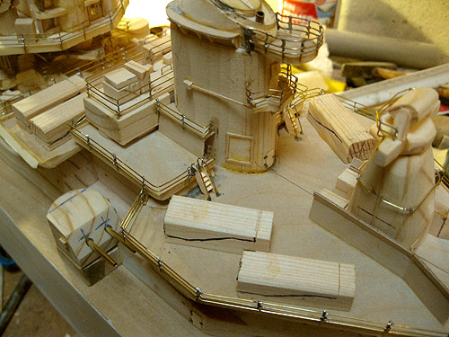

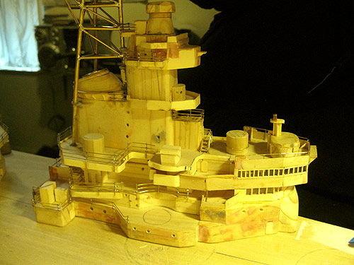

These are todays photos. Mar.20th 2013.

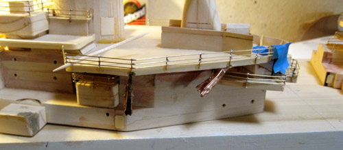

looking-aft-port-side .jpg (118.7 KiB) Viewed 891 times
Went to get coffee.
Posts: 5068
Post by Fliger747 »
Donald:
Check out the area carefully around the Harpoon deck abeam the aft stack. There is a walkway which is at the levels of the two Tomahawk decks and connects them. The harpoon area is narrower. On Missouri there is a walkway Port and Stbd in the current configuration. Some ships had only one on the stbd side. The shapes are slightly different. I am not home now to be able to show you what this area looks like. Also on Missouri the aft Phalanx deck does not have rounded undercuts as is shown on plans for some other units of the class. One would think it would be easy to get info on this ship, but much out there is not correct or forthcoming in detail.
Keep up the good work! When it comes to finish what is your plan?
Regards: Tom
