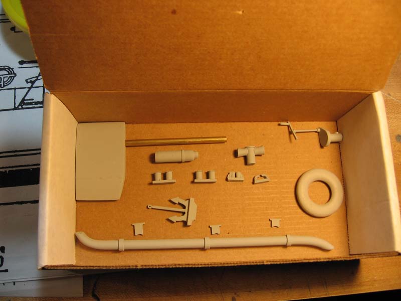

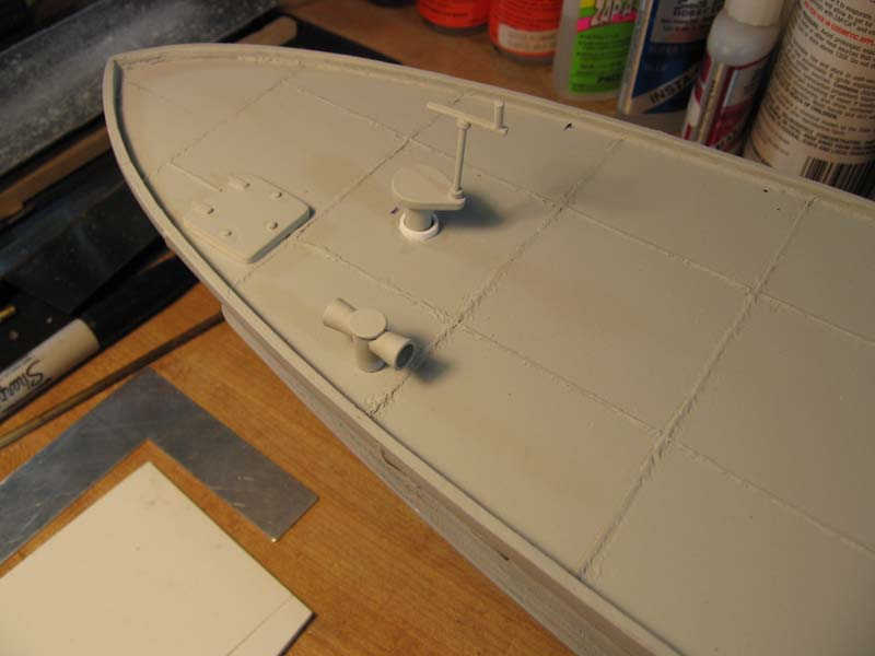

Lots of little parts done today.
The anchor wench. The shaft and handle you will have to make from brass. I'm not going to make resin parts of the ultra small stuff. Better in brass and you won't break it off all the time. Also the vents.
I have found from picture to picture things very greatly even on the same model of boat. But these all look like the pictures I have not so much the Mig model.
The exhaust which in most pictures of the real boat is not seen. This is like the Mig model and some of the drawings I've seen. It looks cool so I made it. Still have to finish it off tomorrow.
The rudder. It will come complete as seen with 5/32 shaft in place.
Tomorrow the life preservers. Now again looking at the pictures from the war I don't see them on the railings at all. Some on the deck and on the side of the wheel house.
I'm not going to make you every small part as every boat was different. But will provide the basics and necessaries. I will include drawings to scale, brass and styrene to make the parts that will not lend themselves to molding.
More tomorrow. I'll do the moorings next anchor, and the NAV light boxes for the wheel house.
Monday it's go over the whole set of masters and do any clean up and prep for molding. By the end of next week I should be able to cast up the parts I need to to build one and get it in the water.
As soon as I lay one up and build it I can fix a price.

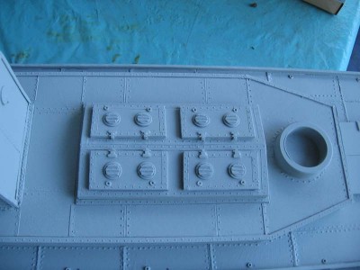

The masters are done!
I am now evaluating my resources here hoping I don't need to go out tomorrow to get anything! I know people in hell want ice water.
I'm just happy and full of myself because something that was started April 7th is done today. And mind you there were a few weeks in there where I did other things. Seemed like forever but the posts dates showed me it was far less time than I thought.
Molds and the build will be fast. So I'm getting excited.

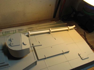

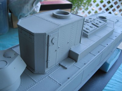

Today I finished more small parts.
I will of course document the molding process. As many times as I have done this, it always helps to show that one guy out there that might of missed it.
I will be using GI 1000 RTV. One of the very best. Stone mother molds. But thin and light. Have you seen the price of epoxy lately? Gas goes up and so does it. Thus the very high price. I'll save it for the hulls and decks.
Here's some nice pictures of the finished stuff minus the small stuff which you have seen.
More tomorrow.
Steve

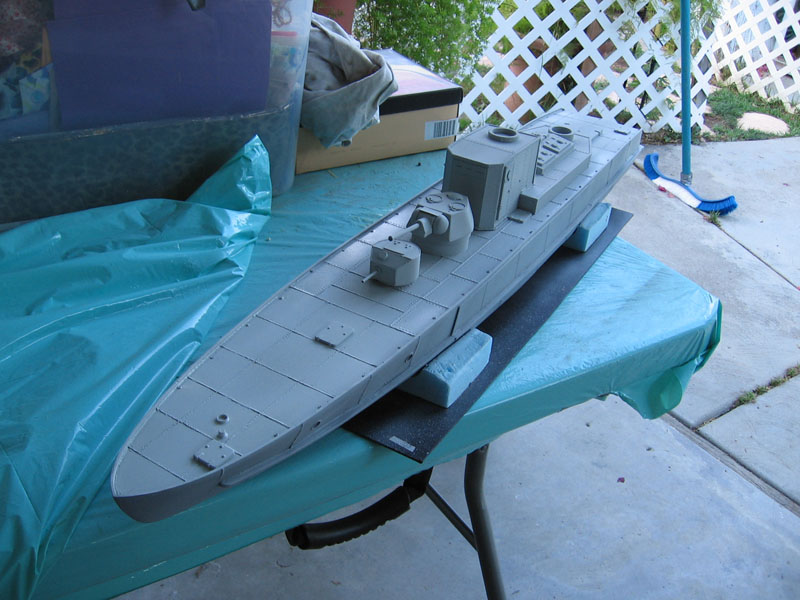

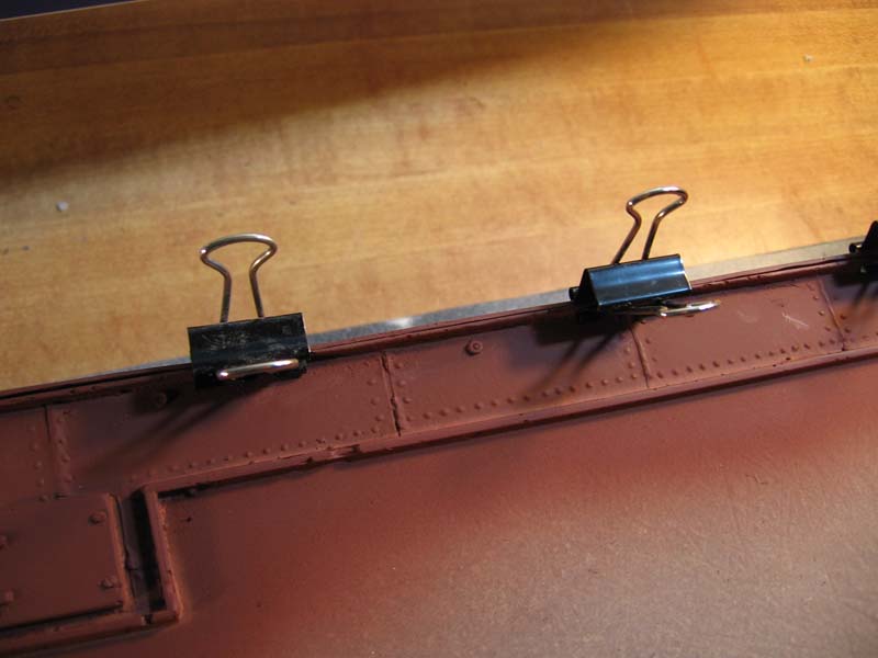

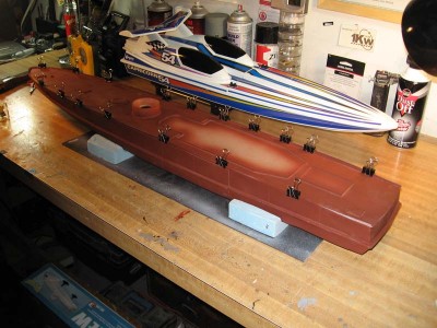

Spent the day making another deck for me. Trimming and grinding to fit. No fun there.
What I had to do since my mold planning was off was grind down the inside lip of the hull and the outside lip of the deck. Still adjusting now for a better fit but it's getting there.
Next tomorrow will be to fill the bad bubbles and flaws with Evercoat and sand. Primer and we are done with that.
I will install the rudder, motor, stuffing box, motor and servos tomorrow and make a prop all while making up resin pats outside. ?Now it's getting to be fun.
More tomorrow.
Steve

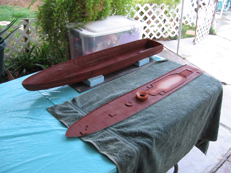

The hull and deck.
Trial fit revealed more standing at the bow and stern but close.
It need to fit like this 360. The access holes will be cut after the more and running gear is installed. But they are large enough to service anything that might be needed in the future. So far so good.
More tomorrow.
Steve
The hull and deck.

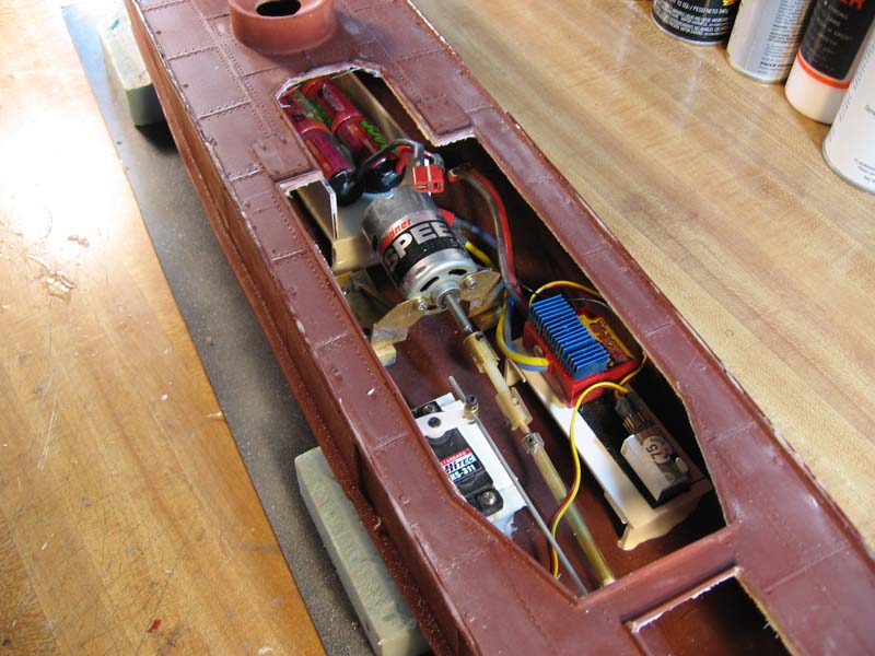

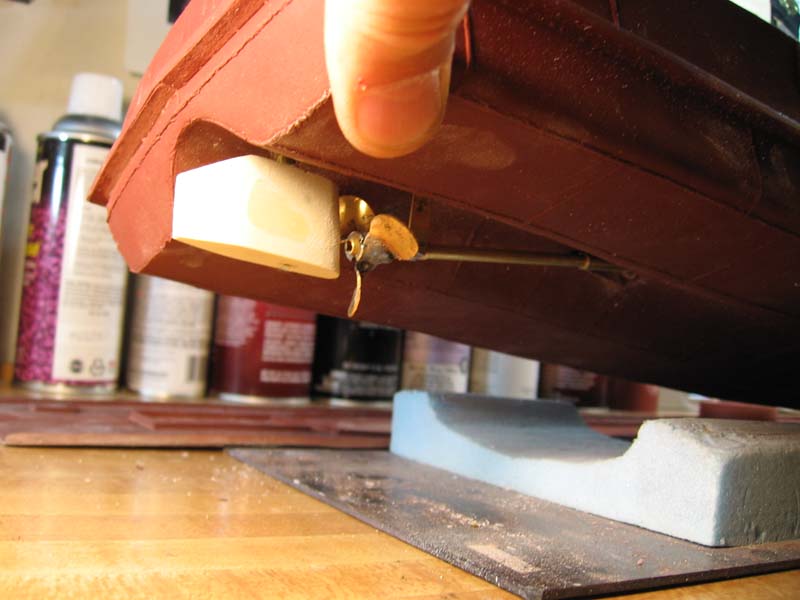

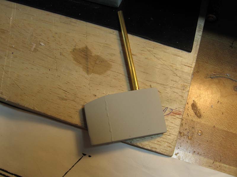

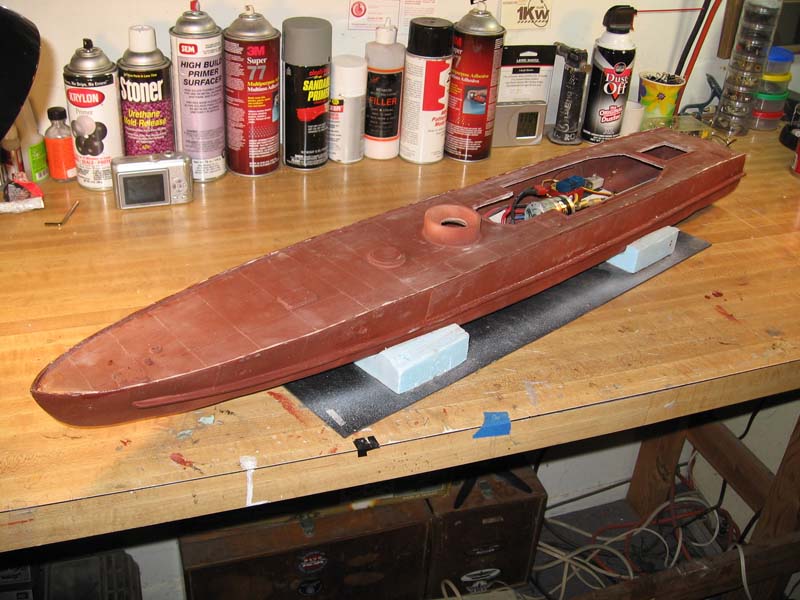

Lots of work done over the last few days. Made my own scale prop. Made the stuffing box. Got all the running gear in and the boat tested in my pool before I attached the deck and cut the access openings.
The boat handles well. I had my wife shoot a bit of video: http://wavelit.com/media/897/BK_1125_test/
Next I will cast up all the remaining parts from my RTV molds and start installing them top side.
Here's some pictures.
Steve
