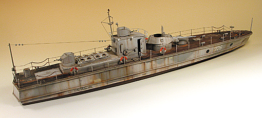

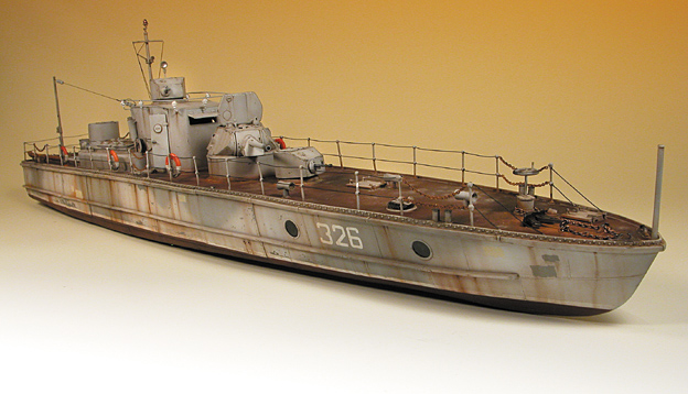

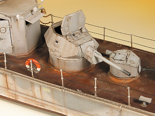

Here's some pictures of the Russian Tank boat. This is the MIG 1/35 scale model. I will be doing the version with two T-34 turrets. The more guns the better! Can't wait to start. I'll be working evenings and weekends on here. Hope you all enjoy it. I know I will.

Mig kit is resin and available through R&J Enterprises.

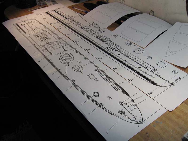

Re: Bronekater BK 1125 - Armored Patrol Boat 1/25 scale

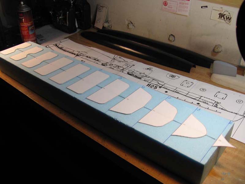

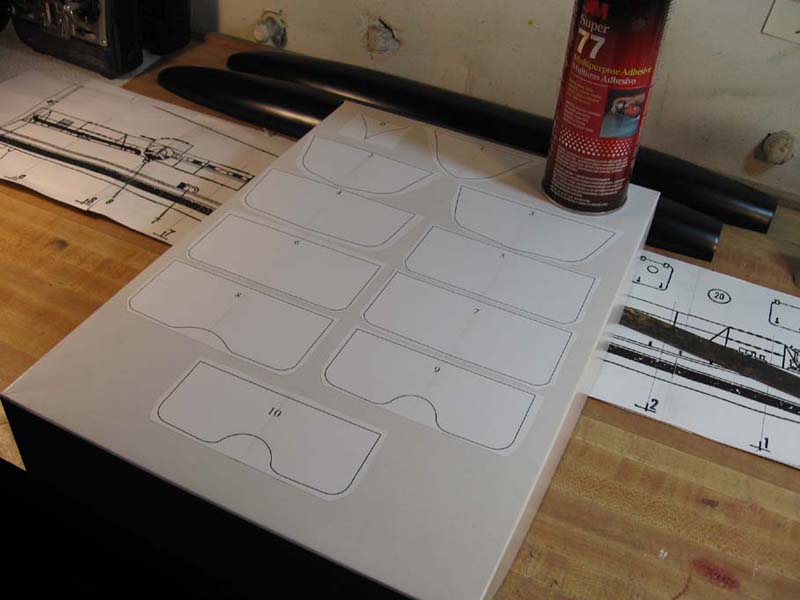

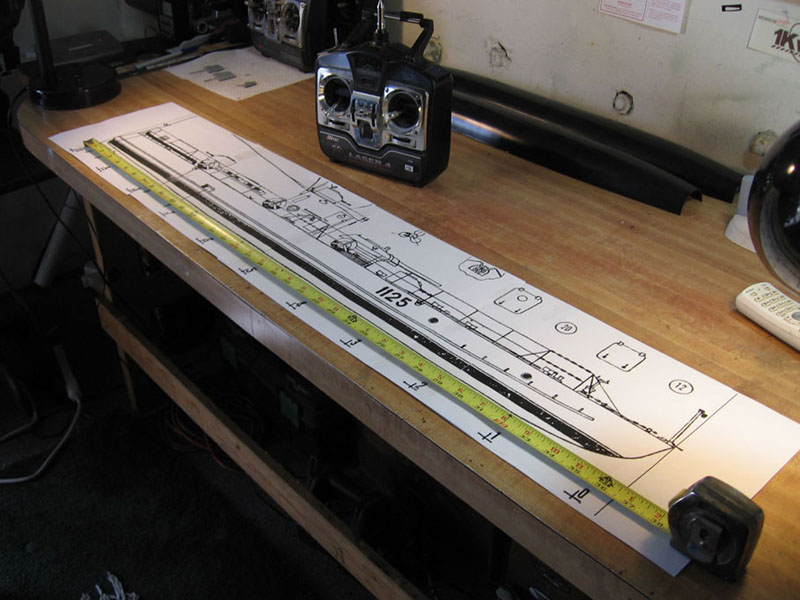

Well it begins finally.
Thanks to Gantu my work was made a bit easier as he found plans and cross sections which he took the time to clean up for me. Huge help!
All I had to do was enlarge everything to the proper scale. Now that the cross sections are printed out and the plans with the cross sections clearly marked the work can begin.
Next to transfer and glue to card board all the cross sections and cut. Harden the edges with thin CA. Once this is done I can take my block of high density foam and cut it to shape and mark the cross sections. Then I'll cut them on the band saw and tack the formers either side and start cutting this hull.
Steve

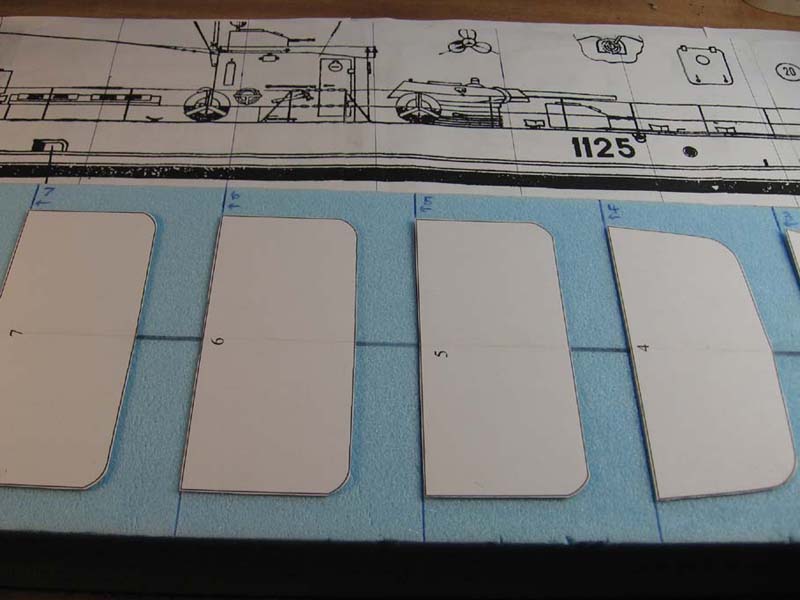

So I got all the formers scaled. Transfered to cardboard and cut out. Cut my foam block and marked the center and the cross sections. It doesn't get any easier.
Tomorrow I'll sand the formers to the outside black line. A bit of thin CA and sand again until smooth. The foam will be cut on the band saw at the cross section stations. Then the hot wire cutting can begin. Once that's all done we should have a hull to put together and take our first look.
Once I'm happy with it and do a bit of sanding, I'll glass the hull. Once that sets 24 hours and I sand it smooth the fun begins.
More tomorrow.
Steve
