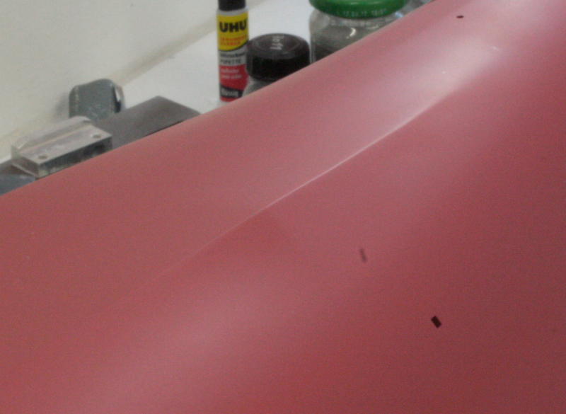

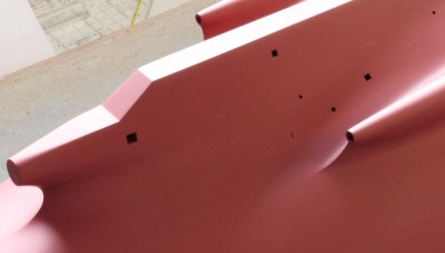

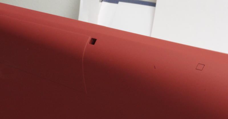

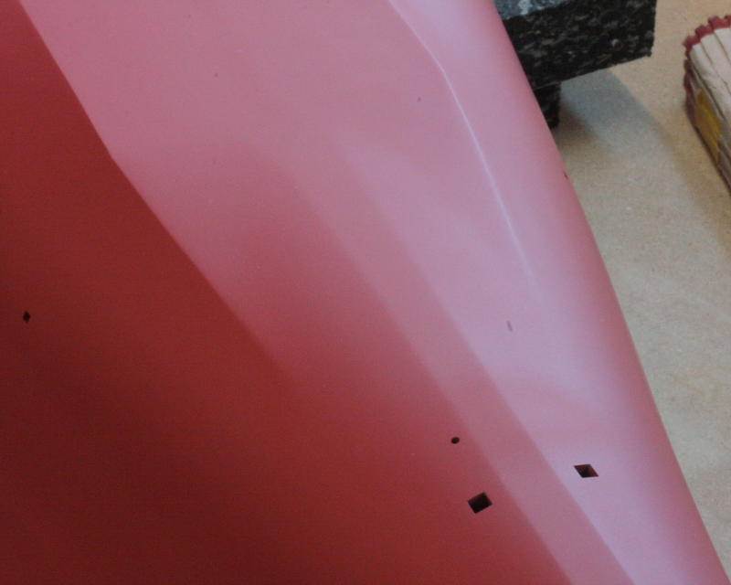

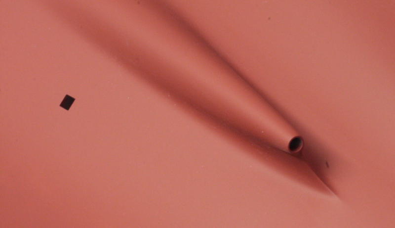

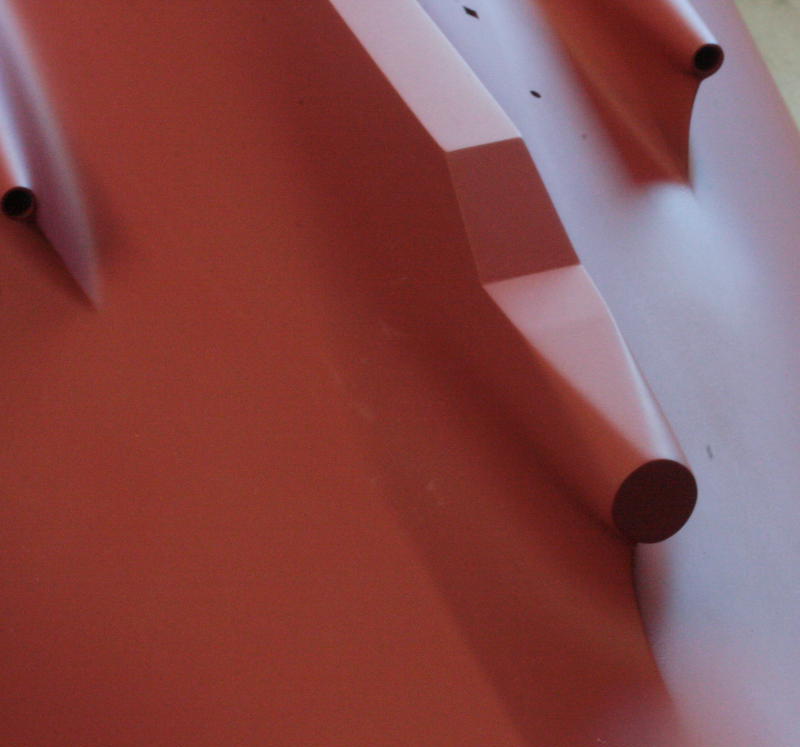

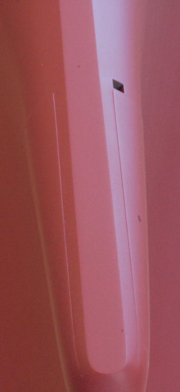

I had to spent quite some additional hours on fine tuning the shape and finish of my hull as I experienced some problems after applying a coat of paint. It revealed some issues that required work .. :-(
Here are a few shots with red primer and I am now able to go ahead with rectangular sea boxes and after them I�ll do the bilge keels along with some large inlets on the hull sides.
Bye now! :-)
Transition of the dock keels of plate runs C into the hull. Note 2 open sea boxes for sea valves.
Center dock keel = Plate run A. Front right sea valves is shown in the closed setting.
Lower edges of the doubble plating in the area of the bow anchors and an open sea box.
Overview.
Overview.
On the sides is a edge running up the hull side and crossing waterline 1. Ugly to sand an edge at such an angle! ;-)
Shell doubbling, open sea box and closed sea valve.
Overview of the stern area with shaft houses and sea boxes of different types.
Center shaft housing (not yet finished in terms of shape).
Outer shaft housing with trailing edge detail visible. Note open sea box for sea valve.

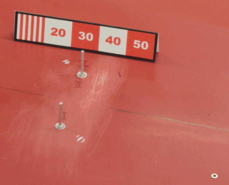

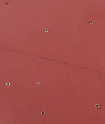

Little update.. some sanding (what else?!?! :heh: ) and added some reinforcements around the circular openings.
Bye! :wave_1:
Reinforcements around the circular openings.
