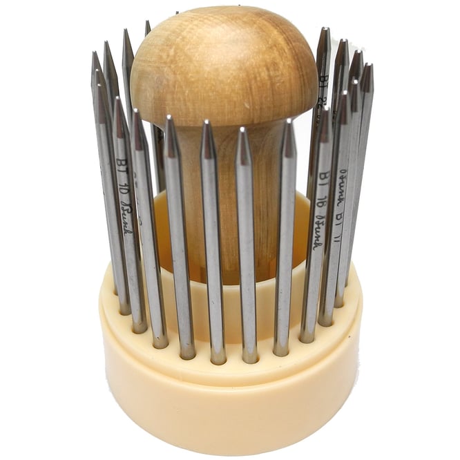

The bitts have a round hollow tip, each with a different diameter. You insert the bitt of your choice in the handle (in the centre, between the bitts), and press the bitt through a thin piece of plastic sheet to get the 'bolts', while the plastic sheet is held on a piece of firm rubber.
I used the second smallest diameter for the (about?) 0,15 mm bolts.

Probably you already know this, but this is a grainer tool:SG1 wrote: Sat Jan 03, 2026 3:35 am0.15 mm plastic bolts?? by grainer tool action? This is very inspirational :cool_2
- wefalck
- Posts: 2124
- Location: Paris
Re: HMS Victory and Le Redoutable at Trafalgar (1/300)
Actually, I have never thought of using a graining tool as punch

I learned it from this AFV-modelling book by Tony Greenland:wefalck wrote: Sat Jan 03, 2026 5:31 amActually, I have never thought of using a graining tool as punch :thumbs_up_1
It was one of the best known books on the subject in the mid 90-ies. He used it on pewter sheet to make 1/35 scale rivets, but it works great on (thin!) plastic sheet too.
It pays to have a wide modelling-interest!

Got a good offer for a beading/graining set and it should arrive here by the end of the month. I soon will have to make various bolt-heads of different sizes ...
