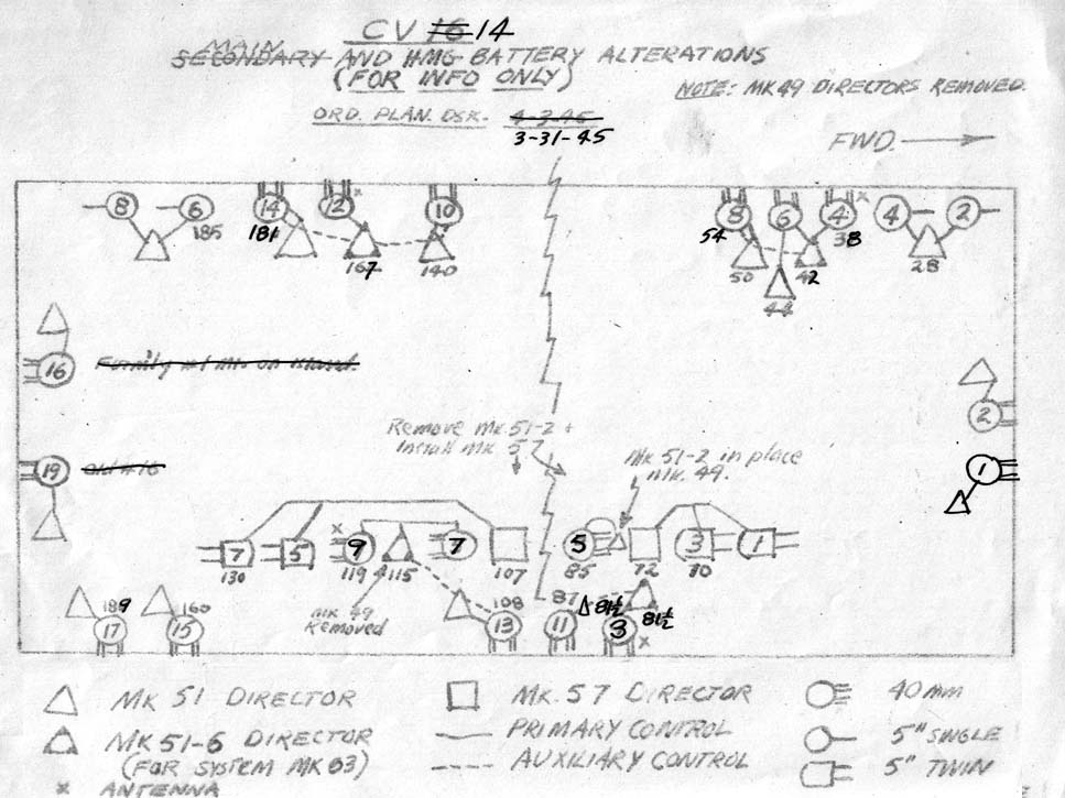

This is probably a question for Tracy. In looking over photos of the Ticonderoga and the Hancock I noticed they both have 2 MK-51 directors on the forward part of the island and on a pedestal mount between the #2 5" mount and the island structure, yet there is only one quad 40mm mount on the forward part of the island. You can see what I mean on the Randolph plan on page 56 & 57 of Essex Class Carriers by Alan Raven and on the photograph of the Ticonderoga on page 13 of the Warship Pictorial 22 - USS Ticonderoga CV/CVA/CVS-14 by Steve Wiper. Why 2 MK-51 directors for 1 40mm mount?
Erik
Erik
My ship build(s)
Tracy White
- Posts: 10632
- Location: EG48
Re: Calling all Essex Class Carrier Fans!
The Mk 51 on the island was for the forward island Quad.... the one on the pedastal behind the 5" mounts was actually for the 5" mounts. Attached is a sketch I found regarding the Mk63 system (essentially a Mk 51 with radar) that lays out Tico's directors following her Kamikaze damage repair & overhaul in early 1945:
