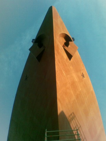

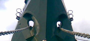

my tip for you....
1. You can bay only hull (build with original shipyard plans) for 300� (without delivery cost).
2. The plans for projekt 1155 you can find in internet.
3. And it is cheaper than set 1/100 Arkmodel Udaloy because ( if you will build a good model) you have to change a LOOOOOT of things....
Atom44

I doubt that it will be cheaper in the end. Most of the plastic I'm using to fix things are parts of the kit/frames. There is a lot of excess plastic to use with eventual fixing of things. If you add delivery cost with that $300 then you'll come already quite close to what you pay for a full arkmodel Udaloy included shipping cost.Hi Todd,
my tip for you....
Buying only the hull still leaves you with a lot of designing of parts etc. Plans on the net are not always reliable and only show the portside of the ship, the linesplan on the net is that from the Pavlov book on Udaloy and that is also what Arkmodel has used, not exactly correct to say the least.
If I'd have to choose, although sometimes a head ache, I'd still go for the Arkmodel Udaloy instead of starting one myself.
Thanks for the picture of those anchor chocks, like I've shown and said before, I don't intend to cut a hole in the hull to make this recessed anchor chock. I'll see what I can achieve with what I have. It'll be equally good and only Udaloy experts will see the difference. (and there aren't many around in Belgium after all, I think I count exactly 1

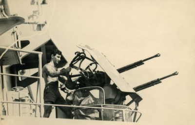

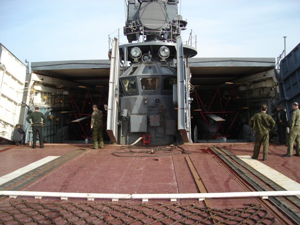

Thanks for the pics, I also have some close ups of those guns from the Concorde book on Udaloy/Slava/Sovremenny.
I'll have to build those myself too, but it will be a nice addition (if I can do it right).

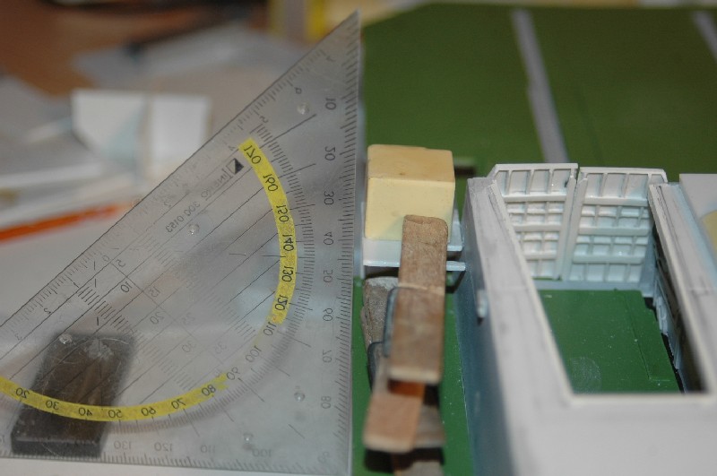

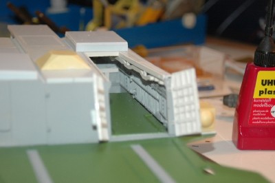

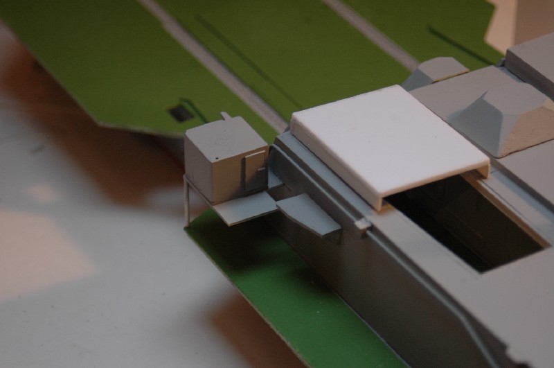

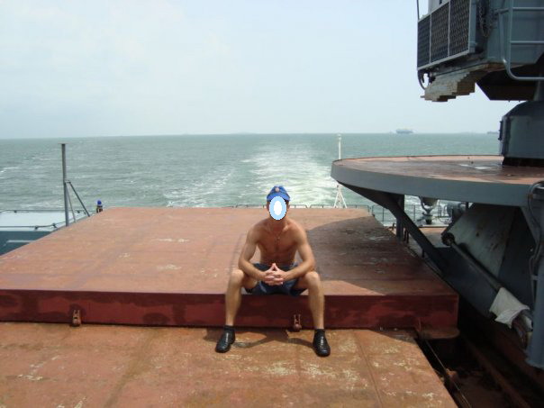

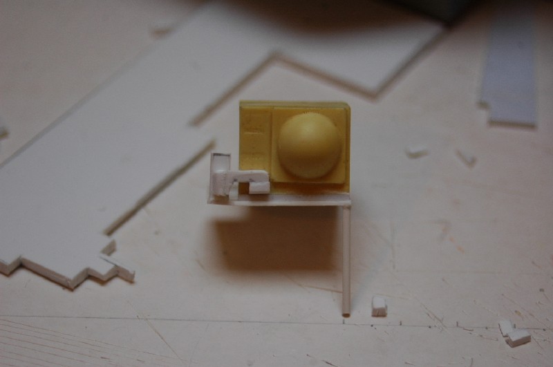

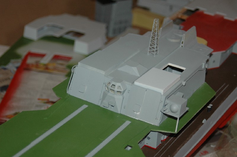

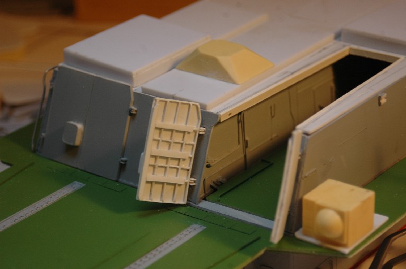

so I continued.
Here is the initial problem, the deck with the helo landing aid wasn't broad enough, in reality it stretches out to the sides of the deck, with the support nicely in the corner.
Of course you'd think I'd know better by now, but I decided to model the helo landing aid with the best pictures I had, one taken by Dave on Levchenko... Stupid me, afterwards I checked and of course, as you could already guess, the one on Tributs is different! So I removed the nice stuff from Levchenko version and just turned around one of the remaining parts to get something similar to Tributs's. In addition I put the last deck piece on the side of the hangar and attached the helo landing aid. The FLYCO is painted but only dry fitted, I think I'll wait untill the deck is marked before I really glue it in place.
I've also thought of a system to be able to open and close the hangar roof, yet keep it fixed on the hangar so that I don't loose the parts when I'm putting her on the water! That will follow later on. As you can see the doors of the hangar can be opened and closed, I'll make a small locking pin to keep them closed during water trials.
The merchant shipyard
- Neptune
- Posts: 2466
- Location: Belgium
Re: 1/100 Arkmodel Udaloy

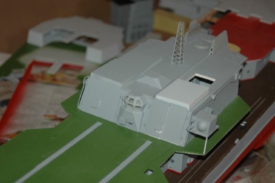

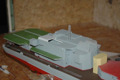

So here it is dry fitted in place. Next step will be spraying of the white parts along with development of the hangar roof.
