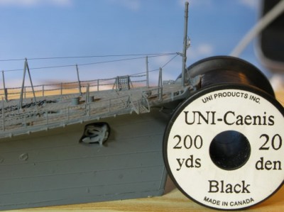

I added awning stanchions (from Gold Medal Models Gold PLUS Takao Details) and the corresponding line (Uni-Caenis 20 den).
Mogami184
Mogami184
Mogami185
Mogami185
The unit �den� or �denier� means the mass m in g per length of L=9000 m length. So this makes m/L=0.020kg/9000m. When the density ? of the fiber is known, it is possible to calculate the fiber radius with the equation r=?(1/???m/L). Assuming ?=1400 kg/m^3 this gives r=22.5�m. For a model scale 1/350 this gives a line diameter of approximately 16 mm in the real world. So I think, at least for 1/350 this should be close to reality. (I hope that my calculation is correct and the density assumption in the right order.)

Nice job with those steel baseplates and with the awning stanchions. Rigging on the latter looks very subtle.
The lamp with its cable on the jackstaff is another brilliant detail. :thumbs_up_1:
Thank you for the explanation about den thickness!

I decided not to use the monofilament thread I employed for my former models Tone and Chokai (1 in Mogami191). Instead I will do the complete rigging of Mogami with Uni-Caenis 20den (2 in Mogami191). To avoid disaster I will make this �invisible thread� more visible by adding tiny white isolators.

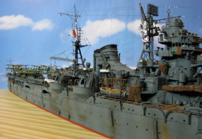

I am not sure if they were still there in 1944. I also don�t know what they are for (pipes for cooling water or part for holding the bulge? Can anybody help?). The following pictures demonstrate the weathering of the hull.

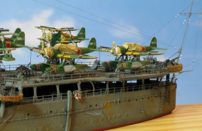

Posted: Fri Sep 24, 2010 6:50 pm
by Dirk
Thanks Dan for your comments and info. Very welcome. There is always something to learn.
I finished now the rigging using only the UNI-Caenis 20den with a diameter of 48.8 �m. Electron microscope pictures of this material are here:
viewtopic.php?f=2&t=59072
For the signal flags (Mogami197) I used now Teflon tape and hand painted it. My trials with masking the Teflon with Tamiya masking tape were not successful: The glue in the masking tape attacks the Teflon chemically.
Mogami197
Mogami197
The rigging is now very thin and I added a lot of white isolators to make the rigging visible to the naked eye.
Mogami198
Mogami198
Mogami199
Mogami199
Mogami200
Mogami200

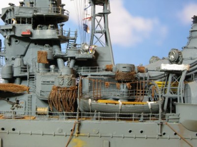

by Dirk
Thank you, gtbred and Marek! :wave_1:

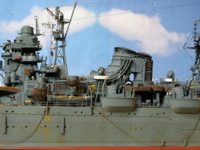

I continued to add ropes for splinter protection (Mogami205).
Mogami205
Mogami205

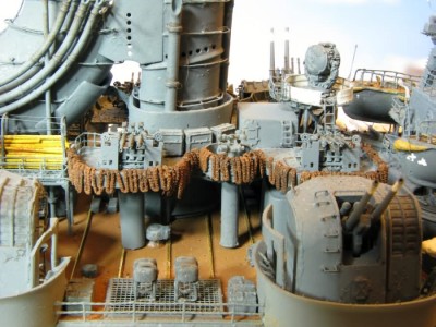

In this area I used real thread (Mogami206).
Mogami206
Mogami206
Here (Mogami207) I used PE ropes (Rb7009 rope) from Rainbow. (They are for scale 1/700. Maybe too coarse for that scale, but perfect for 1/350.)
