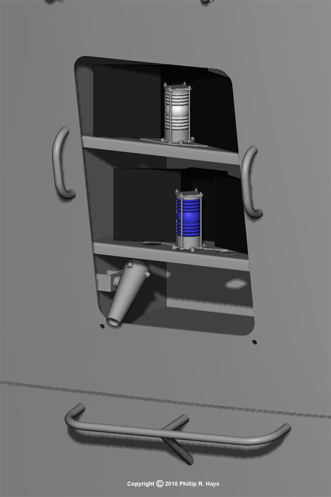

I suggest that you may have the hinge correct, but the stern light located incorrectly. When at sea, the stern light should be upright, so it provides proper visibility per the rules of the road.

The light on the flagstaff was the stern anchor light. It was a 360 degree white light. It was lighted only when the ship was anchored or moored.
The white stern light was located in a recess in the hull at the stern, along with a blue formation light and a wake light. The stern light was visible through an arc 67.5 degrees to either side of directly astern.

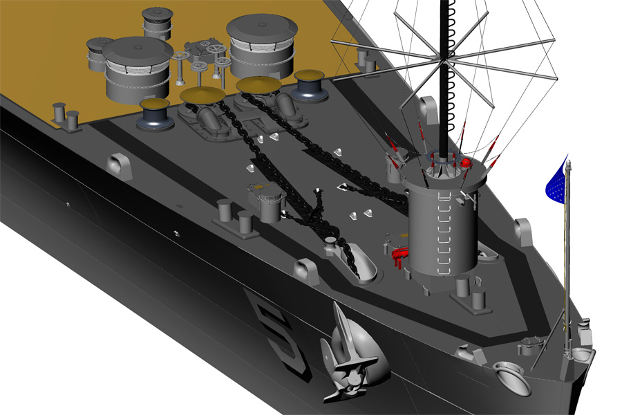

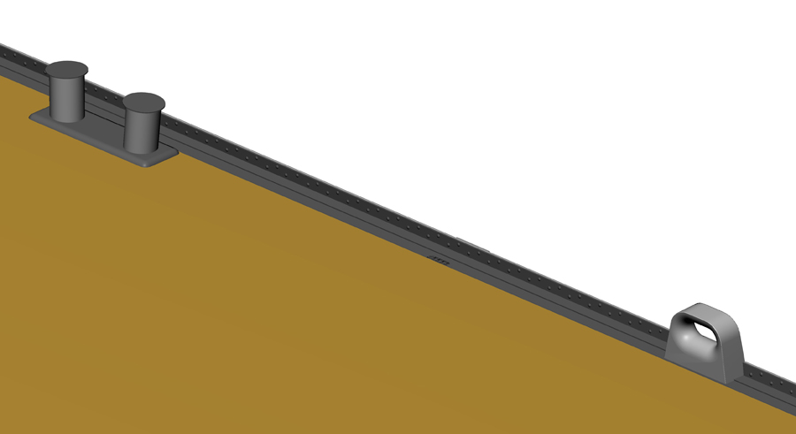

I have been working on several minor but tedious jobs to get the hull ready for the final finishing touches. There were several corrections and improvements to the focsle area, and I installed the angled flange at the edge of the main deck.
The flange was a bit of a challenge because it is a basic "L" shape but with a varying angle. At the bow the angle is obtuse (greater than 90 degrees) where the hull flares out at the top. Amidships the angle is acute (less than 90 degrees) because of the tumblehome of the ship's sides (the beam is wider at the waterline than at the main deck). And it is obtuse again farther aft. In addition, the flange curves around the edge of the main deck, and it follows the sheer and camber of the deck. This sort of thing is hard to model with CAD. Then there were hundreds of rivets fastening the flange to the hull plating (it was welded to the main deck).
Now there are three major projects left for the hull and main deck:
1. Life line stanchions. I have been studying blueprints and photos for a few weeks to make a list of types of stanchions and their locations. Unfortunately the CLG blueprints that tell where the stanchions were are extremely poor copies - large parts are solid black - and almost useless. To complicate matters further, even though some of the stanchions were the same as in the Clevelands during WWII, the blueprints are for the USS Cleveland CL-55 and the stanchion positions were rearranged by the time the USS Oklahoma City CL-91 was constructed. So even the Cleveland blueprints are mostly useless. I have been poring over photos to make a list of stanchion locations and types.
Of course the details changed a lot over time so it has been a challenge to determine what was where in July 1971.
2. Life nets around the helo deck at the stern. The blueprints for these are pretty good and I have many good photos.
3. The wood deck. I intend to model every plank as accurately as I can. The blueprints give general guidance here, but I will need to study photos to determine where the ends of the planks actually were. I already have a 2D deck plan showing the planks and margin boards. I will notch deck planks into the margin boards, and that will be a lot of simple but tedious work!
The deck planking for the 28 foot personnel boats taught me how to plank decks in CAD. There the planks were curved. All of the main deck planks were straight parallel to the ship's center line, but they still have to follow the camber and sheer of the deck.
Then the model will be nearly complete. I still need to rework the AN/SPS-30 antenna on the aft radar tower, and there are a few minor fixes I need to make on the after superstructure.

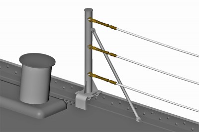

Just finished the main deck lifelines. It was quite a tedious chore.
I also discovered problems with the boat decks amidships and had to redraw part of them. Fortunately the original blueprints are very readable with complete dimensions.
Now on the the flight deck life nets!

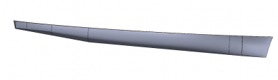

sure its not a real closeup due to the length but you can def see the knuckle in the rear and the nice transom ill get better later. I have abt 70 sheets from a Balao class sub I been wanting to do at 1/32 scale radio control that and a german type VIID but the offsets for the Balao over half are really illegible I guessed on some on the frame 70-137 sheet which wasnt too bead but the 1-70 sheet is just aweful. I want to do a radio control sub and like 1/6 scale Pibber MK II vietnam era patrol boat but couldnt find the pibber lines. it actually had come from a cabin cruiser hull originally and I was going to use waterjet motors on it like the original

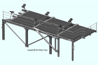

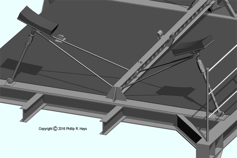

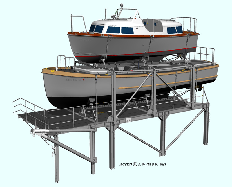

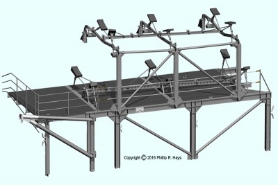

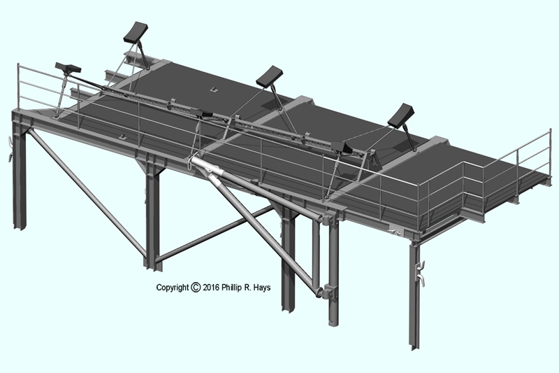

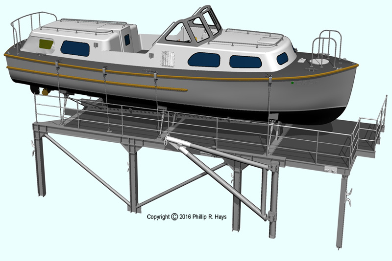

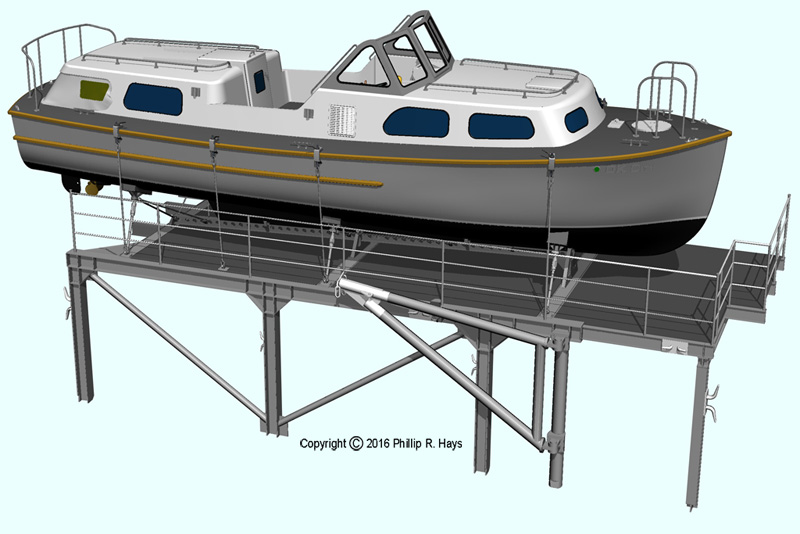

The ship had boat decks port and starboard at the midships deck house. I originally drew these a couple of years ago, but while I was mating them to the hull plating I discovered a few problems. Further examination of photos and the blueprints revealed even more problems (they had been modified quite a bit from the original construction). And then I realized that I had left out the diagonal supports for the boat rests. So what started as a simple job to allow me to finish the life lines and life rails on the main deck turned into a several day job.
I have attached images of the decks without the boats to show details of the boat rests, and then pictures with the boats lashed down for stowage. The last picture shows the details of the boat supports and the diagonal braces.

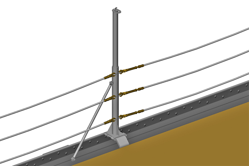

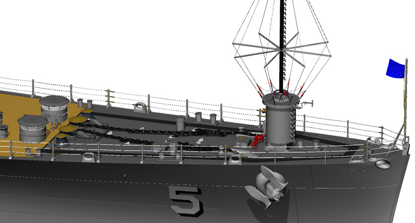

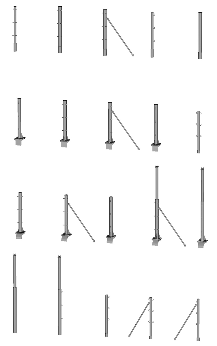

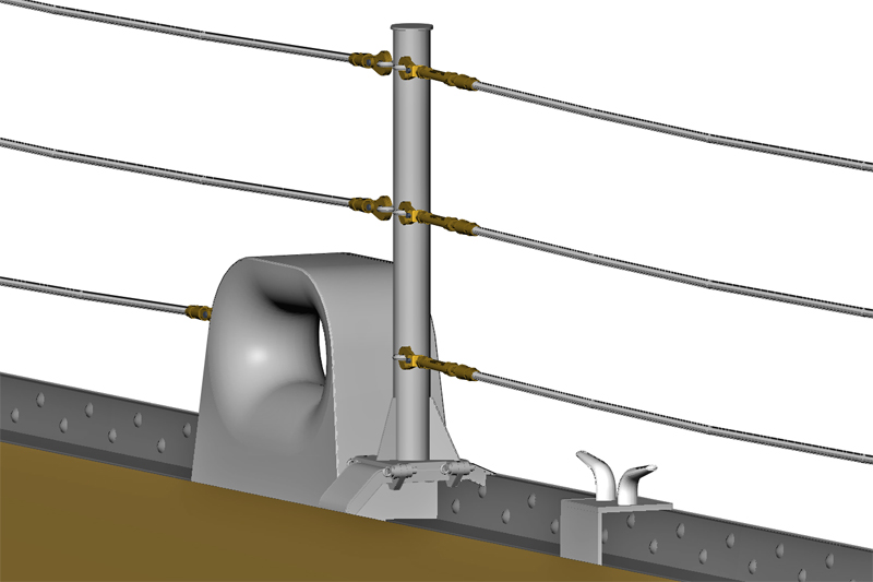

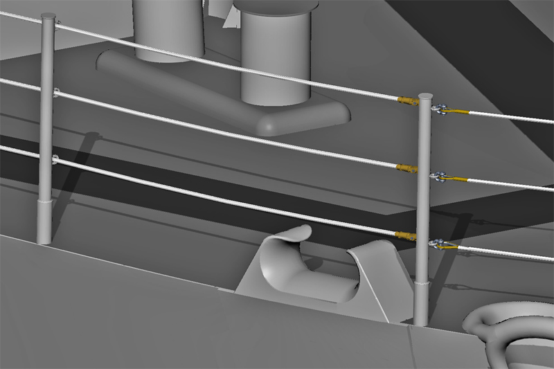

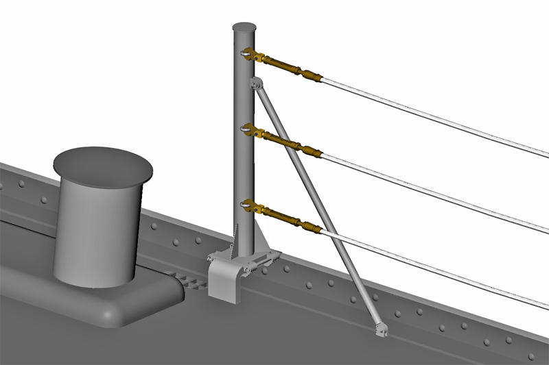

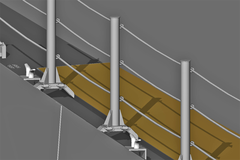

I finally finished the stanchions and life lines on the main deck! So how hard can that be? You just trim and glue some photoetch pieces in place, right?
Well, two months and 108 stanchions later it is done, with 20 different basic types of stanchions and several slight modifications (with some distractions fitting the boat decks to the hull). Some were either a simple tube welded to the deck or inserted into a larger pipe section that was welded to the deck. Most were a more complex assembly designed to fold down by removing a pin on one side of the base and hinging on pins on the other side. This would lower the lifelines, presumably for UNREPS transfers or whatever. In practice all of the pins were removed and the entire upper part of the stanchion was removed, along with the lifelines.
No two of these were exactly alike. They spanned a 15" waterway at the side of the deck, with the inboard end welded to a flat bar at the edge of the wooden deck. The outer end was custom fitted at each position to the upper edge of the hull plating and an "L" flange between the main deck plating and the hull plating. The height of the hull plating varied along the length of the ship. That is what took so long to draw! Forward and aft of the wooden deck there was no waterway and the stanchions were welded to the deck on the inboard end. Some of the stanchions had an upper extension to support a cable. In port canvas awnings were strung between the cable and bars (jack rods) welded to the sides of the deck houses. On the forward part of the ship these extensions were removed at sea to protect them from waves coming over the bow. But the midship stanchion extensions were in place most of the time. The stanchions add a nice finishing detail to the main deck. Now on to the life nets at the sides of the flight deck!

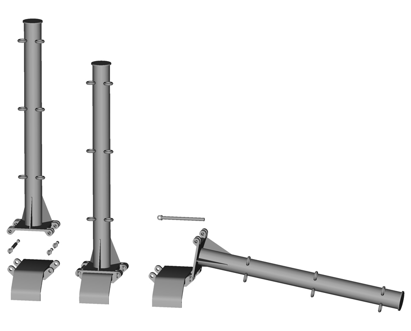

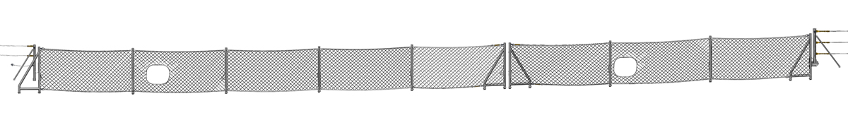

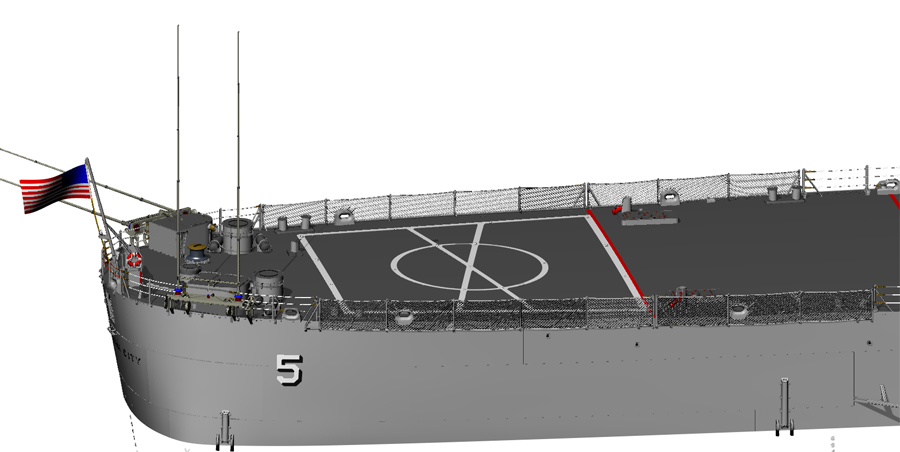

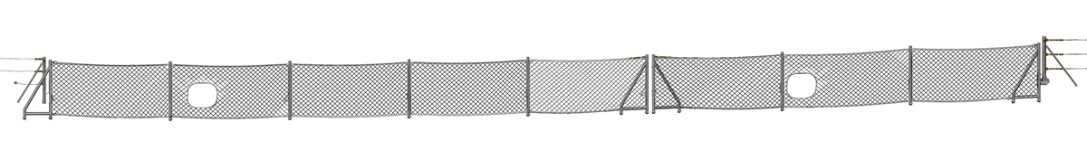

The flight deck life nets are done!
When I started this project I thought if I had the blueprints all I would have to do is model what was shown in the drawings. However, it wasn't that simple.
I have the blueprints for the life nets on "CLG TALOS" (USS Little Rock CLG-4 and USS Oklahoma City CLG-5). They show one section of nets with six parts. But when I looked at the OK City pictures I saw two sections with eight parts - one with three nets and the other with five nets (see the attached pictures). Well, after years of working with the drawings I wasn't surprised. The OK City was modified a lot over the years!
Looking at photos of the ship throughout her career it appears that the original CLG (1960) had one five net section, starting at the forward end where the blueprints showed the forward end of the six net section, but with the sixth net missing at the aft end. The ship still had only the one five net section in June 1967, but by April 1970 an additional three net section was installed forward of the five net section. Existing life line stanchions were removed where the new net section was installed.
The Little Rock does appear to have six net sections where the blueprints show them, but they weren't constructed like the blueprints show them! So much for blueprints! You really have to study photos to see that they actually built.
It often takes longer to study the photos and determine what was actually on the ship than it does to model it.

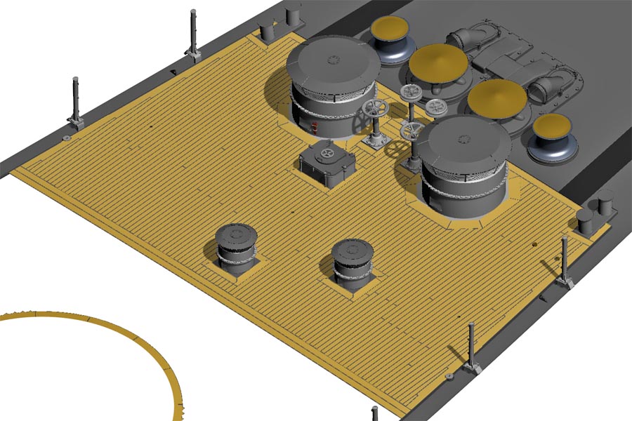

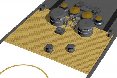

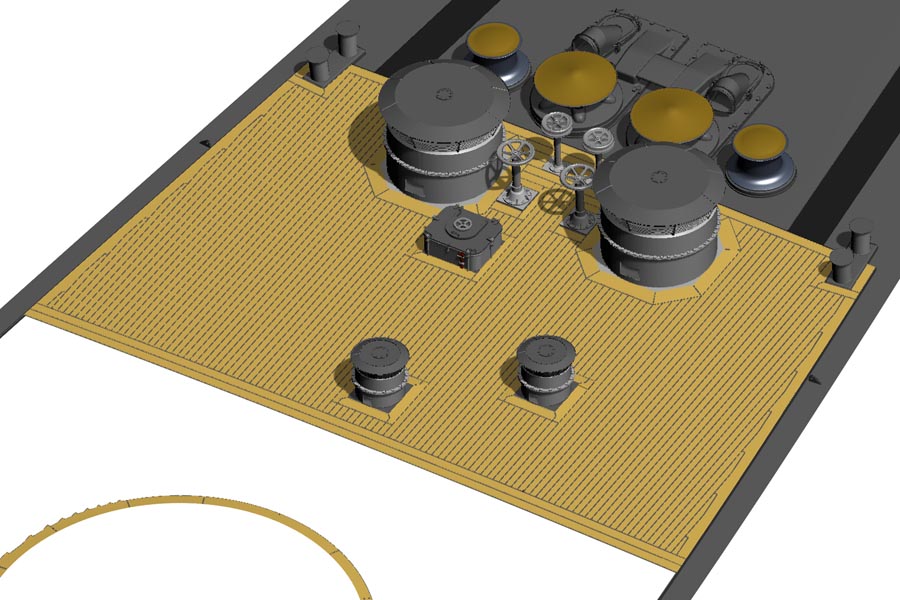

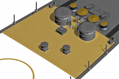

I have started work on the wooden deck. The image shows the forward part of the deck. This was added during the CLG conversion between Frame 18 1/2 and Frame 23. The original Cleveland class wood deck extended forward only to Frame 23.
The planks were 2" thick by 4" wide. The blueprints call for a 1"x4" teak board to be laminated on a 1"x4" Douglas fir board to form the planks. The Margin boards were a minimum of 6" wide and a maximum of 9" wide. They were 2" thick where the board joined a deck plank, and 2 1/2" thick along edges that butted against deck house sides. This caused water to run away from the metal house sides. There was a 3/16" wide caulking between planks, margin boards and house sides.
Where an angle at the end of a plank was less than 45 degrees the point (nib) was cut back to where the plank was at least 2" wide, and this board was fitted into a notch in the margin board.
There were three different configurations of this part of the wood deck in the CLGs. Two did not have the added forward part of the wooden deck and just the original Cleveland class bare metal deck. Two had only part of what is shown here on the outboard sides and bare metal deck in the center. And two had the full wooden deck extension shown here. And, of course, no two were exactly alike!
This was the most complex part of the wood deck. The margin boards around the vents, hatch and winch/capstan controls were pretty complex. Adding to the difficulty was the raised edges of the margin boards close to the vents and hatches. Further complexity came from the fact that the main deck was hyperbolic - saddle shaped. It was curved from side to side, with the high part in the center. This camber helped prevent water from standing on the deck. In addition, the deck had sheer and was higher at the bow and stern than at midships - a broad "U" shape when viewed from the side. All of the deck planking and caulking has to be fitted to this saddle shape and around the margin boards.
Here is a bit of Cleveland class trivia. The bitts shown here at the forward corners of the wooden deck were unique to the USS Oklahoma City CLG-5. None of the other Cleveland class ships or CLG conversions had them, so they are an easy recognition feature for the OK City. They are also odd in that they appear to be 10" bitts like those used on destroyers. All the other bitts on the ship were 14" (on all Cleveland class ships). It appears they were added during the CLG conversion. I guess the Chief Bosun's Mate wanted more bitts and they used whatever was available in the shipyard.
Still a LOT more to go, one plank at a time.

Further!
Many times during this project I have completed the design of one part only to discover that I had made mistakes when I moved on to the next part. This is why I am determined to finish the CAD model before proceeding further on the 1:96 real model. Otherwise I might spend a lot of time, materials and money only to discover that what I had already built would have to be scrapped.
In this case, while I was working on details of the wood deck I discovered that some of the lifeline stanchions were in the wrong positions - and this was after weeks of studying blueprints and photos to try to get it "perfect." Foolish idea! So I went back and verified the positions of all the stanchions and moved those that were out of place. I hope they are right now.
And then, while studying the photos I realized that I had made a mistake in fitting the deck planks into the margin boards. It is actually a bit simpler than I first drew. The attached picture shows the new boards and the positions of some of the lifeline stanchions that were moved.
Further!
