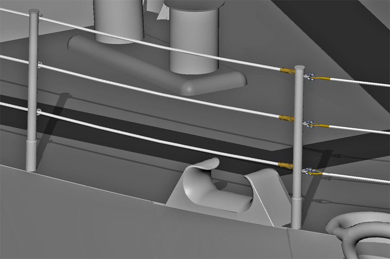

I finally finished the stanchions and life lines on the main deck! So how hard can that be? You just trim and glue some photoetch pieces in place, right?
Well, two months and 108 stanchions later it is done, with 20 different basic types of stanchions and several slight modifications (with some distractions fitting the boat decks to the hull).
Some were either a simple tube welded to the deck or inserted into a larger pipe section that was welded to the deck.
Most were a more complex assembly designed to fold down by removing a pin on one side of the base and hinging on pins on the other side.
This would lower the lifelines, presumably for UNREPS transfers or whatever. In practice all of the pins were removed and the entire upper part of the stanchion was removed, along with the lifelines.
No two of these were exactly alike. They spanned a 15" waterway at the side of the deck, with the inboard end welded to a flat bar at the edge of the wooden deck. The outer end was custom fitted at each position to the upper edge of the hull plating and an "L" flange between the main deck plating and the hull plating. The height of the hull plating varied along the length of the ship. That is what took so long to draw!
Forward and aft of the wooden deck there was no waterway and the stanchions were welded to the deck on the inboard end.
Some of the stanchions had an upper extension to support a cable. In port canvas awnings were strung between the cable and bars (jack rods) welded to the sides of the deck houses. On the forward part of the ship these extensions were removed at sea to protect them from waves coming over the bow. But the midship stanchion extensions were in place most of the time.
The stanchions add a nice finishing detail to the main deck.

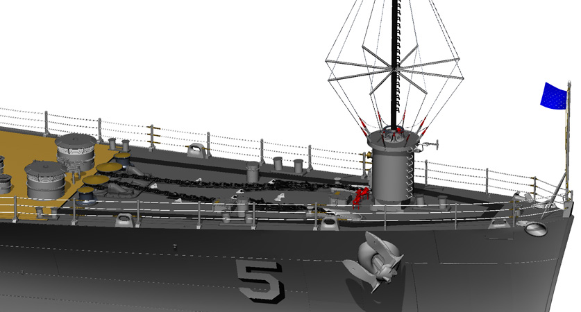

I have started work on the wooden deck. The image shows the forward part of the deck. This was added during the CLG conversion between Frame 18 1/2 and Frame 23. The original Cleveland class wood deck extended forward only to Frame 23.
The planks were 2" thick by 4" wide. The blueprints call for a 1"x4" teak board to be laminated on a 1"x4" Douglas fir board to form the planks. The Margin boards were a minimum of 6" wide and a maximum of 9" wide. They were 2" thick where the board joined a deck plank, and 2 1/2" thick along edges that butted against deck house sides. This caused water to run away from the metal house sides. There was a 3/16" wide caulking between planks, margin boards and house sides.
Where an angle at the end of a plank was less than 45 degrees the point (nib) was cut back to where the plank was at least 2" wide, and this board was fitted into a notch in the margin board.
There were three different configurations of this part of the wood deck in the CLGs. Two did not have the added forward part of the wooden deck and just the original Cleveland class bare metal deck. Two had only part of what is shown here on the outboard sides and bare metal deck in the center. And two had the full wooden deck extension shown here. And, of course, no two were exactly alike!
This was the most complex part of the wood deck. The margin boards around the vents, hatch and winch/capstan controls were pretty complex. Adding to the difficulty was the raised edges of the margin boards close to the vents and hatches. Further complexity came from the fact that the main deck was hyperbolic - saddle shaped. It was curved from side to side, with the high part in the center. This camber helped prevent water from standing on the deck. In addition, the deck had sheer and was higher at the bow and stern than at midships - a broad "U" shape when viewed from the side. All of the deck planking and caulking has to be fitted to this saddle shape and around the margin boards.
Here is a bit of Cleveland class trivia. The bitts shown here at the forward corners of the wooden deck were unique to the USS Oklahoma City CLG-5. None of the other Cleveland class ships or CLG conversions had them, so they are an easy recognition feature for the OK City. They are also odd in that they appear to be 10" bitts like those used on destroyers. All the other bitts on the ship were 14" (on all Cleveland class ships). It appears they were added during the CLG conversion. I guess the Chief Bosun's Mate wanted more bitts and they used whatever was available in the shipyard.
Still a LOT more to go, one plank at a time.
