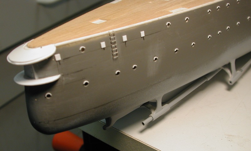

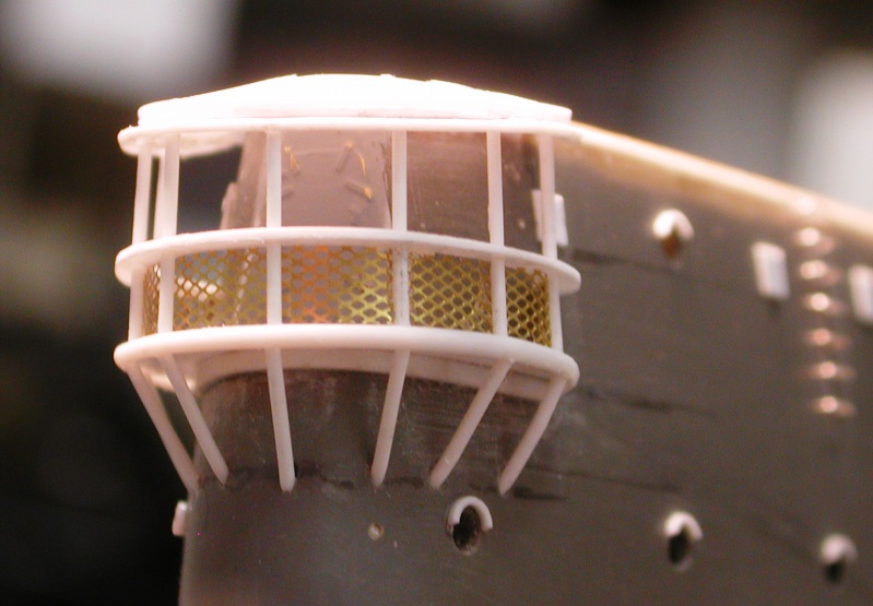

After some mental wrangling I decided that the next thing to be done is to bring the hull up to a further level of completion. The hull is a manufactured laid-up fiberglass item that I purchased from a British outfit called Midway Models about fifteen years ago. It is very good dimensionally and shape-wise and has a nice rendition of the bow knuckle. The finish of the hull is smooth grey gelcoat with no detail molded in at all. I had already made and attached the shafts and struts, bilge keels and rudder post. I had also marked and drilled the port holes, then backed them with strips of sheet plastic glued to the inside of the hull, attached the sheet plastic subdeck and installed the hawse pipes. Finally I had installed the finished wood deck and sealed it. This was all covered in previous posts.
Lurking in the back of my mind was the knowledge that, in spite of the large amount of work that had already been done, there was still a lot to do before the hull was complete. I also realized that the hull needs to be basically complete before anything substantial, like superstructure components, can been permanently attached to it. There are three major areas of the hull yet to be finished:
1. The portholes
2. The stern gallery
3. The hull plating
4. Painting

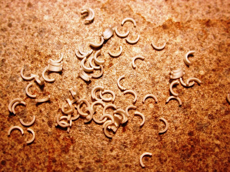

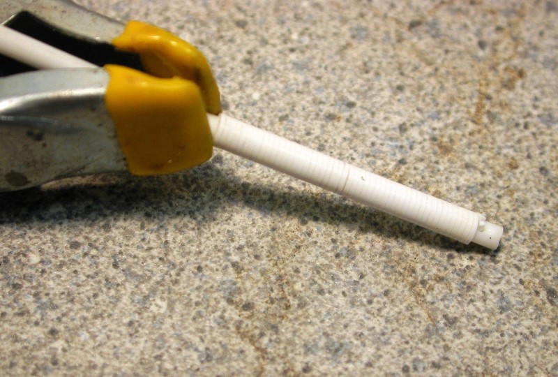

The main porthole issue was the rigols, the semicircular rain gutters above each one that is exposed to rain. I had originally not intended to model the rigols. They are small, even in 1/192 scale, not always obvious in ship photos depending on the light, and (perhaps most critical) I did not know of a good way to make them. While working on the superstructure, however, I thought of a way they might be made. It worked fairly well and I started added them to the portholes on the superstructure. But the number of portholes in the superstructure was nothing compared to the number in the hull � there must be several hundred (I don�t want to count them).
The method for making the rigols is quite simple. A small hole is drilled into the end of a plastic rod the same diameter as, or slightly larger than, the porthole. The end of a strip of .010x.015 plastic strip is inserted into the hole and the strip is then wrapped around the rod in a tightly wound spiral. The bottom end is held in place by a small clamp. The rod is then placed in a container of nearly boiling water and allowed to stay there until the water cools. Then using a sharp scalpel two cuts, 180 degrees apart, are carefully made up each side of the spiral. The result is a fair number of rigols, ready to be grasped by a pair of needle-nosed tweezers and one by one, cyanoed to the hull above each porthole. I started installing the rigols at the stern. Also shown are the rectangular shutters for the windows in the admiral's day and dining cabins and ladder rungs which occur at the bow and stern. The rungs are made in a similar way to the rigols using thin wire wrapped around a square plastic strip and then cut down both sides with a knife. They are then glued into drilled holes. One of the reasons I chose to model Dorsetshire was that, of the County Class, only she and Norfolk had sternwalks. This would, I thought, add a bit of interest and uniqueness to the model. I may regret that decision as I have come to find that the sternwalk is a rather geometrically complex and difficult to build little item. I have made a start on the sternwalk�s construction. The deck has been attached to the hull and the curved sloping canopy has been temporarily attached by two small metal pins. Still to be made and attached are stanchions/posts which extend from the deck to the canopy, handrailing, railing grillwork, and triangular braces under the deck the hull. One mystery that was solved when I got the as-fitted drawings from the NMM was the location of the door to the sternwalk, which was at the extreme point of the stern.
1. The portholes
3. The hull plating
4. Painting

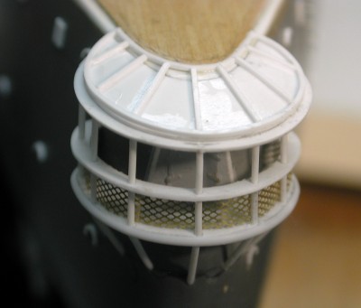

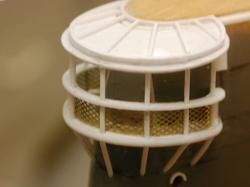

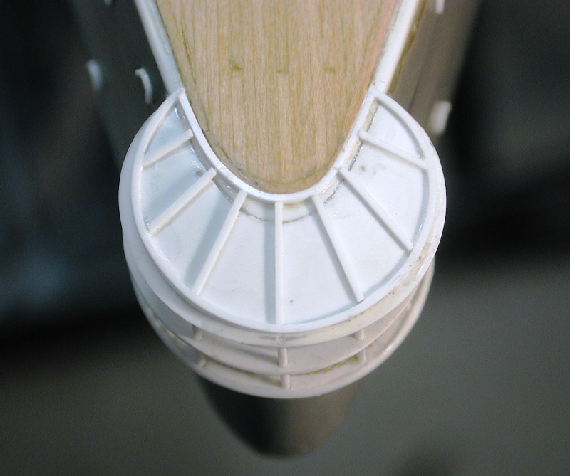

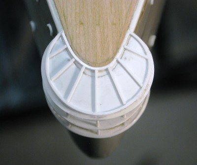

Here are some more progress shots of the sternwalk. It still needs a little work and cleanup, but is basically complete. The framing and railing is probably a little heavy, but the extreme closeup shots tend to emphasize it and I think it will be fine when viewed from a little more distance. The grill work in the railing is some railroad photoetch that is not exactly what was there but I think is fairly close.
Unfortunately I could not build it to be removeable, so when I spray paint the hull I will have to try to get some paint coverage inside while not gunking up the outside with too much paint.

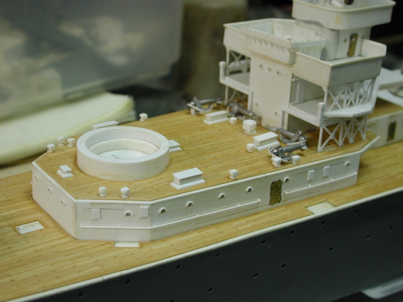

In the first post of the build fourteen months ago I described how I built a main gun turret that I hoped to be able to use as a master for casting at least three more for use on the model.
Building the turret was actually the first thing I did on the model, and as I have built more and more of the various components I have periodically put everything together, just to get an idea of what the completed ship would eventually look like. Wherever I did that, having only one turret to put in place would dilute the effect considerably, so I finally decided that it was time to either cast more turrets from the first or, if for some reason that did not work out, build three more.
First, let me say that I had never attempted casting anything from resin before and I was amazed at how easy it was and how good the results were. Having this ability opens up lots of new horizons for the modeler and I have already started using it to cast some other things, including a spare tire and wheel for a car model (OT, I know).
I won�t go into a lot of detail about what I did as casting techniques have been written about by people far more knowledgeable on the subject than I. Briefly, prior to making the mold I added a plate slightly smaller than the bottom of the turret so the bottom of the turret would not be the top of the pour.
Then I attached some scrap plastic to the plate to hold the master suspended above the bottom of the mold. I used a plastic parts drawer divided in half to contain the mold.
The two-part RTV mold material was mixed, poured into the parts drawer around the master and allowed to set. I think I over-reached a bit by trying to cast the range finder lugs with the turret in a one piece mold and the rubeer mold tore slightly when I removed the master. The tear closed up once the master was out, however, and was never visible in any of the castings I made from it.
I was able to easily cast four turrets and even though both the range finder lugs and bases of the gun barrels were not useable because of air bubbles. The photos below show the progression from out of the mold to finished turret.
The unuseable range finders and gun bases were cut from the casting and the blast bags re-drilled to accept new gun bases.
New range finders are made and attached, new gun bases fabricated from tubing and the barrels added. Minor imperfections are filled with Mr Surfacer and the turret is painted and ready for the model.
