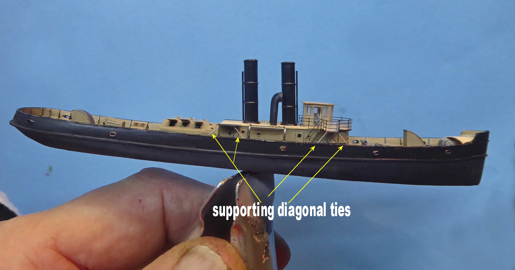

The funnels ( slightly over 27 mm high) were made of copper tubing, chamfered off to angle .
These were furnished with fine wire rings that were a snug fit on the funnel tube
( surprisingly fiddly to make ! )
So as to enhance the funnel mouth rim flare as well as the rings which will take the funnel stays.

I had some suitable to use/ modify resin cowl vents--( that saved some time )
I ground out the mouths to get more depth, and drilled the vertical shaft as well
To achieve the impression of a flared mouth and the lip thereto I added some rings of wire
These were then backfilled with very much thinned white glue which once dries created the ' flare ' of the cowl
The good news is that I have also managed to paint all the superstructure parts, the funnel and the vents
so now begins the more amusing and engaging part
==> actually building the model!!
