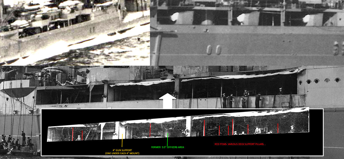

Photographs are very rare, however, these were placed to support the cradles for the boats. If I had to take a guess, I'd take the layout of HMS Hood after her refit with the enlarged boatdeck, get the cradle positions, put two poles beneath the edges of the cradles. I added a few "on good feeling" and a few drawings...Pontosmodel wrote:Anyway we need some information of many poles inner deck between main deck and the 1st structure.

Kim,
The main problem with determining the exact number and position of all the pillars supporting the boat deck is that the official plans only cover up to 1937 in detail. We also have decent photos of the side batteries showing various pillars. So, we have a good idea what the two areas looked like up until that point.
From 1938 onward, its not so clear.
In late 37/early 1938, the boat deck was greatly extended and covered both side batteries. There were also changes in guns and additional splinter shield work from 1939 to 1940. As a result, they would almost certainly had to have added MORE pillars under the decks. We don't know if they removed any of the originals (I wouldn't assume so....seems logical for them to remain in place), and we also dont know exactly how many new ones were added.
You can see some of the new support pillars in photos from 1940 and 1941. You cant see every detail though (because the area is generally dark/in shade. I've attached an image collage to show what I mean.
So, I think that Evert-Jan's model photo shows many of the pillars, but that we would actually need to add a few more.

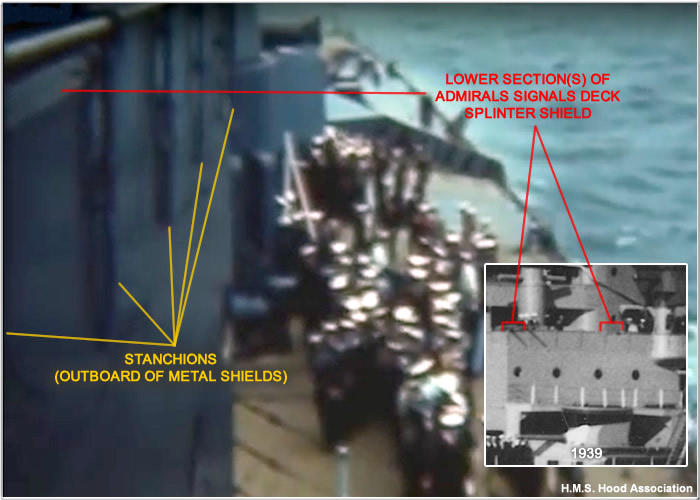

First up, is a minor/slight change to the shield and "rails" around the lower bridge (part L2). The kit is missing two depressions/lower sections of splinter shield on each side. There were two such areas to port and two such areas to starboard. These areas had been there for many years, and corresponded to where saluting cannons were once mounted. The depressions were never removed, but in 1939, when the deck was expanded aft (and outward), a railing like feature was added outboard of the shield. As a result, the rail was higher than the depressed sections. It looks a bit odd in some photos.
This is an easy fix for modellers: they can simply file down the four areas and replace the "rail" with thin wire or thin round plastic strip. Of course, you may wish to simply replace the whole shield with photoetch, or, provide the "rail" portion in photoetch. Here's a photo to show what I mean:
You can also see the depressed areas in the next photo: Lastly, a photo showing the same features on the builders model and the ship in 1923/24. It also includes some insets from 1940. We will have some more inputs shortly...more substantive/important ones!
I have some new details that I'd like to provide.

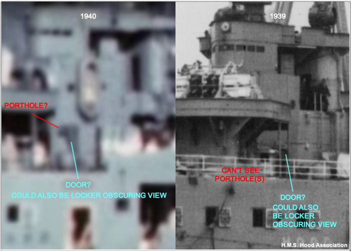

We've discovered that there were very likely changes made to Hood's rear superstructure (the "After Concentration Position/Searchlight Control Position") circa 1937. This corresponds to kit part N2.
When built, there were a series of windows which surrounded the lower rear edges of the structure. These were usually covered over with canvas...sometimes individually, sometimes with a long sheet. We see this canvas in photos up to 1936/37...but it in later photos, the area looks "smooth". We've found photos that show that the square windows appear to be gone...in there place there appears to be a couple of round port holes and maybe a door (port and starboard) and nothing to the rear. So, you want to consider modifying your photoetch for this area. Perhaps it could be modified to show some portholes, but for those who choose to think the square windows were still there, some small squares could be included and individually added?
Please see the following photos for details:

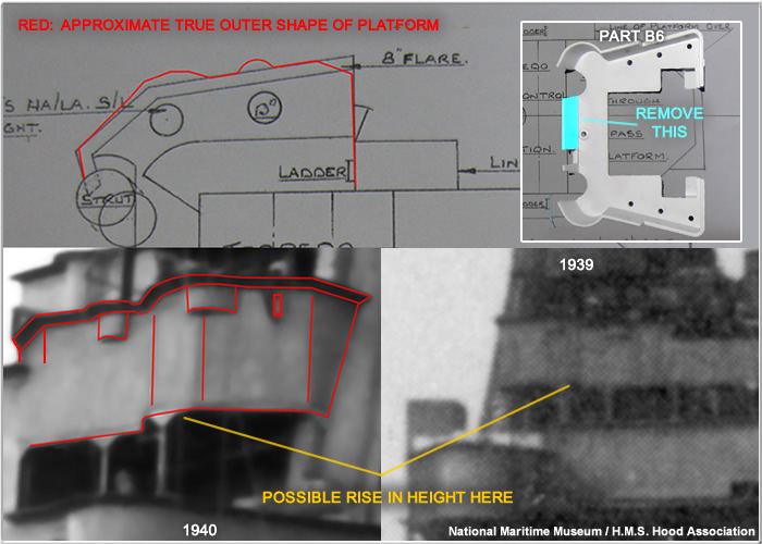

We have one last suggestion/correction for the photoetch: If you recall, we showed you copies of the plans for Hood's Torpedo Control Platform (the rear portion of part B6) a few months ago. You created a piece of photoetch to match those plans. The problem is, after closer review of numerous photos and films, we are confident that the actual plans are incorrect. Well, "incomplete" or "lacking" would be better terms; the plans do capture the general shape, but they fail to capture some of the undulations and projections that were present on the actual ship. If you look at the image below, you will see that it wasn't a straight angled wall (like the plans), nor was it a rounded corner (like on part B6). It was something between the two; There were some projections here and there combined with rounded and straight areas. It MAY have even risen slightly in height (though that could be an optical illusion). Please take a look and let us know what you think.
