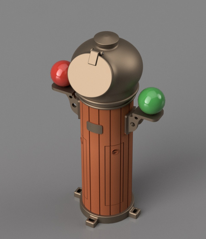

Drawing of the "upside down tureen" of the rear emergency compass. :)
Pascal

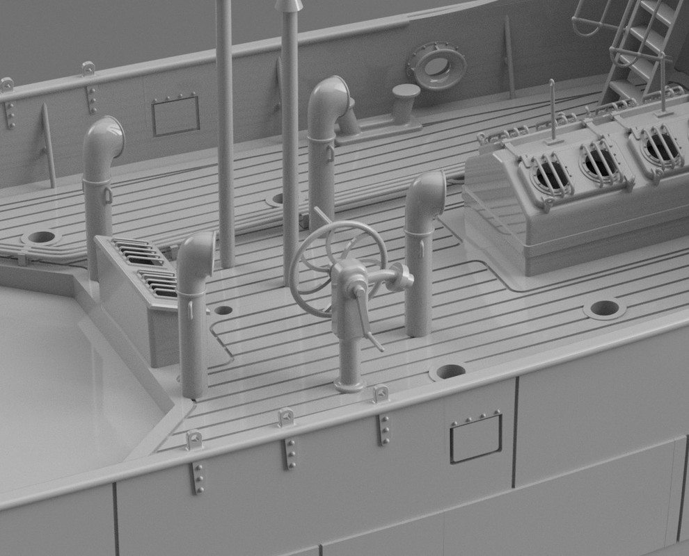

Post by Iceman 29 »

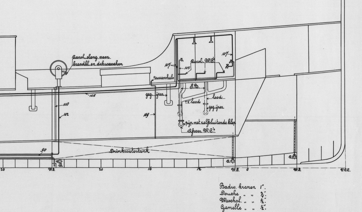

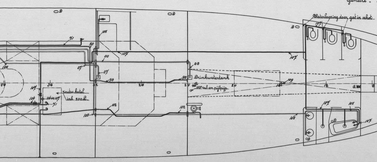

Drawing of the manual fire pump on the foredeck, it was also used to wash the deck (Washing horse, french expression..).
I finally found what it was thanks to the plan. I don't have the exact shape, so I interpreted a bit.
Seawater and fresh water circuits:
Pascal

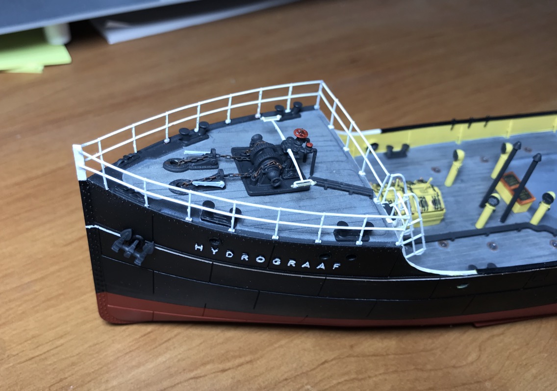

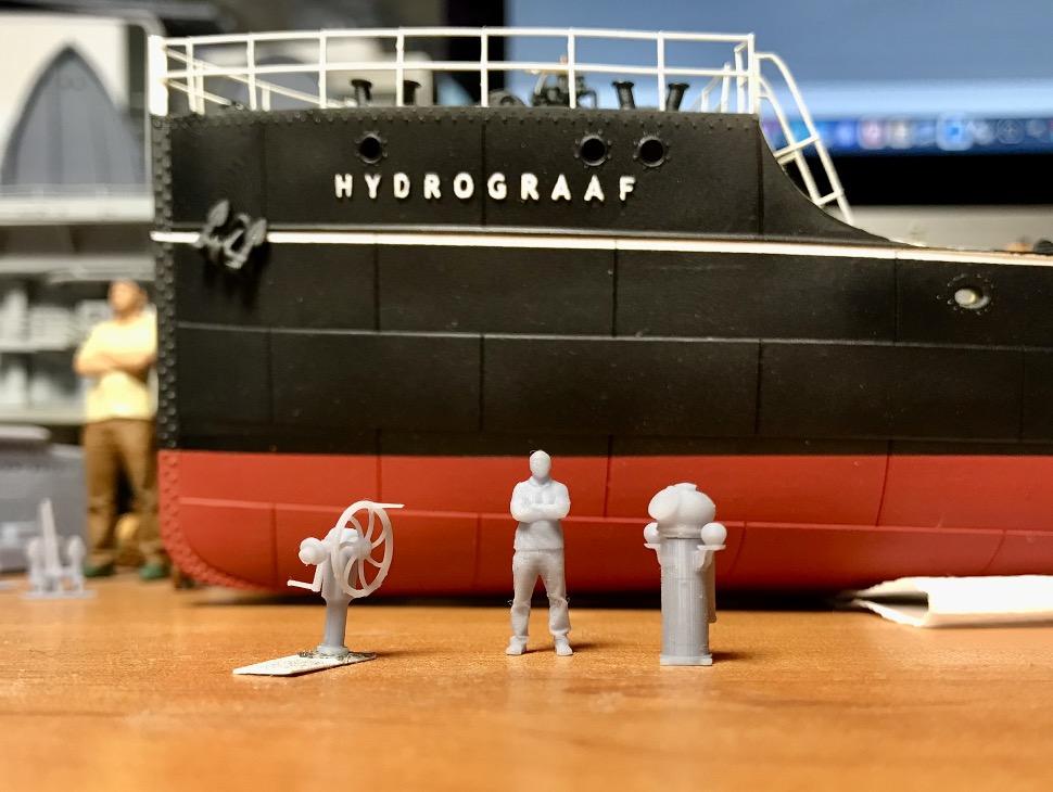

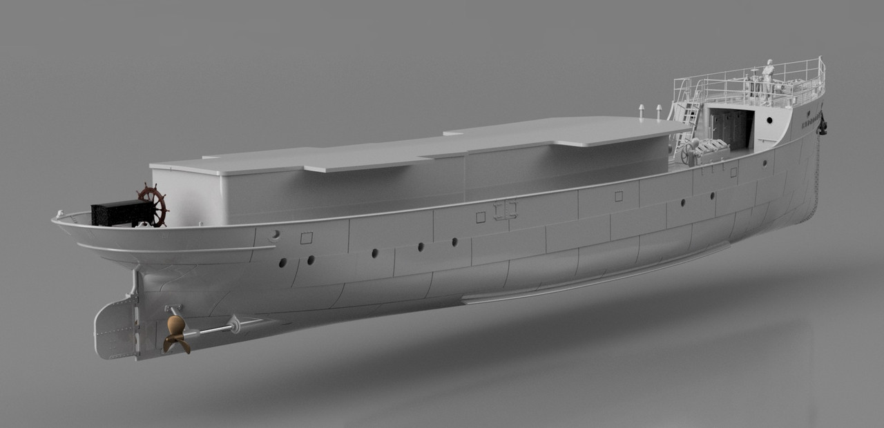

I have just printed the fire pump and the back-up compass.

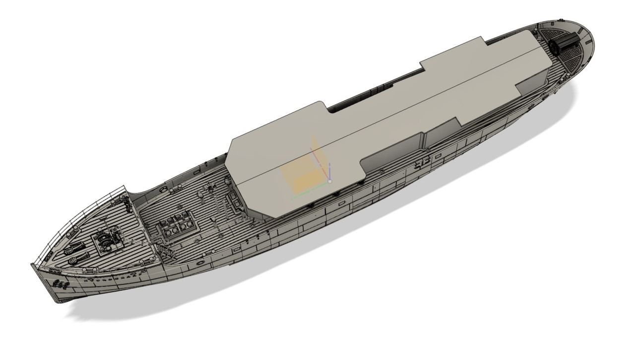

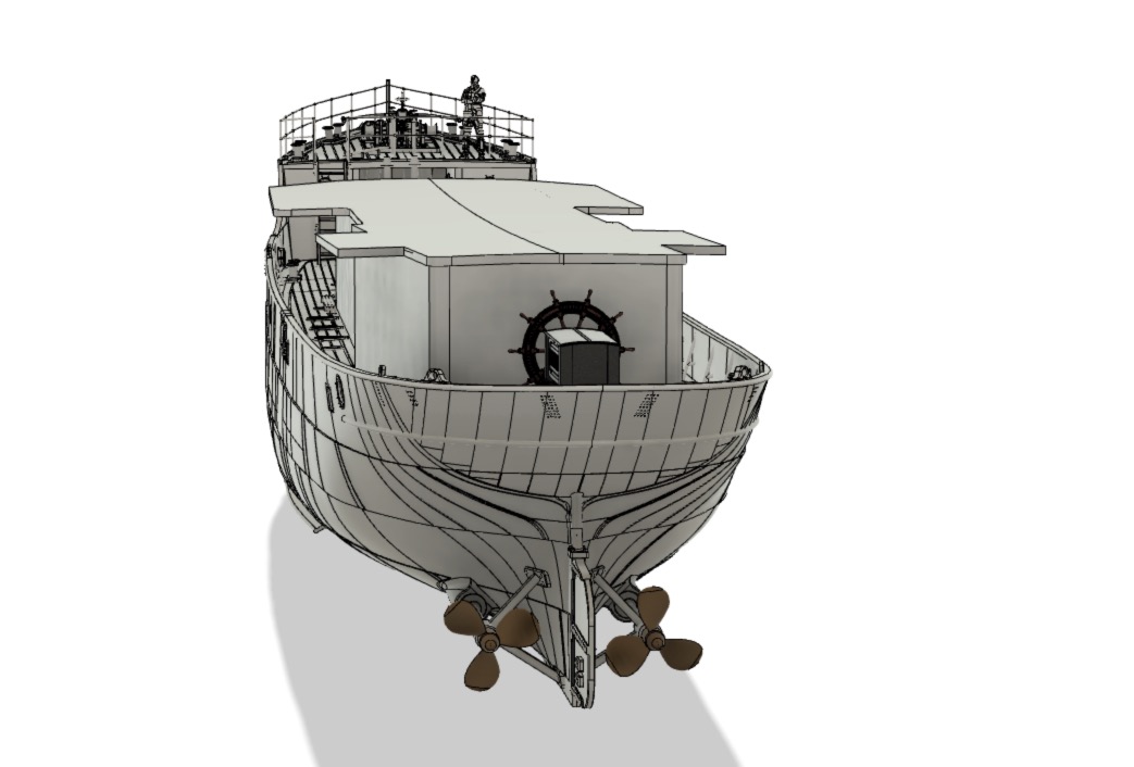

I started the drawing of the poop deck.
It's a new way for me: I finish the physical hull and I start the drawing of the boat.
There's a good reason for this: to assemble the half-hulls, I have to sand the two sides that are glued together, and of course the castle housing in the main deck may have shortened longitudinally.
I have to measure this new length on the model, adapting the length of the boat drawing so that the fitting is perfect. I will even make a printout of the lower castle sketch to make sure it fits perfectly, I also have to take into account that the printer will make this piece 0.3 mm larger in all 3 dimensions, I reduce the castle walls accordingly, a headache that deserves some time.
The sketch of the poop deck, the camber and sheer in sight!�
The fire pump and compass.
Pascal

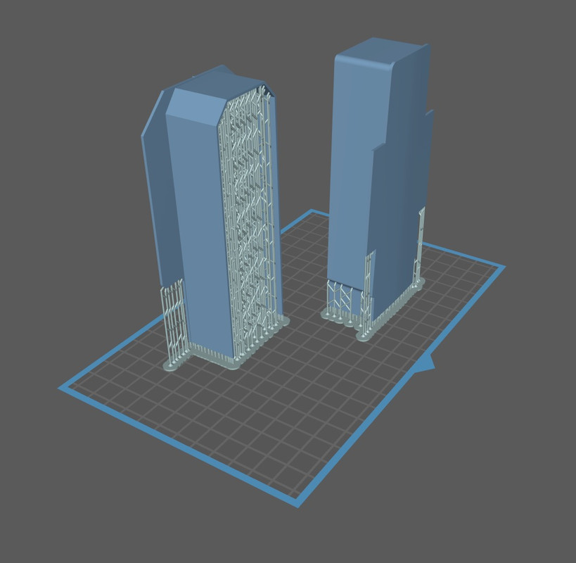

Back after a few days of vacations under the sun. :cool_2:

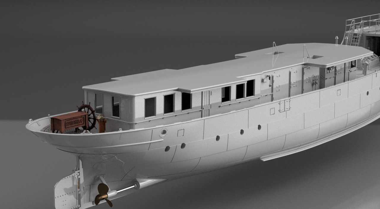

Today, I made some progress on the design of the castle, I also printed the base of the castle to test the real dimensions to know how much to remove in length for its final printing when the design will be finished.
For the widths, it's perfect anyway. I had removed 0.3 mm on the design on each side. It fits perfectly.
The test piece printed today. I use it as a template.

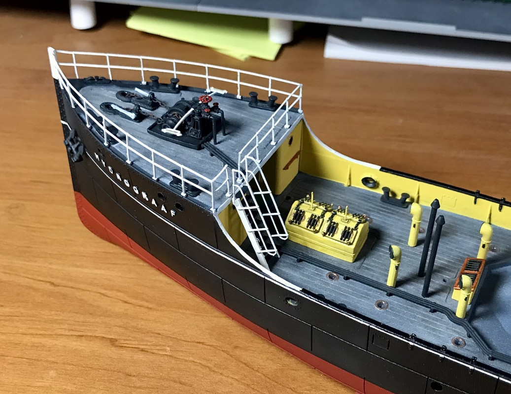

Pascal
Posts: 5068
Re: SS Hydrograaf, 1/100 3D, hydrographic ship, Royal Dutch
Post by Fliger747 »
The plethora of small supports reminds me of a raft of dried Ramen Noodles! Hydrograaf is coming out quite nicely!

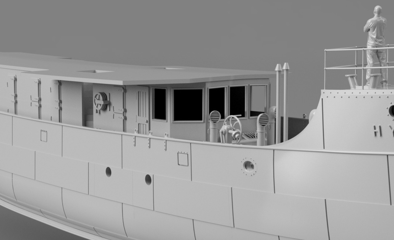

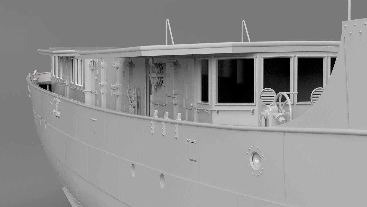

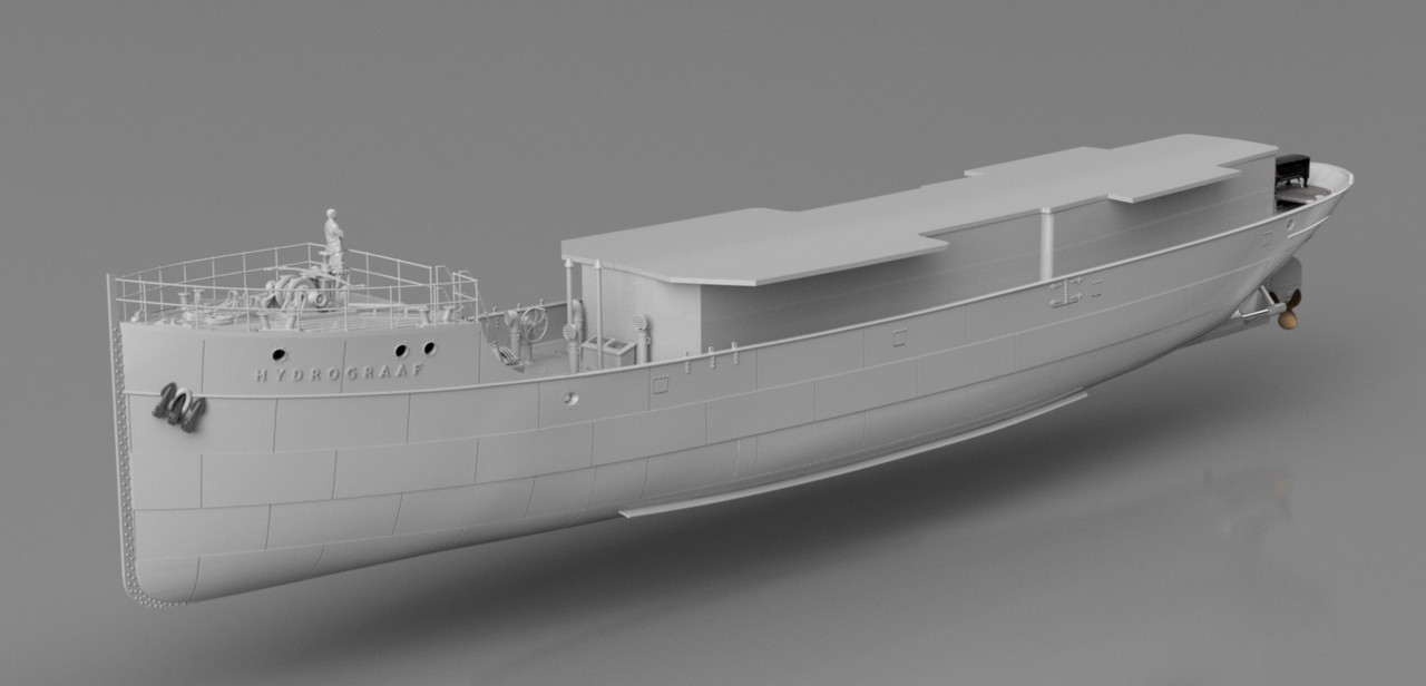

Drawing the openings, the doors.
I'll have to draw some interior furniture because of the large openings.
Pascal

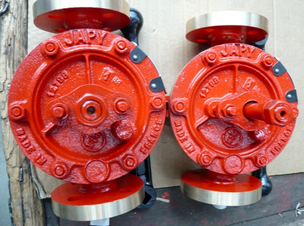

I added a few details, the handrails, the Japy type pump, plus a lot of little structural stuff that was almost invisible, it took me all day.
The famous French Japy pumps:
Pascal

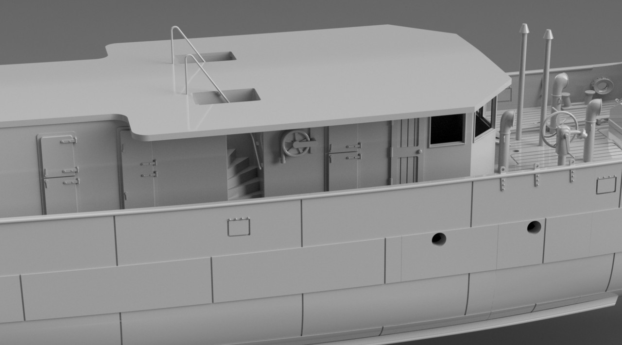

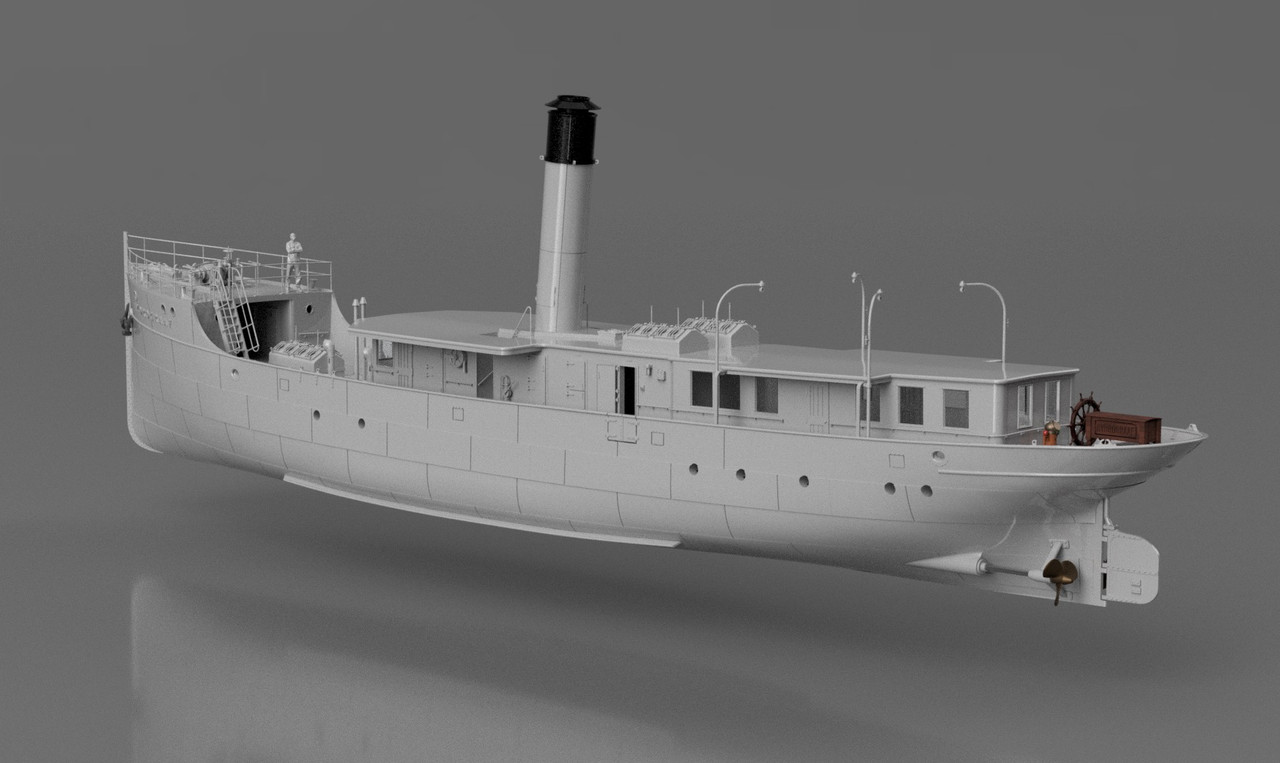

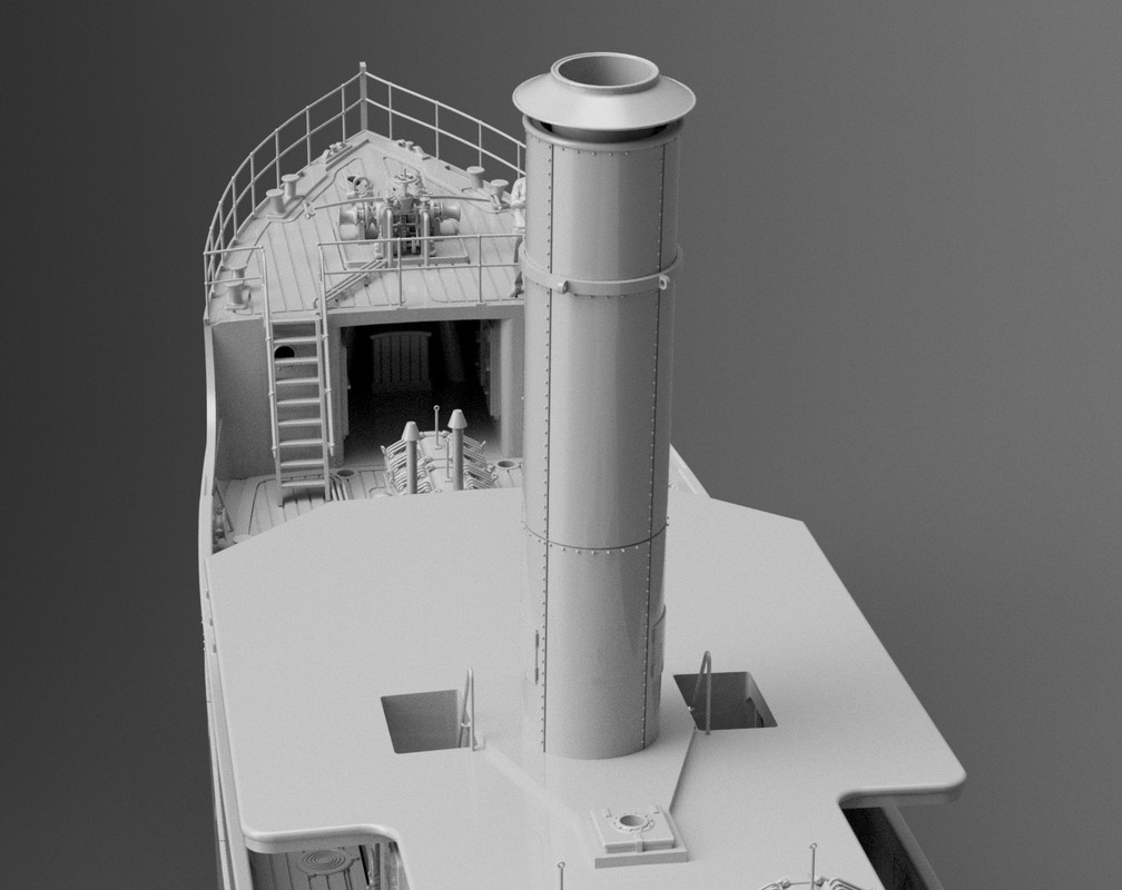

Small progress of the day.

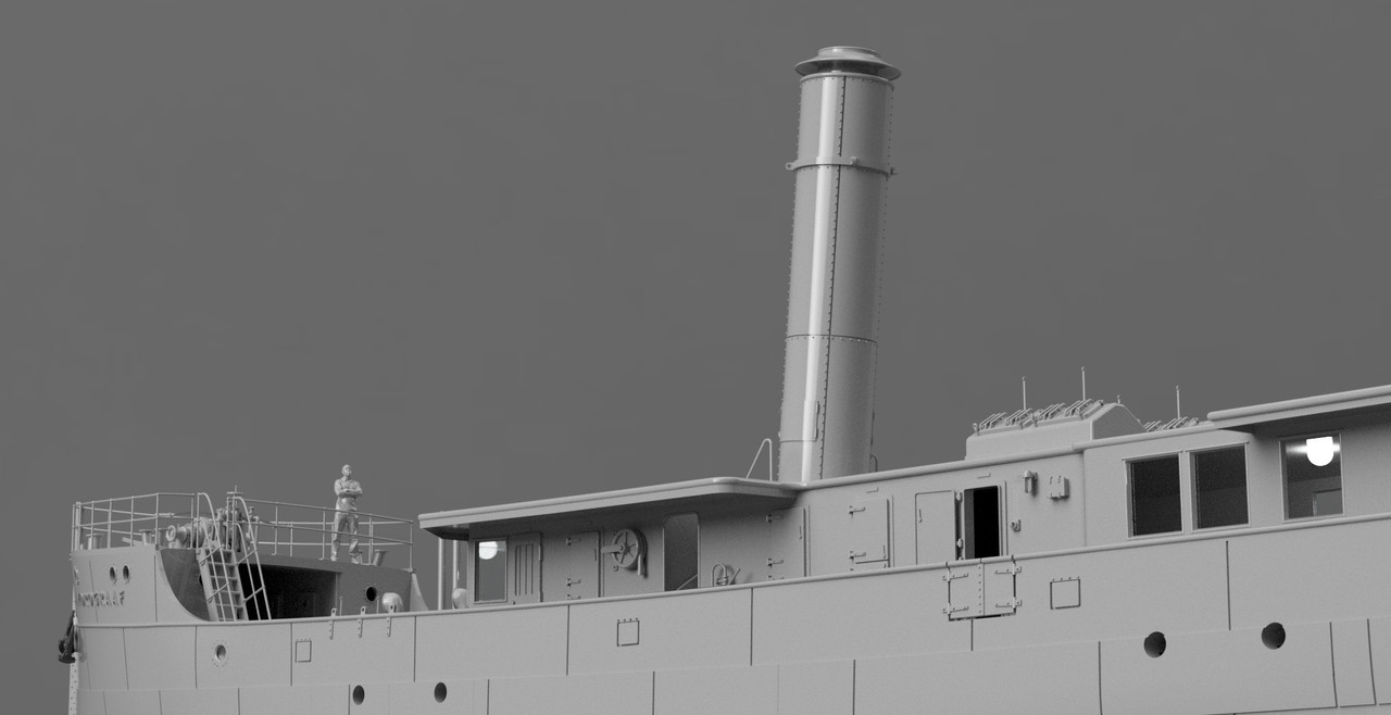

I put some glass on the big portholes, just for fun. I drew the chimney, its base, the skylights and the davits.
Pascal

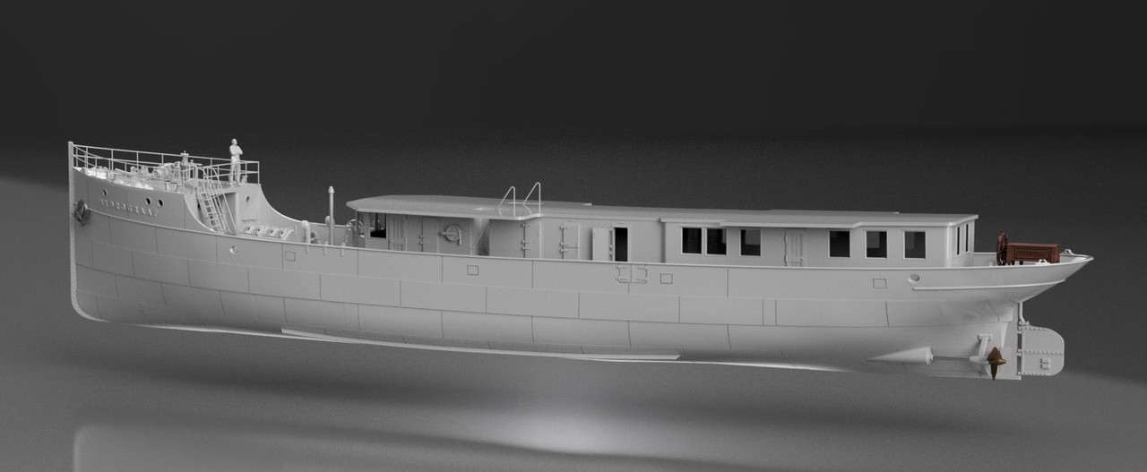

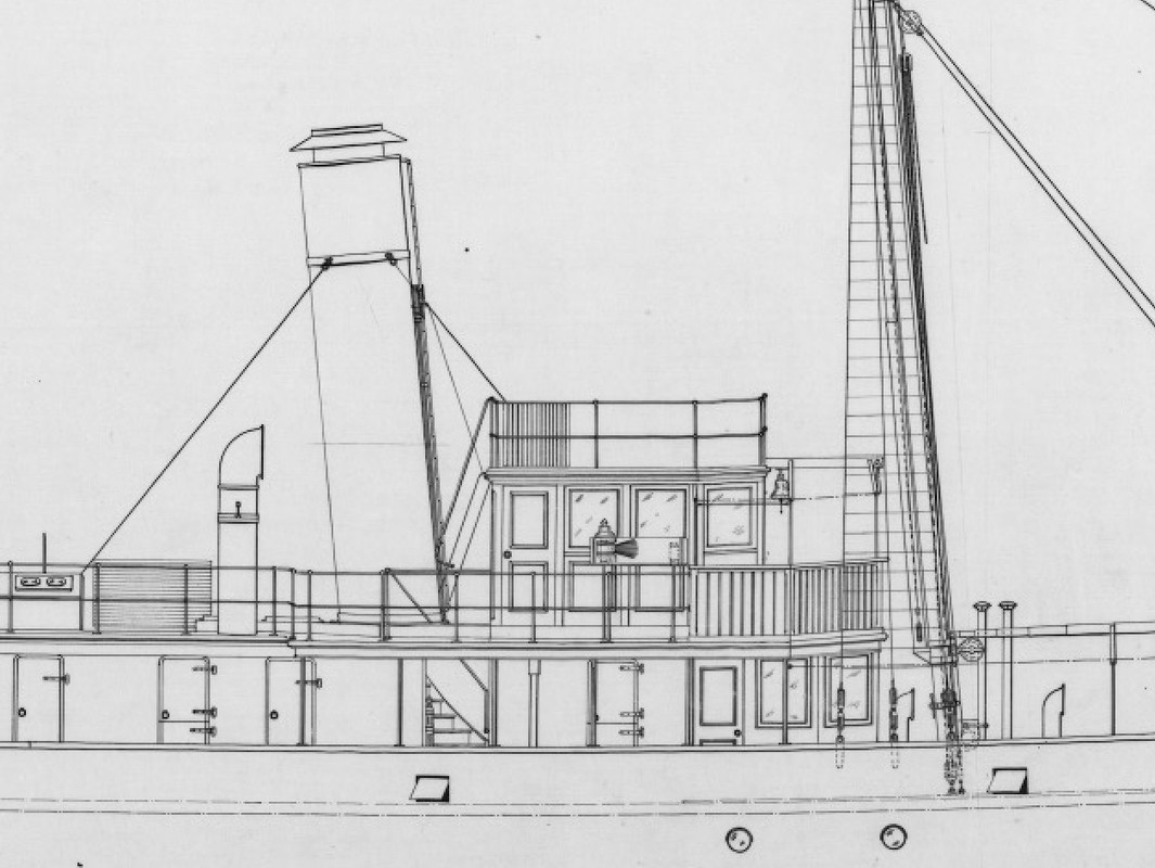

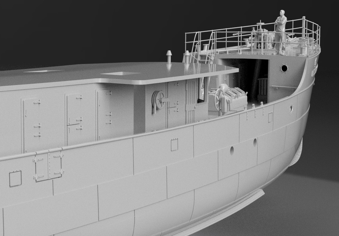

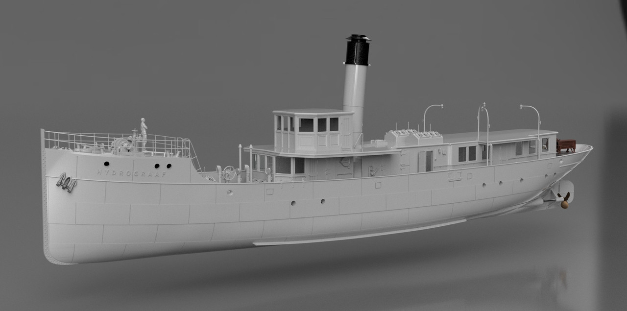

Beginning of the drawing of the bridge, nothing to finish.
It's not so simple because of the mouldings of the outside walls, the different angles, etc. Thanks to Bromure again for one of the pictures that allowed me to not navigate in the fog.
Of course, it is necessary to sort out what exists today and what was in 1910. It is therefore necessary to constantly compare the photos of the time, of today and the plan of 1910 which remains the basis of the project. Because it is likely that this wooden footbridge has been replaced several times since more than a century. So the wooden panels differ a little from the original plans.
But the important thing is to keep the spirit.
Pascal

She's getting complete in a lovely way! But those wood panelling details of the brodge will be a lot of work for sure.
Btw: did she carry any boats? Probably yes. On the deck plans I see a 'vlet' 0f 6.05m and a 'kleine jol' of 5.25m length. These might have been particular for the hydrographic survey task. There is an extensive section on boats in the National Archive drawings website, there you might find the plans of these particuler boats.
