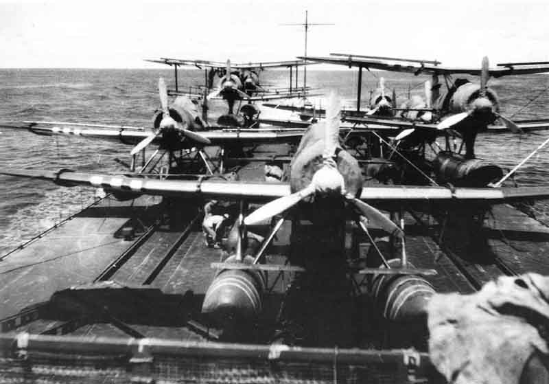

I recently picked up the Tamiya 1/700 Mogami with the flight deck and I noticed the deck around the island house is diamond plate, shouldn't this be linoleum or did they change it during conversion?

The reality is that the area between the rails was treaded (diamond plate) while the area outside the rails was just metal decking. One might think this area would have been linoleum covered but the available photos don't show the tie-down strips. The new Fujimi kit rendered this area correctly; the Tamiya kit would need to have the treading removed outside the rails.

Thanks for the reply and the pic Dan. So the linoleum started just forward of the aircraft deck and continued all the way to the forecastle? I was concerned about the area around the island/bridge area, now its more complicated that I thought, not sure if I want to try and remove the diamond plate from the flight deck as well.

Yeah, that's a problem with the Tamiya 1/700 kit. Best indications are that the linoleum was retained as far aft as just past the rear searchlight platform, aft of the funnel. Even the Tamiya 1/350 kit has this correct.
