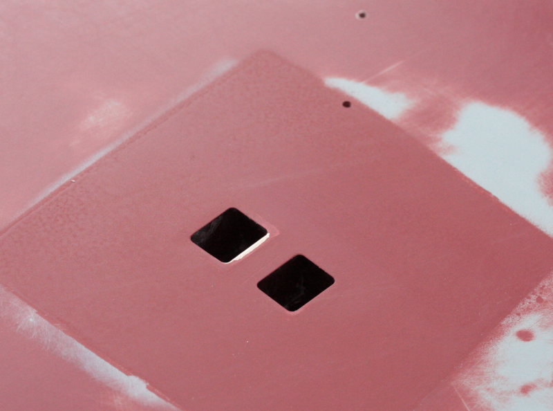

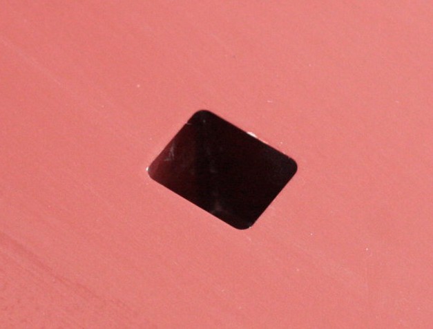

Hi,
I built 4 more sea boxes and dry fitted them into the hull.
Bye!
2 more sea boxes in the rear under water hull.
2 sea boxes right outside of plate run C (executed as docking keel).

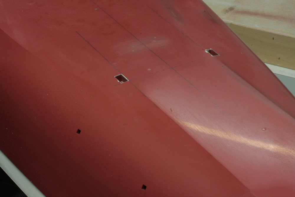

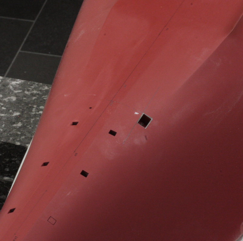

Hi,
added a few more seaboxes ... more to come!
Bye!
Sea chest inside the St.B. shaft housing
Sea box right in front of frame 202.7
Overview hull bottom

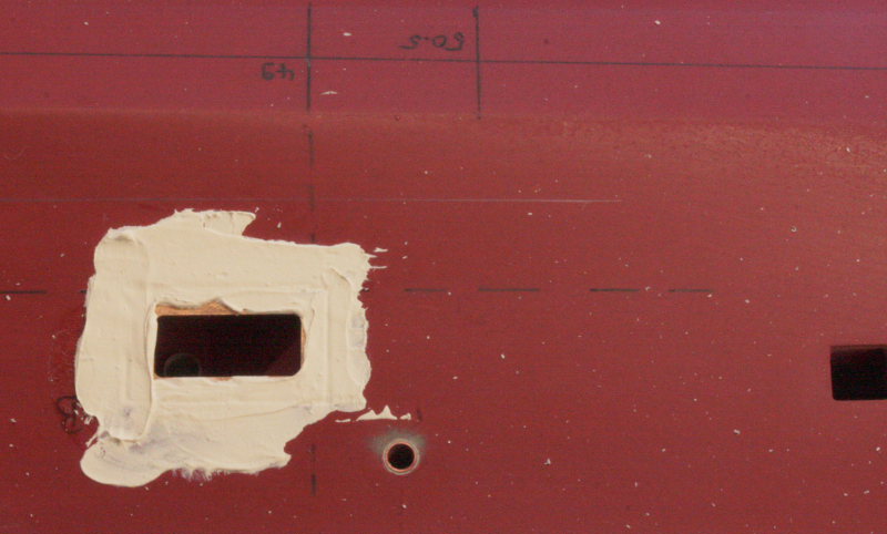

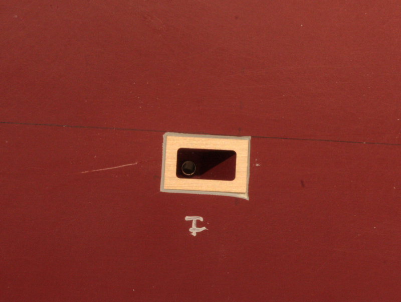

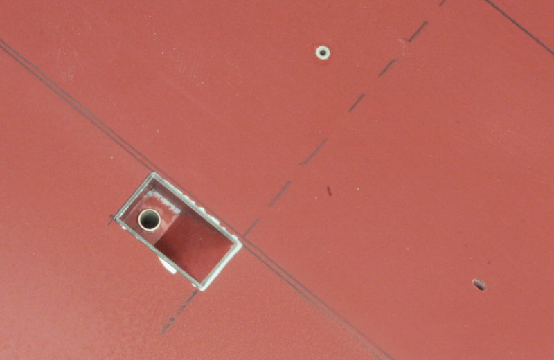

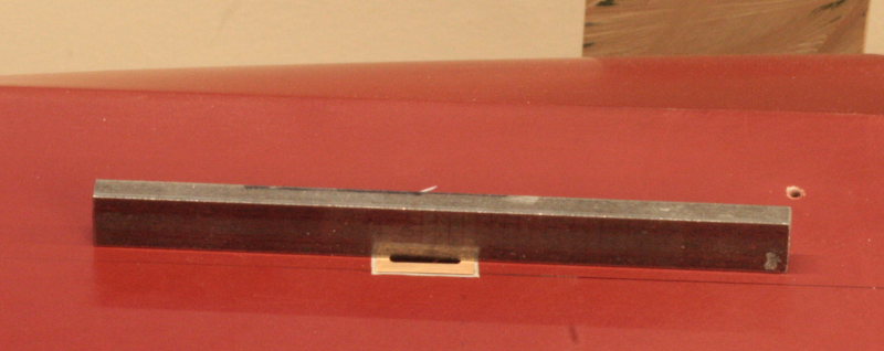

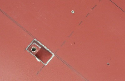

Hi,
some progress on the sea boxes.
Bye! :wave_1:
Fitting sea box into the hull.
Making sure that the sea box is flush with the shell.
Filling and sanding ... what else?!
