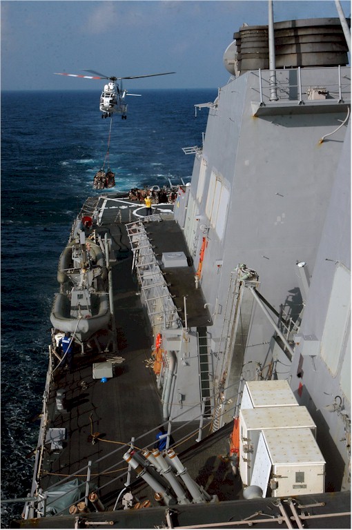

Does anyone have a good photo of where the cable reels were on the forcastle of a flight I ship?

Are you talking about this, or something else?GTDEATH13 wrote:Thanks Cliffy B.![]()

Re: Calling all Arleigh Burke Class Fans!
Thanks for the photo Bob, but is this not a hose reel?
I need to know the location of the reels with the ropes for mouring... Or are the ropes stowed below decks?

Nick,
Are you referring to the mooring lines? If so, you'd have to check with someone who served in the Navy (I didn't) to be sure but I don't think I've ever seen them stored on a hose reel. Presumably, they're stored internally for protection from the elements.
The picture of the Barry is a hose reel, it is a hard rubber non collapsible hose used for AFFF firefighting foam. On modern USN ships, the mooring lines are stored out of the weather and are not visible.

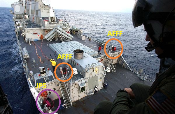

Thanks for the info Mr Landrum. The same type of reel is used for refueling the helicopter with fuel (JP5)... There are two such reels at the for section of the helo deck, one with AFFF (aqueious fire fighting foam?) and one with fuel...
So if all ropes all stored below deck, all visible reels on a ship of the class are hoses?
Nick,
You are correct the visible reels are AFFF (red reel) except the JP-5 (NATO F-44) reel on the flight deck. That reel and its associated piping is purple.

In case anyone's interested:

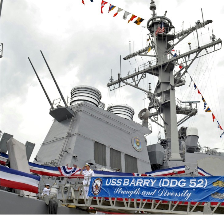

Does anybody what is this whip antena highlighted in the red box?
I have noticed that it is erected only when the ship is afloat and in port it is bent forward on a stand.
I have seen this whip only in flight I ships...
