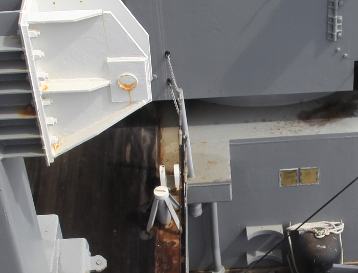

- Posts: 5068
Re: Calling all USS Iowa class fans
Port side, 52 and 54 mount bases. The vertical plate along the deck edge is about 8" wide and protrudes about equally above and below the actual deck level. The finished deck level around the mount is steel and is at the same level as the surface of the teak.

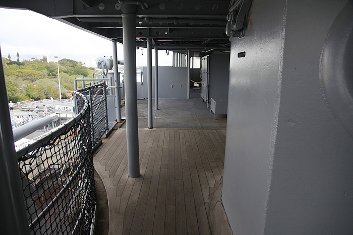

- Posts: 5068
53 Mount stbd side. Note the teak decking is level with the waterway at deck edge and same level as the mount base top.

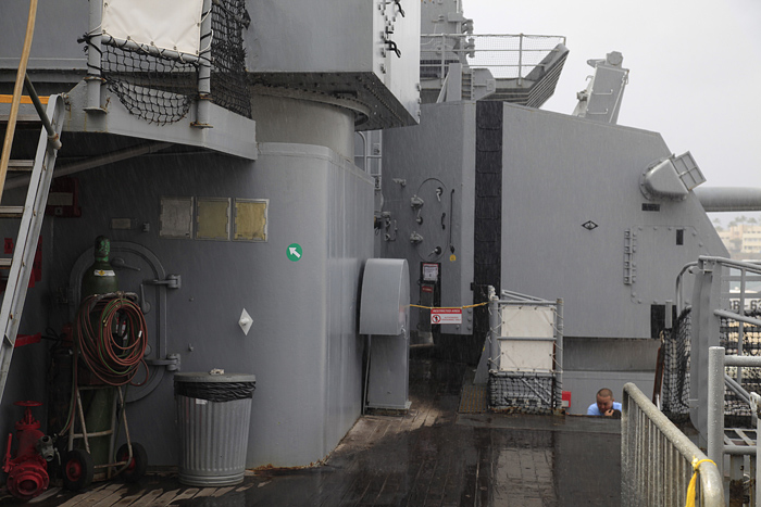

- Posts: 5068
Flag bridge port side. Note stanchions fwd. On the stbd side the most fwd stanchion has been cutoff at bulwark top. Note that the steel decking flush with the teak fwd was added during modernization for splinter protection to areas below. Originally planked...
