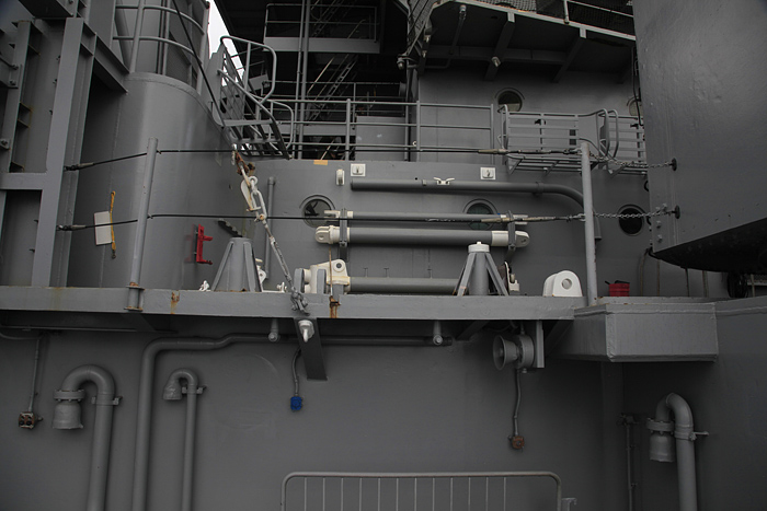

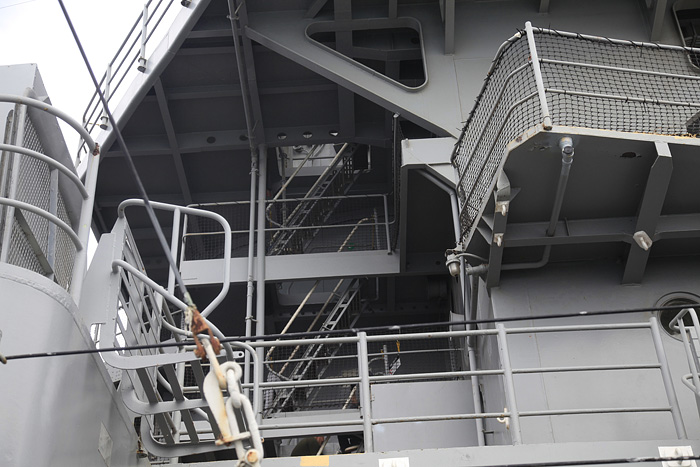

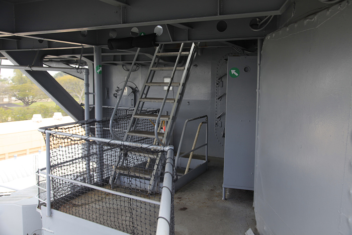

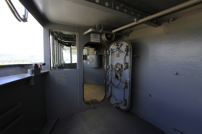

Mo Photos (no pun intended...)

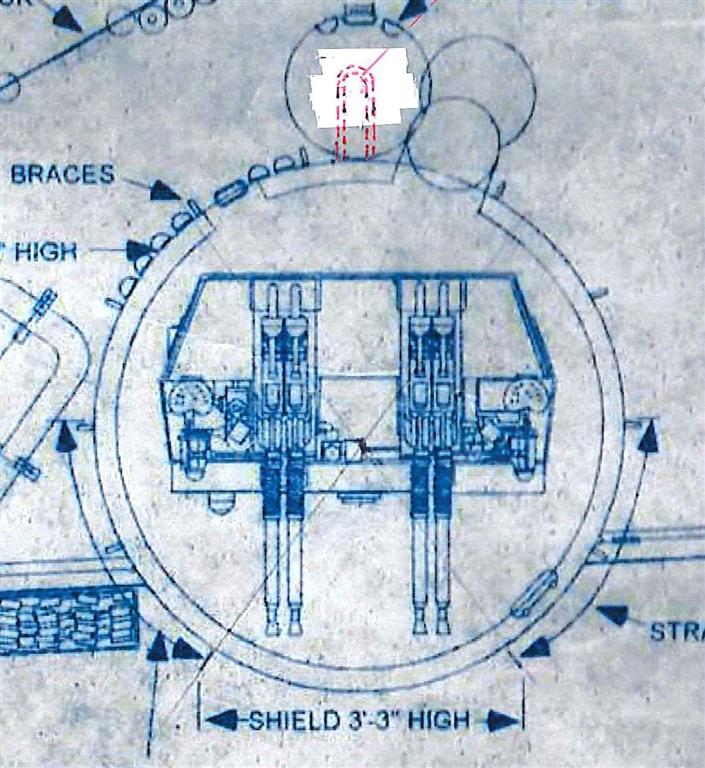

Next question... and this one may be more difficult to solve. It was so hot in Southern California this weekend that I decided to stay inside. I spent some time working on various parts of the 3d model as well as the actual hull. I have found that the research resolves into two basic categories: parts of the ship which are still in their as-built configuration, and parts which are not. Obviously there are far fewer photographic records (at least, that I have found) for the latter category. One such area is the mk51 director tub for the forward-most 40mm installations on the 01 deck. I have basic data from the plans and various photos I have found, but am specifically lacking in (at least) two areas:
- the 40mm ammo cupola, which from the plans appears to be two cylinders mounted on the deck adjacent to the 40mm tub, and
- the stand for the director tub.
See the image below - the first shows the cupola (of which only one of the cylinders is "installed"), while the second shows the stand. Absent any real data, I used the same basic style as the ones in use on the forecastle.

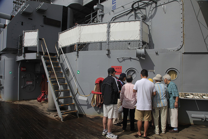

Items no longer installed, removed with the 40 mm tub. Joy-Z photos show no elevated structure here, director was either at deck level by the mount or possibly 05 level. Interpretation of photos I can find suggest that the round object was a director tub, possibly covered over later when the mounts were removed. Note location of toe of inclined ladder. Life ring is currently installed in a similar location on the main deck bulkhead.

That makes great sense. The only information I have is as shown in the image below: the cupola (which is labeled on the opposite-side drawing: I happened to scan this side) is represented by the two overlapping circles forward (right) of the director tub. It appears the smaller circle is actually part of the 40mm tub (the hatch, as you describe). So is the crewman standing in the larger circle, passing ammo via the smaller circle to someone in the gun tub?

Per your 3D rendition with the arrow pointing to the FC Director Pedestal behind the 40mm tub - I believe this is not a round pedestal but a "U" shaped base - I have modified your blueprint to show (not to scale) what I believe is the correct FC tub base. I am basing this assumption on various photos of that particular gun tub and its assoc. FC equipment that I've looked at via NavSource, etc. Not a lot of good photos close up of that equipment.
Hope this helps your 3D project!

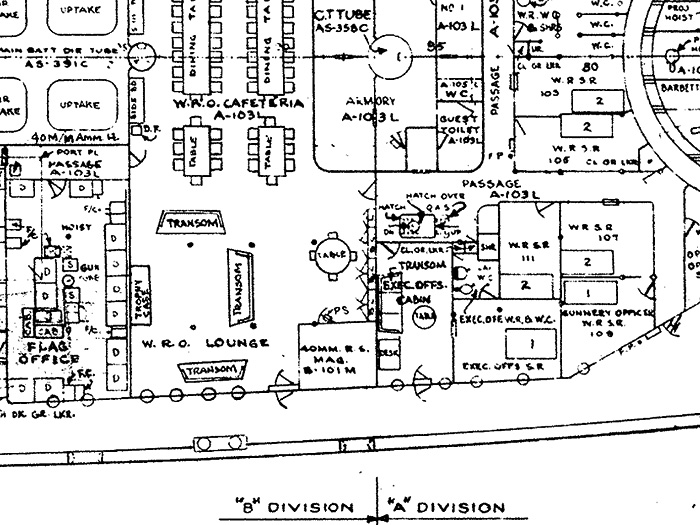

Main deck Plan BB63,wartime. These 40 mm ready service lockers/magazines have been currently absorbed as a wardroom stores locker stbd and security force locker portside.
The fire control tubs were unquestionably removed at a very early stage in the operational careers of some members of the class. For my project I have the advantage of many photographs of the ship in a relatively close iteration of the era that I am building it. It would be fascinating to be able to know what was changed during the careers of these ships, when and why.
The aft tubs on BB63 do not have the ammunition handling cupolas currently on the fantail whereas these were shown as still expressed on one of the other ships in the photo bucket link above. The magazine space below is currently a CPO storeroom.

Hank, Tom, James, et al... THANKS. This is all hugely helpful. Just to clarify my interpretation...
The cupola as explained makes good sense to me: somehow the ammo must be replenished, and the simplest would be a man-powered chain from the clipping room to the gun emplacement. That link is a man standing in a shielded cupola. The connection between the cupola and the gun tub is understood based on drawings, photos, and James' description.
However, there are still some pieces missing. For example, my blueprints indicate the cupola is only 48-inches tall. So either short sailors were selected for this GQ billet or the cupola extended below the 01 deck level. Also, I don't see the connection between the cupola and the clipping room (and now is where you may have to advise me to step back from the edge). Along with all the exterior work, I have been completing very rough approximation of interior arrangements. I'm mostly concentrating on the main/01 decks so far. But as shown in the image below - which shows the interior below by basically turning the intermediate decking "off", the cupola sits inboard of the clipping room below, and there is no hint of any mechanical hoist or other means of getting ammo up to the man in the cupola. There is a hatch in the 01 deck which is relatively close, but its twin does not exist on the port side, so.... ???
