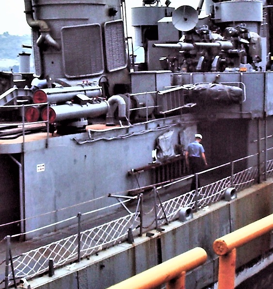

I am looking for any detailed drawings of the accommodation ladder for FLETCHER class DDs in the 1950's/1960s. The Floating Drydock Plan Book does not include a drawing (or photos that I could find) of this item and we certainly carried one on USS STODDARD (DD-566) in the 1960s. My color photos show it stowed on the stbd. side amidships but I'm having a hard time determining if it was "painted" wood or actually wood; my tendencies are that it was wood with metal step treads and hardware. I don't think other than a 7 day port visit to Hong Kong and our 2 weeks Refresher Training where the ship was moored or anchored, was this ladder used while I was stationed aboard.
Any detailed info would be helpful.
Posts: 3880
Post by Rick E Davis »
Accommodation Ladders on 1950-60's FLETCHER's, boy that will be hard to find good images of. I have seen where these were stowed onboard, but right now I have a hard time recalling seeing them in use. I actually had wondered how often they were used, you sort of answered that question ... not often. I really suspect the same ladders were used in WWII as well, so that may increase the number of possible images to explore. It will take me time to go through images, I know I don't have line drawings of them.
