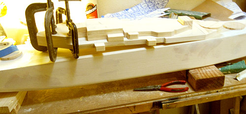

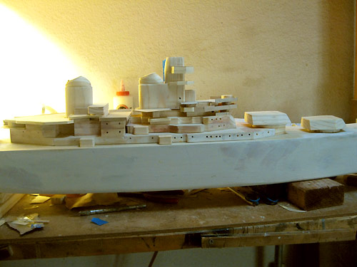

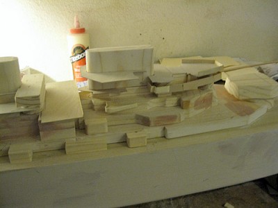

Some of my reworking of deck02.
This time I uncluded that passageway @midships.
The Trumpeter 700 scale 1991 Missouri does not show that.

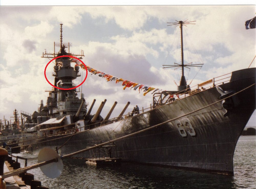

Pit-Road is a Japanese company. They share some kits with Trumpeter.
See attached picture indicating the ECM housing. New Jersey has a very different one due to her Vietnam modifications that none of the other sisters received:

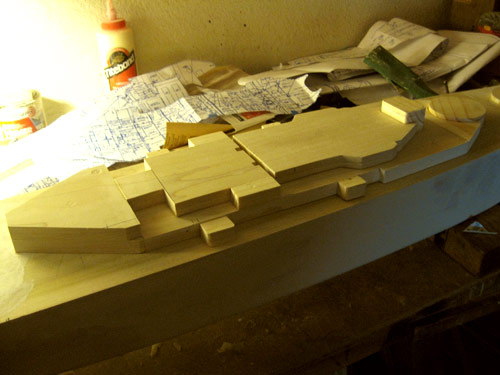

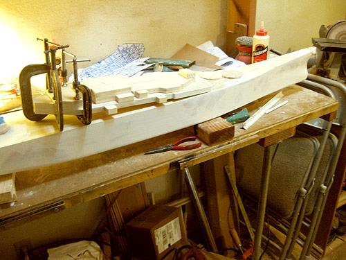

Re: 1:192 USS Missouri modern configuration
Adding more layers and figuring it all out.

The "round balls" located above the ship conning station (08 level) and fwd of the aft stack were apparently for communication with the drones. They are not currently on the museum ship.
Making good progress!
T

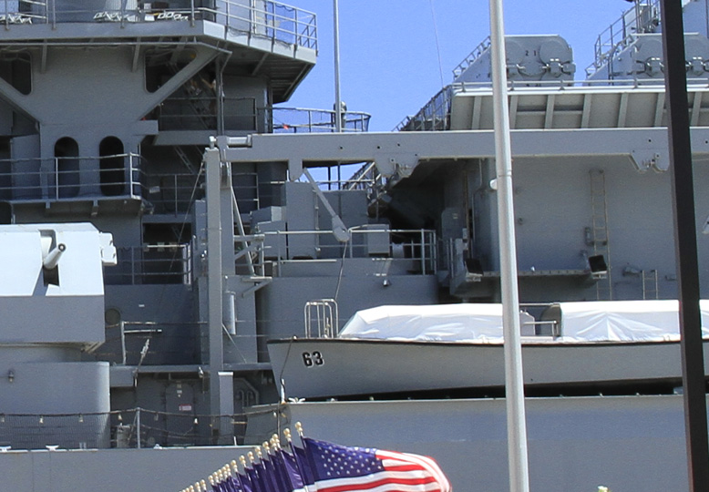

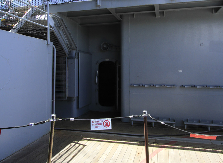

- Posts: 5068
Not the greatest photo as the area you are interested in is in the shadows, but there is a W/T door just a bit back and not an open passage where you are looking just aft of the position of the removed 5"38 mount. The second photo shows the top of the expansion joint on the next deck, which has some sort of flexible cover.
T

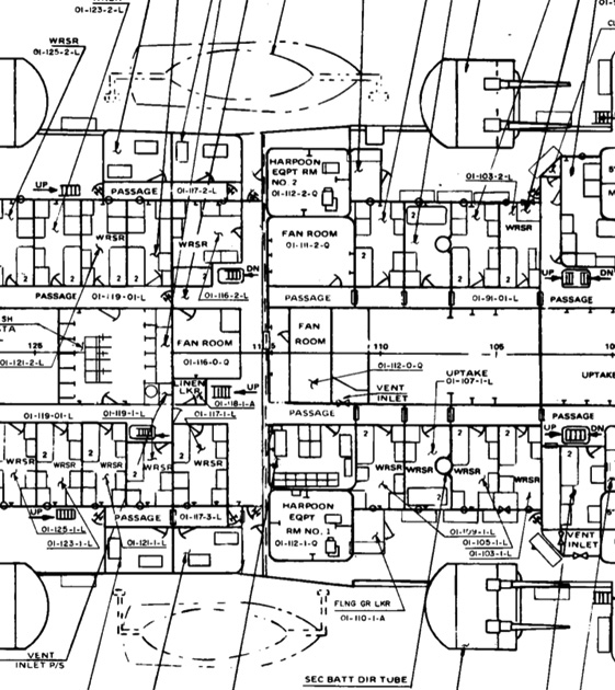

- Posts: 5068
Shows that the passage her is internal, the dashed line is the expansion joint.

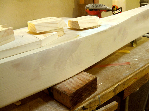

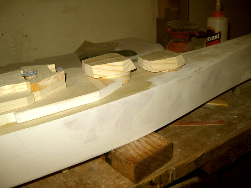

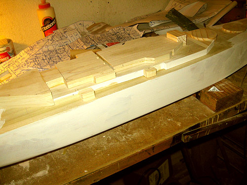

Today I made it to the level 5 deck.
Went to get coffee.

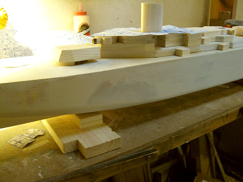

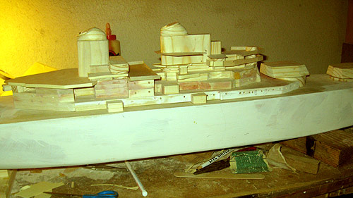

More progress, but I will need to get some railings on before I can proceed with glueing on decks.

- Posts: 5068
Luky
Check your 02 level abeam the aft edge of the aft stack. Most of the cutout here should only be on the 03 level. This area was the location of the aft pair of 5" mounts and the handling rooms structure remained.
Cheers. T
