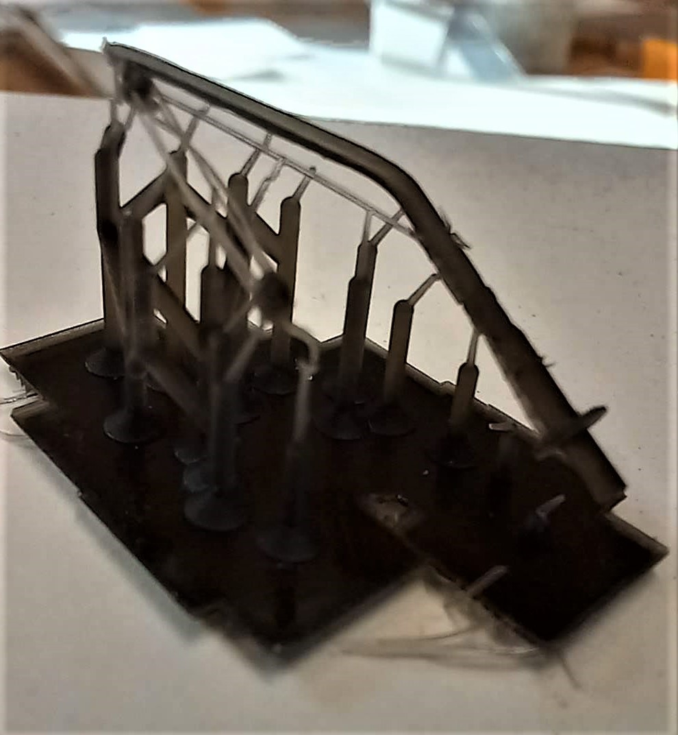

Printing the Davit, etc. - the 3rd edition wasn't worth keeping - I had printed them flat and that didn't really produce a good part. The 2nd edition came out actually better, if not still with issues. I printed those at 60� from horizontal -

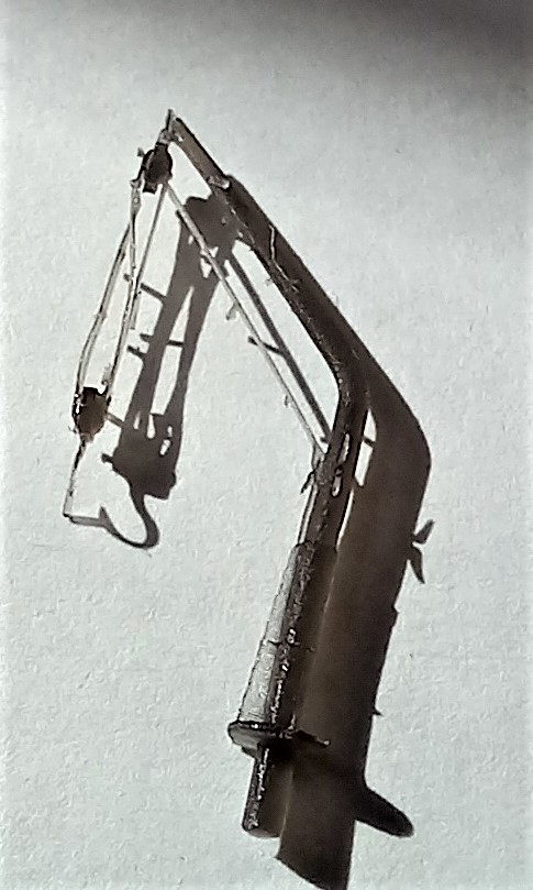

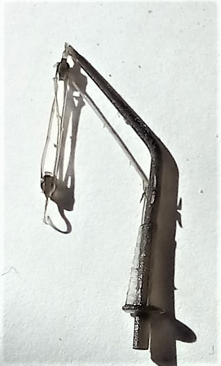

Keep in mind that this item is barely 5/8" long and is extremely fragile to handle. Here are a couple shots of it after trimming supports -
If I were to use these it would require a lot more very careful trimming of support ends that remain on the part. I'll pursue doing a bit more work on design before printing a 4th edition. I know with this that it CAN be done, now to just refine it to a useable part!

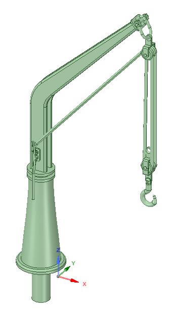

Last night I managed to corrupt the davit file for the cane fender davit and probably won't be able to use it again. A redraw. So, I opened the small stores davit and began adding the various parts for the block & tackle to it - AFTER resizing due to having drawn it up a bit too small to begin with. I now have deck plans & sheer elevation view that is scaled correctly so I can double check these parts without having to do a lot of dimensional calculations. So, here's a partially completed davit - maybe get more work on it done today -
Again, this is another very small part (24mm high [7/8"]) so will be rather fragile to handle, etc. Once I have this printed and usable, I will return to the similar cane fender davit and redraw/reprint it, as well.

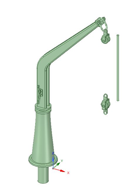

I've got this part now to where I can try a test print this afternoon -
I'll orient this one at 60� from horizontal and see what happens - probably print one at scale, one at 105%, one at 110%, and one at 115% and see what comes out closest to being correct. The losers will be deep sixed into Davy Jones Locker.
