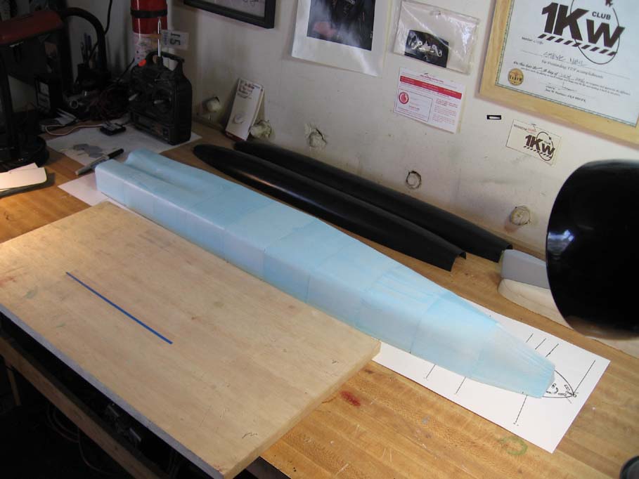

To continue:
Here's all the sections together. I later added the small bow section with some scrap foam. As you can see doing the sections with so few bulkheads removes some of the curves. This is natural. A way to fix this is to make more formers but it takes a great deal more time and I find a bit balsa filler and then glass corrects this very quickly. After it's glassed I use Evercoat metal Glaze to really polish it off.
Here it is top side before I started shaping the stern.
The stern has some complex angles from all sides I was able to mark and then cut with a razor saw.

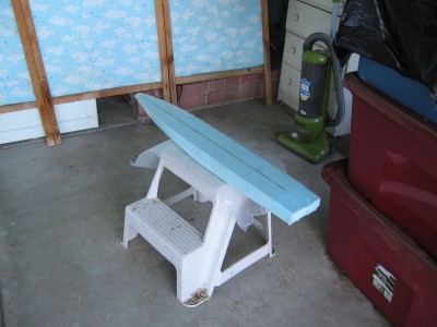

Not much to see. Glassing the hull. Got a bunch of layers on today. Tomorrow I'll sand and glaze. Next step after that is to hull plate it with styrene sheet.
While I'm waiting for epoxy to set up for another 24 hours I'll start on the deck structures. More tomorrow.
Steve
All sanded and ready to go.
All glassed with 5 layers of 2 oz. I only need it as a barrier for the styrene. More than enough.

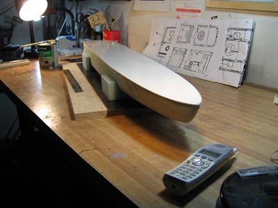

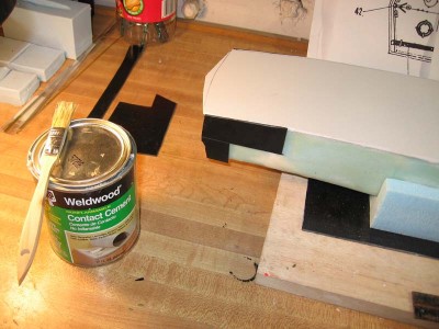

Finally got this lumpy hull sanded down smooth enough to start the hull platting with styrene. I have lots of left over pieces from vacuum forming that came in handy.
I did the deck first. Thats the easy part and then using the plans and pictures of the model started plotting the panels or plates. Not easy as the plans don't show their locations at all. So you have to work from pictures of the real boat and model and wing it. As it turns out from boat to boat, like so many other things built in WW2, they are not consistent giving me some latitude.
Tomorrow I hope to get most of the platting done. For the curved areas I plan to use a heat gun to soften the plastic and bend it around. I'm using contact cement to glue the platting on as CA will crack and weaken styrene.
Once all the platting is on I will use CA over the seams to create the welds. It should be OK to use it for that purpose once the plates are glued down.
It's starting to look like a hull.
Steve
