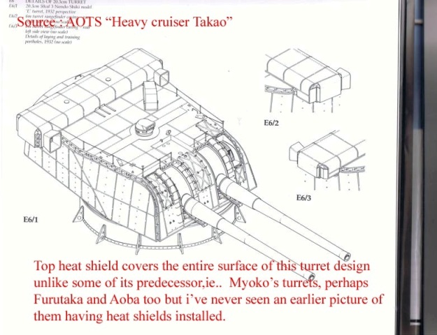

You do realize that there was a gap between the side and the roof and between the side and the face, don't you? The purpose of these plates was to allow cooling air to circulate between the hot outer plates and the actual turret structure. The gap was necessary for the circulation. Or is there some other size issue that you are referring to?
The heat shields you are right about that but if i'm not mistaken this turret design covers the whole turret's surface unlike some of the ones i've seen on the Myoko class. i'm going to check my AOTS book when i get home from work today.. i'll let you know.

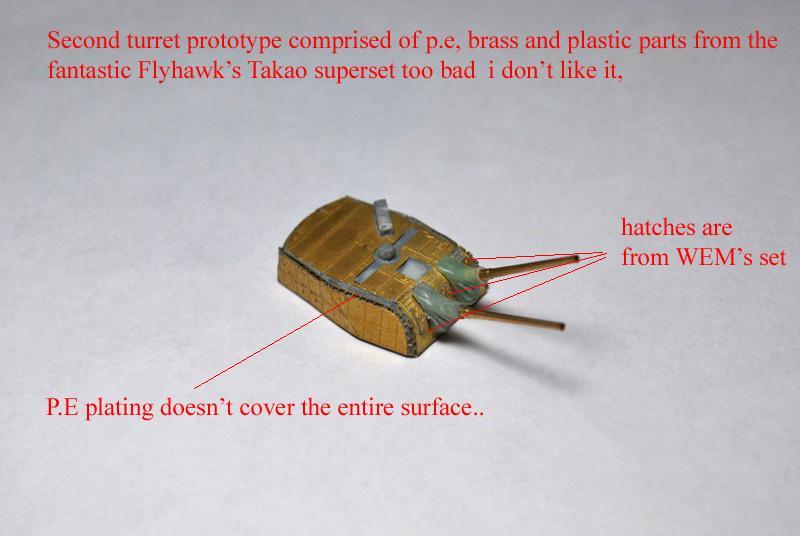

i think i know what's the problem Dick, it seems these P.E parts were not designed for Minekaze's turrets somehow these are bigger than Aoshima's

You probably misunderstood what I wrote about the gap, i wasn�t referring to the heat shield�s small gaps above the roof of the turret but to the gap left on top of the turret when i attached the P.E plate on it, as i wrote before i know what happened. Flyhawk designed these plates solely for Aoshima�s Takao turrets not for the custom made Tone from Minekaze, thus P.E turret panels are much smaller than the turret itself and doesn�t cover the entire roof surface, its ironic though because the side P.E panels and even the rear one cover those 3 surfaces pretty well..

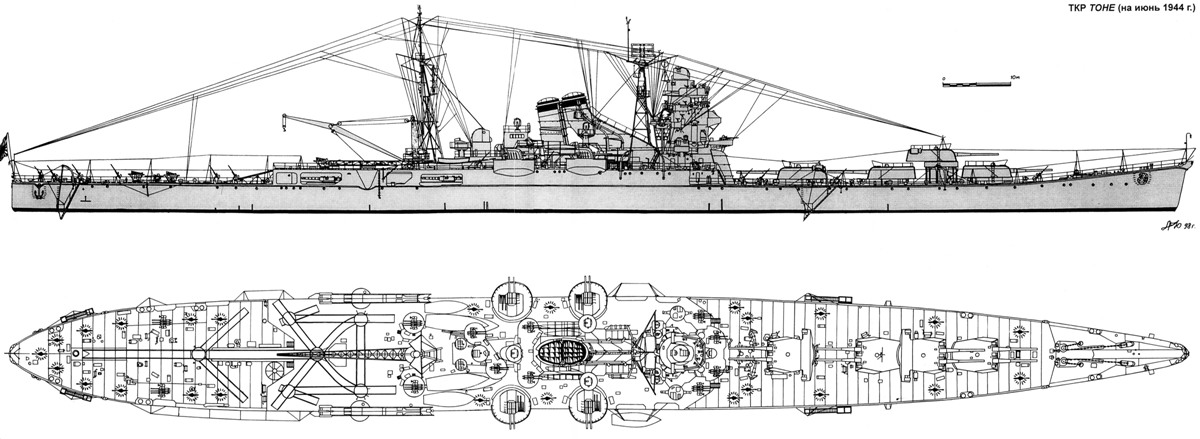

it is a profile morskie (# 13) on ijn tone, they sell the plans:
_http://profilemorskie.home.pl/PDF_350_Jap.htm_
or the book
_http://profilemorskie.home.pl/Bookshop_1.htm_
ciao peppe
from a russian book of apalkov on the ijn cruisers of the ww2

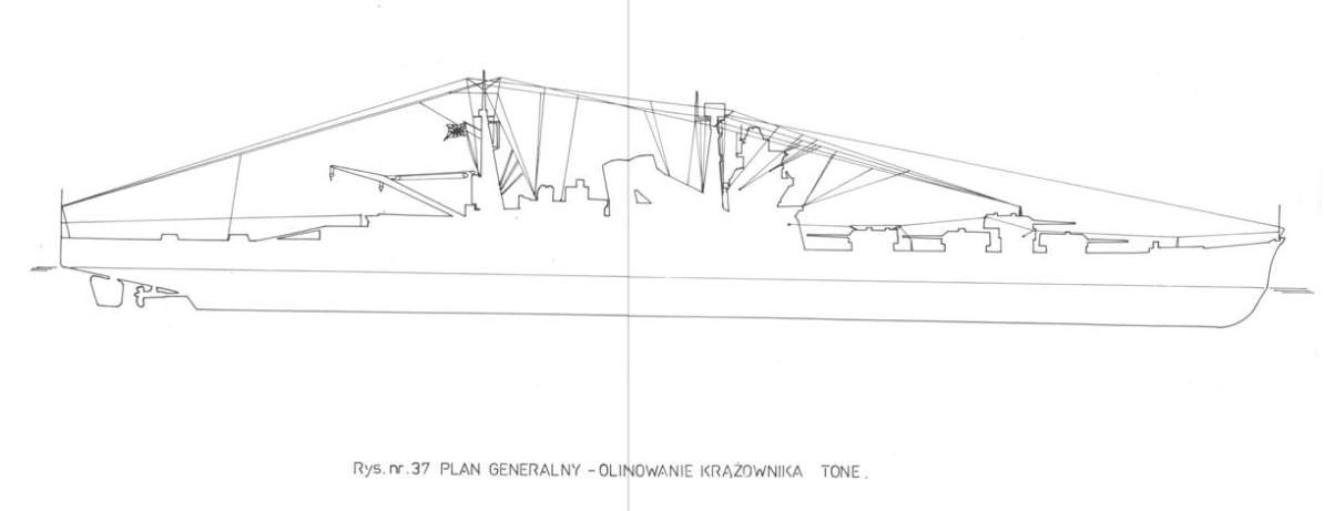

from a polish book
from a polish book
