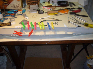

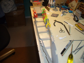

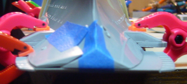

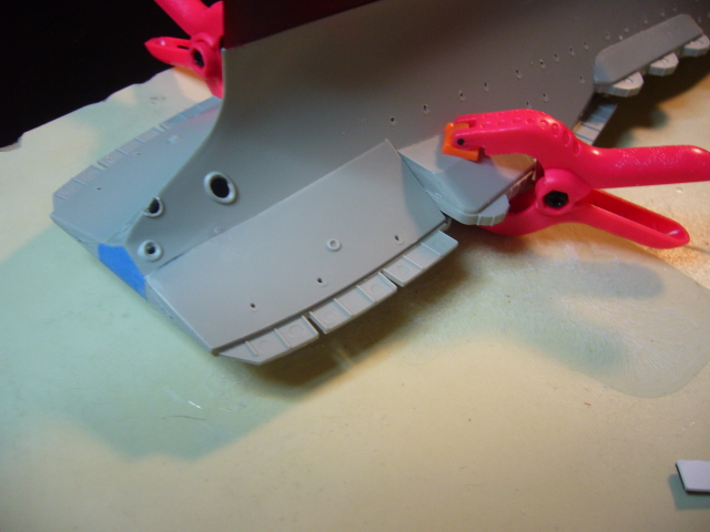

I;ve been debating whether to install the boat pockets or wait for plans to do any modifications before they were on the ship. Time won out as the plans are still at least a month away so I went for it. There were the typical problems with the thin piece across the top ot the opening being stretched. ONe was close enough to just glue, the starboard one. The rest I cut in the middle and will sand down to size and glue once I have the upper hull fitted to the lower to take out the sag previously mentioned. I also installed the forward aa platforms.
While doing this I was trying a dry fit of the flight deck and think I might have a simple solution to the front sponsons for the widened flight deck not fitting. At least it looks feaseable but will have to wait till I install the flight deck as it involves putting them on after the flight deck.
- Long view
- Picture 020_320x240.jpg (56.18 KiB) Viewed 2008 times
- All clamped up and nowhere to go
- Picture 019_640x480_320x240.jpg (62.53 KiB) Viewed 2012 times

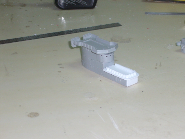

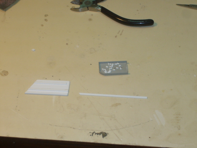

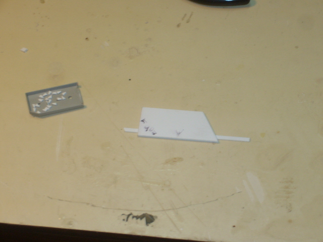

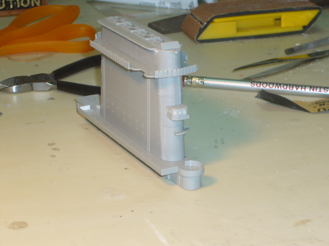

How to model the splinter shields was a perplexing problem. If it's this tough working in 350 I have immense admiration for those who work in 700.
Anyway, the problem:
Make a bunch of tiny little parts. Then install same.
What I came up with was a little jig. I cut a pice of 1MM styrene making sure one corner was accurately square. I then glued three strips of .25 stripping, the same stuff I was making the pieces out of on one side. The first was flush with one side. The next spaced exactly one strip away (I clamped the three pieces on, glued the outside edge of the outer one, pulled out the one that was a spacer, and let it dry), and lastly one more further out to balance it while in use.
Now to make the angled side. I took a piece of strip and cut the needed angle on it. I clamped this on along the bottom edge of the jig, clamped a small steel rule to the face of the jig along the angle, marked this line with a pencil, and then cut the jig to form.
The procedure was to square one end of a styrene strip and then turn the jig around. I used a 1/4 inch chisel to cut the pieces and would let more of the strip extend than I needed, set the chisel at the spot I wanted, slide the jig up to it, and then cut through. Of course the first one took off into space like a rocket and I quickly changed to getting the chisel set, sliding the jig back, placing two fingers on each side of the chisel, and then cutting thus trapping that pesky little critter. Then it was time to install all those teeny tiny things. As I suspected earlier they had to be bigger than the actual supports because it would be next to impossible to make the things as thin as necessary and still be able to handle them, for me at least.
Now the fun part, there are at least two more areas that need this treatment!

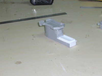

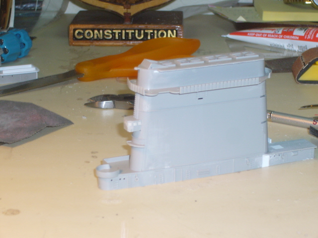

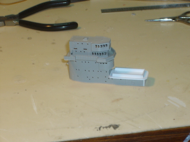

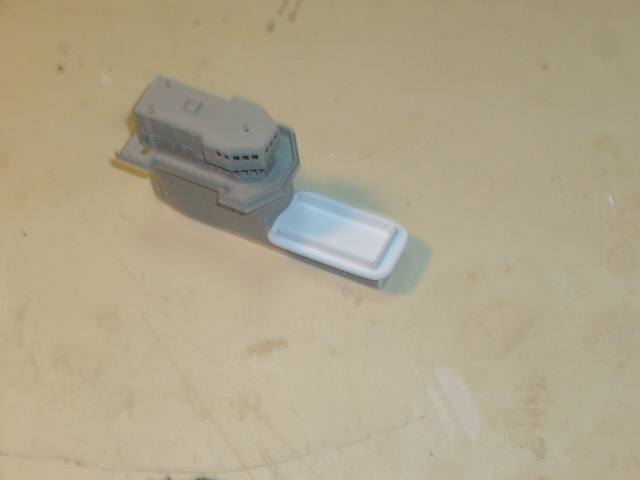

Here you can see the modified radar room installed. You can also see the area at the back that Chris had added the same splinter shields as I put on the island structure.
There are a lot of questions here. The top AA platform has shielding modeled on three sides but not the fourth. In the photo I found of Lex just before she was sunk it seems the same type shielding was also along the bottom rail which was modeled smooth.
Will I find more evidence to help either way? Does the back area I have cleared have the same?
More research required. Inquiring minds want to know.

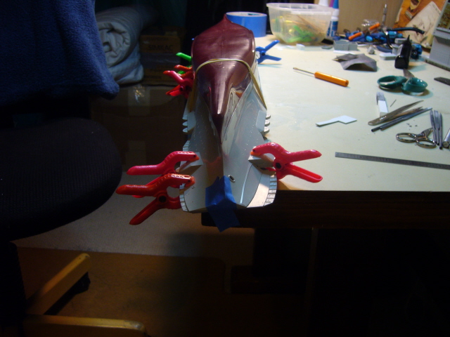

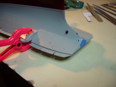

Re: Calling all USS Lexington CV-2 fans

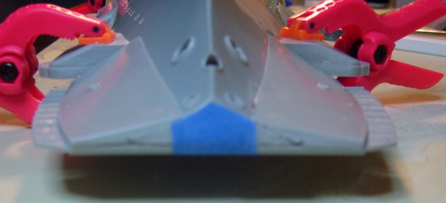

This is the part that seems to gather the most attention gaging by the hits on the pics. How to fix the deck widening sponsons so they fit. Since I had seen the problems others had and their solutions I did not glue mine on first as the directions show. Due to the problems with the upper and lower hulls waring and flexing I had to wait till they were joined and flat to dry fit the flight deck. I waited till I could dry fit the deck and view the problem from a different perspective, namely making a piece fit rather than adjusting one already glued on.
The problem seems to be the front edge of the sponson. If you fit the sponson to the front of the deck it hangs over the edge. If you fit the edge it leaves a big gap at the front.
My solution was to mark where the front edge of the sponson needed to fit at the flight deck itself. I then sanded this part to fit. Now the guides originally on the hull were holding it out so I cut and sanded them back as needed. Now they fit. It does move the edge very close to the hawse holes but still clears them so I thought this was acceptable. As you can see there is still a little sanding and filling to be done but not much at all.
For some reason my pics are in a very high state of resolution and this causes problems with the image capacity of the website. The settings on my camera do not seem to be adjustable but then again I'm not that much into that stuff so who knows? The image limit is about 150 and almost all of mine exceed this in their original state. I reduce them to 640 x480 and this works for most of them. There are still a few that exceed the 150 limit and these I had to reduce to web size or 320x240. I only have a basic photo program and this is all it allows. I wish it were different but it's the best I can do with what I have.
Enjoy
Jim
Enjoy
Jim

Nicely done, Jim. Excellent solution.
I was one of the folks who followed the instructions and glued the flight deck pieces to the hull, which led to the requisite "SON OF A #$@%&!" when I dry fitted the flight deck.
Tracy's solution worked quite nicely as well, fo those of us who dove right in!
Bob
