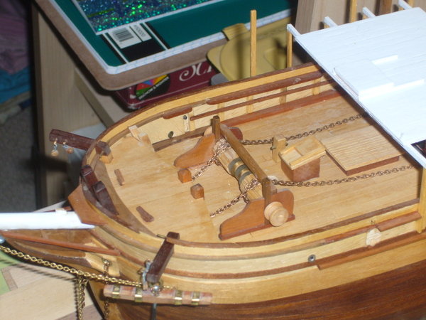

Re: Calling all USS Lexington CV-2 fans

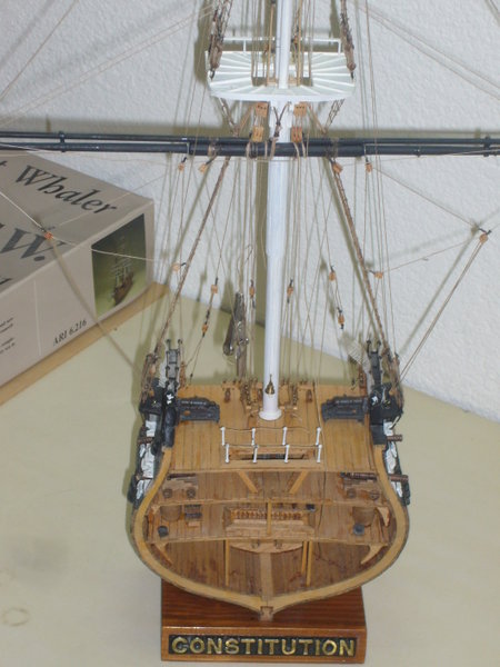

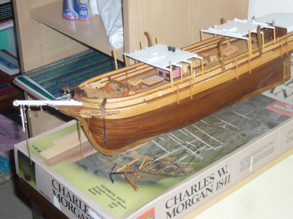

I thought I'd first give a little insight on what I normally work on. These are shots of the two I had going when everything went to hell a few years back and they got tucked away in storage. I was just starting to rig the Charles W. Morgan and had the bowsprit pretty well done. In the pic you can see that it got broken off halfway out, the top piece is gone off into that land of lost socks and such never to be found again and the mast of the COnstitution was broken just below the top yardarm. The mast got fixed but there was a lot of other damage not apparent in a casual view. SInce that was the one closest to completion I decided to devote most of the time to that. You'll also notice that my shelves and work table seem very empty, not counting the necessary supplies, BUtterfingers and Whoppers. All my tools and such were still off in storageland doing their best to stay hidden. But this is what I am used to working on.
Note that although they are built from kits it is just a bunch of sticks and string to start. They are assembled stick by stick, string by string.
Jim

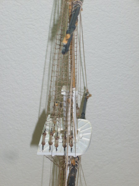

This is a shot giving a good idea of the detail in the rigging.

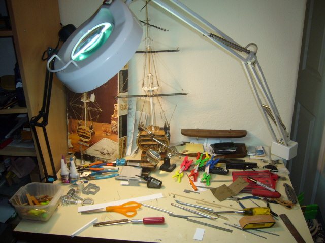

Ok. Here's my work table after I finished last night. You can see the Constitution in the background as she has no place else to be. You can also see the bridge and stack pieces laying around and if you look closely you can see the elevators in the corner. Then there's my container of clamps, a lot of which are in use in the background. I'll explain what that is further on.

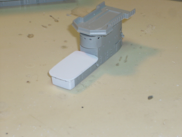

Not sure why but I seem to get through with this one. Hmmmmmm.

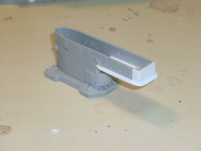

This is as far as I have gotten with the bridge following CHris's details. I squared up the front, tossed the provided deck and made a new one.
Jim

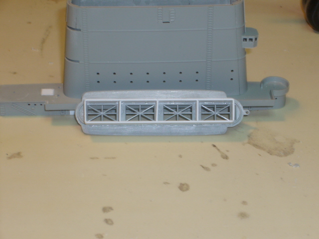

This is what I have done to the stack.
The base level I removed the curved walls and everything on the rear deck.

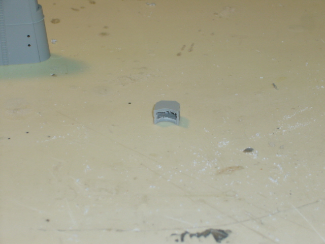

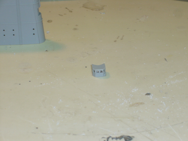

The radar room is way off. Chris shortened and narrowed his but in the pics I saw it did seem shorter but not narrower so I just shortened it. Glued it up and let it sit overnight. The cut the curve off the back and recurved it to fit. Haven't yet filled the windows.
I was browsing photos and found some of the reason for the discrepancy. It seems earlier on the Lex did have a big room with lots of windows on the funnel. But sometime between "38 and Oct. "41 that changed as seen it the two bottom pics.

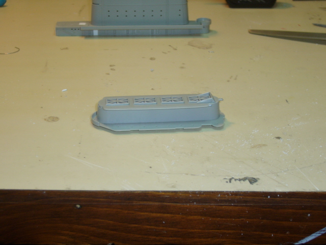

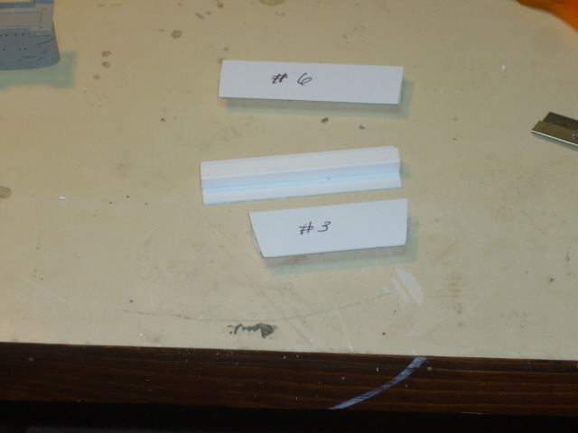

The top is next. Chris says there was a vent below the top and he detailed how he provided that by raising, cutting, and it seemed like a lot of work for nothing to me. I used a miter saw to cut down at both ends and on both sides. I ran masking tape from front to back and then used a cordless dremel to cut it out. It wasn't perfectly straight but by staying to the waste side it only needed a little filing to clean up.

I then built individual chases for each stack. This is as far as I will go with this till my PE arrives when I will add the rest.

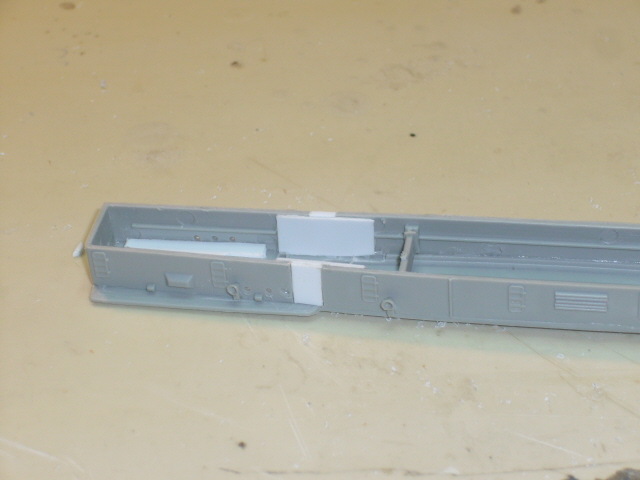

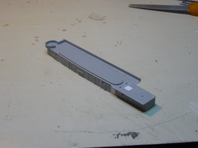

This is my solution to the upper and lower hulls not matching. I used 1MM styrene to match the supports on the upper hull. To this I attached tubular styrene for strength. Clamped them and left overnight. Then I trimmed the tubular back to the sheet and had a pretty solid brace. I installed the ones I made and will check after they set up to see if more are needed. These were what was in all the clamps on the table to end the night.
- lvsquarerigger
- Posts: 398
- Joined: Tue Feb 17, 2009 12:26 am
- Location: Albuquerque, NM

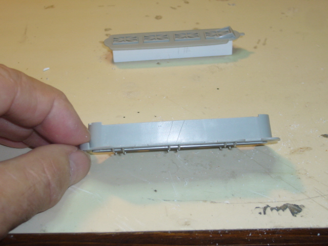

I was debating whether to attache the lower hull or the flightdeck first and both methods have been used in the builds I have looked at so far. I noticed a gap between the hulls and decided to check out which one was at fault. I think this pic clearly shows the culprit as you can see the light coming through in the middle between the upper hull and the table but this was not there with the lower hull.
Such interesting things to deal with.
