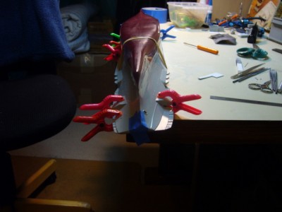

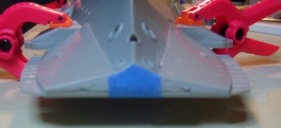

This is the part that seems to gather the most attention gaging by the hits on the pics. How to fix the deck widening sponsons so they fit. Since I had seen the problems others had and their solutions I did not glue mine on first as the directions show. Due to the problems with the upper and lower hulls waring and flexing I had to wait till they were joined and flat to dry fit the flight deck. I waited till I could dry fit the deck and view the problem from a different perspective, namely making a piece fit rather than adjusting one already glued on.
The problem seems to be the front edge of the sponson. If you fit the sponson to the front of the deck it hangs over the edge. If you fit the edge it leaves a big gap at the front.
My solution was to mark where the front edge of the sponson needed to fit at the flight deck itself. I then sanded this part to fit. Now the guides originally on the hull were holding it out so I cut and sanded them back as needed. Now they fit. It does move the edge very close to the hawse holes but still clears them so I thought this was acceptable. As you can see there is still a little sanding and filling to be done but not much at all.
For some reason my pics are in a very high state of resolution and this causes problems with the image capacity of the website. The settings on my camera do not seem to be adjustable but then again I'm not that much into that stuff so who knows? The image limit is about 150 and almost all of mine exceed this in their original state. I reduce them to 640 x480 and this works for most of them. There are still a few that exceed the 150 limit and these I had to reduce to web size or 320x240. I only have a basic photo program and this is all it allows. I wish it were different but it's the best I can do with what I have.
Enjoy
Jim

Nicely done, Jim. Excellent solution.
I was one of the folks who followed the instructions and glued the flight deck pieces to the hull, which led to the requisite "SON OF A #$@%&!" when I dry fitted the flight deck.
Tracy's solution worked quite nicely as well, fo those of us who dove right in!
