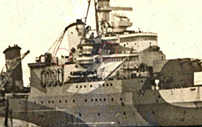

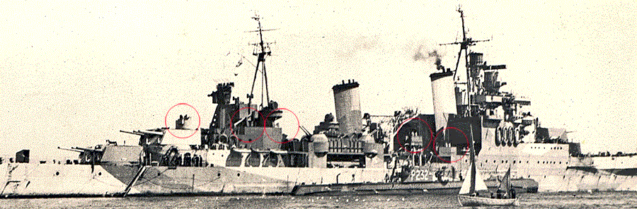

I'm trying to research HMS Sheffield's AA outfit at the end of 43 - and hope some of the experts would be kind enough to offer an opinion.
All the recognised sources quote 14 20mm single Oerlikons at that time. In all my searching, the only photo I've found which I think matches the timeframe is this one: (The submarine alongside is HMS Stonehenge, commissioned June 43, active off Sumatra early Feb 44 and lost March 44 which I think places this photo as late 43 - assuming it took a month or so for a submarine ot get from Scapa to the Eastern Fleet and into action.)
The original photo (from an eBay CD of images taken by a crew member) is ID'd as Sheffield, and looking at the bow knuckle and stern HACS, I think it can only be Sheffield or Glasgow. So I'm going with the ID. On the original I can see a total of 9 20 mm mounts - circled - plus from other shots I can ID another 4: My questions are,
Where is 20mm mount 14? - since there is only one mount missing, I'd expect it to be on the centreline. The only other images I've seen of Sheffield, supposedly in this timeframe are in the Battle of North Cape section of the "Royal Navy at War - War In The Frozen North" DVD in which it appears the director position between the bridge and B Turret may have an Oerlikon mounted.
Secondly, the images above seem to show a differetn pattern for the camouflage to that shown in Alan Raven's camouflage books with the two darker colours being reversed, can anyone suggest whether this is an effect of the film or that the design did actually change.
Any help would be much appreciated.
Andrew
Andrew

Dear Andrew,
Have you checked the following 3 key references:
British Cruisers of WWII by Raven & Roberts
Ensign 5 Town Class Cruisers by Raven & Roberts
HMS Sheffield by Roland Bassett?
The 2nd states for Sheffield:
Sept 1941 6 x Single 20mm added
Machine guns removed
July 1942 3 x Single 20mm added
June 1943 5 x Single 20mm added
Thus giving you your 14 total, but sadly it doesn't state the positions.
If you haven't checked the other sources I can do for you tomorrow?
I just had a very quick look in my warship photograph database for Sheffield, but I seem to have mainly pre-war, 1940-1942, and 1944-postwar photos of her instead of the late-1943 ones you need.
Hopefully Alan will let you know the 20mm locations.
Regards
LB

Hi Laurence,
I've checked all of those, plus a few others, but as you say there doesn't seem to be anything much between 42 and 44. I know you've done more than a little reasearch from the primary sources, can you give me any pointers to the docs that might hold the answers?
ta,
A
ta,
A
ar
Re: Calling all HMS Southampton/Edinburgh (aka Town) class fans
I believe that the two photos were taken at different dates in 1943. The first one appears to have been taken around mid year and the second somwhat earlier in the same year.. The camouflage had definately changed somewhat by July 43. Believe that the 14th 20mm may have been fitted on roof of 'A' turret. The item on the bridge face is the barrage director fitted with type 283 radar.
andrewa wrote:Hi Laurence,
ta,
A

Thanks Alan,
You are correct, the two photos were taken at different times - the mounts on the flight/catapult deck are not present in the second photo.
Here is a close up of the bridge A& B turret, its a bad angle, but could that be something on B?
I think it is too promenent to be the barrage director and too high to be the paravanes stored on the bulkhead.
thanks,
A
thanks,
A

You are looking a periscope fitted to 'B' turret. Visible in both photos.

Laurence,
Thanks very much for the very comprehensive answer, looks like I'll be taking a trip to Lambeth - also thanks for saving me a (probably) wasted trip to Portsmouth which had been my plan.
Alan,
Thanks for the answer, I can see that periscope now. Do you have a source or eveidence for the fitting on A Turret? I'm planning to visit the IWM, anything to focus my search would obviously be a big help.
thanks again,
Andrew
Alan,
thanks again,
Andrew
ar
I found the July 43 photo which shows the 20mm on roof of 'B' turret.
When/if you go looking for photos at the IWM, be aware that the staff are morons, in that they no nothing about ships.
Look for photos that show disruptive camouflage and TWO yards on the mainmast. The lower yard was fitted during the febuary/june 43 weather damage repairs, to carry type 91 or type 1V radar intercept and jamming aerials. See your first photo for reference.

THanks again, I see what you mean by the second Yard.
I'll let you know how I get on.
Andrew
