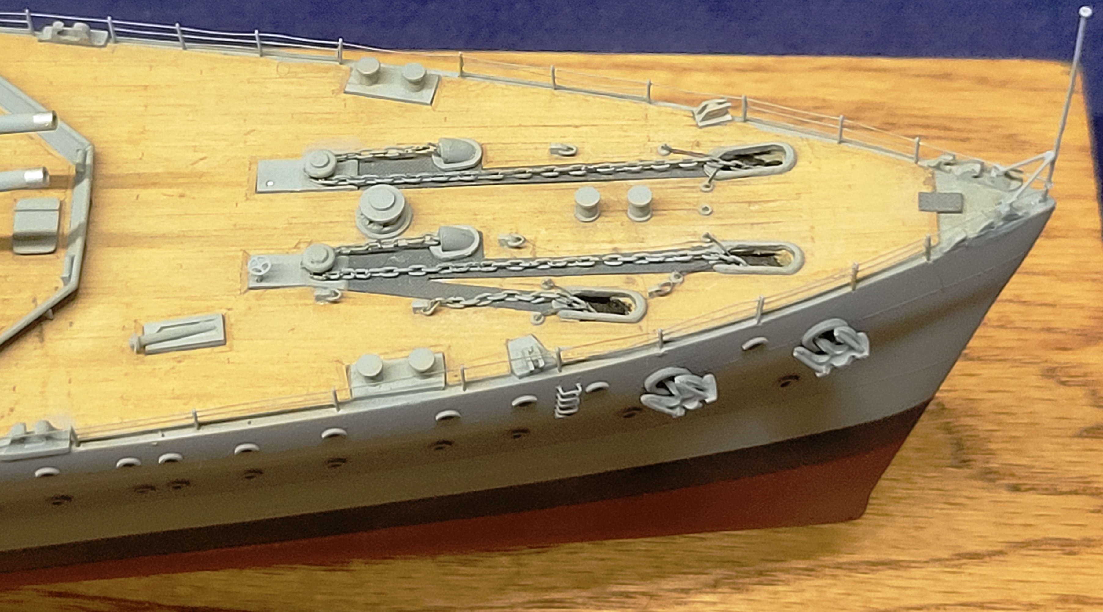

Steve Sobieralski wrote: The main porthole issue was the rigols, the semicircular rain gutters above each one that is exposed to
Those are called "eyebrows over the portholes"

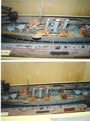

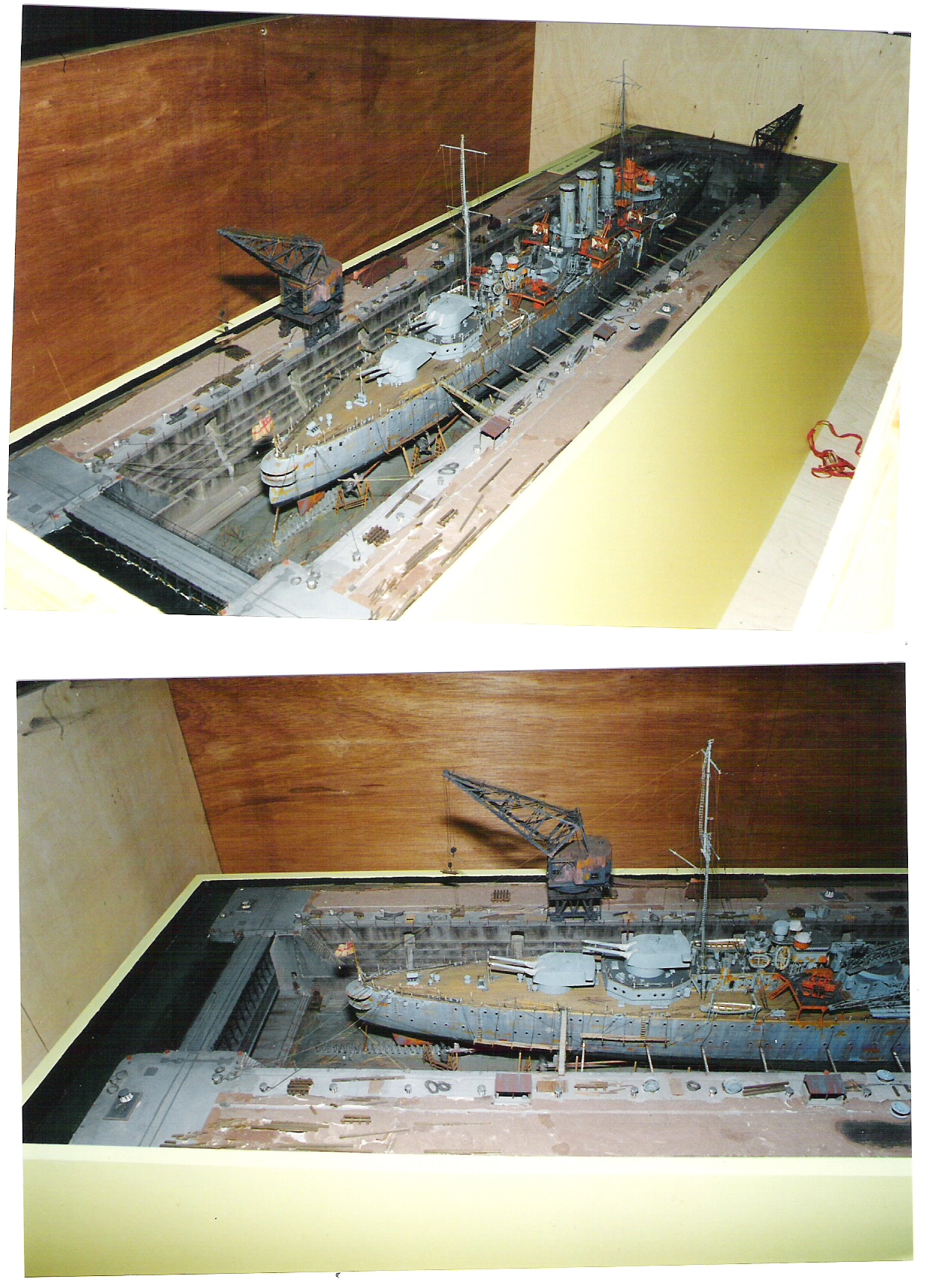

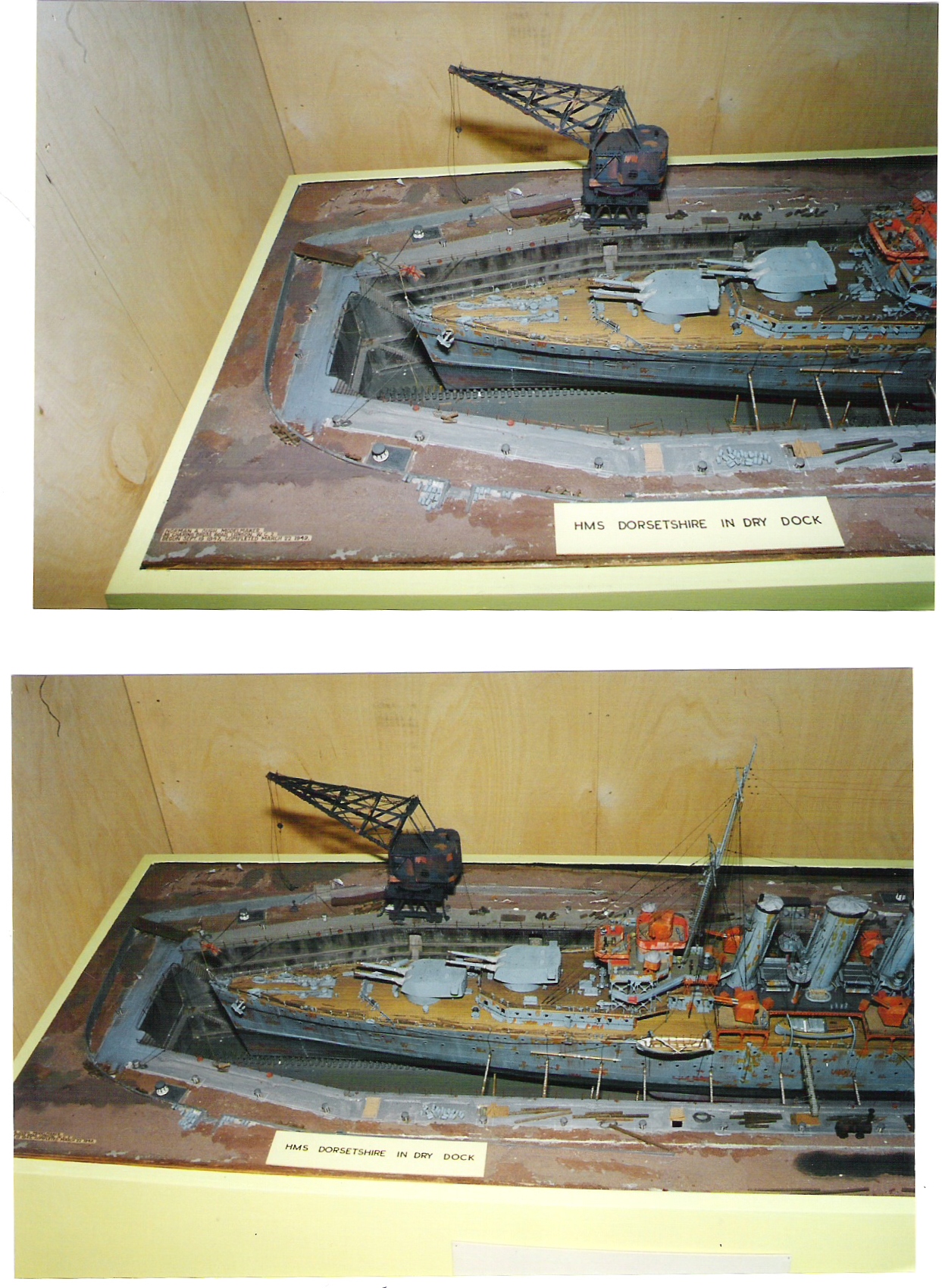

Post by Steve Sobieralski »

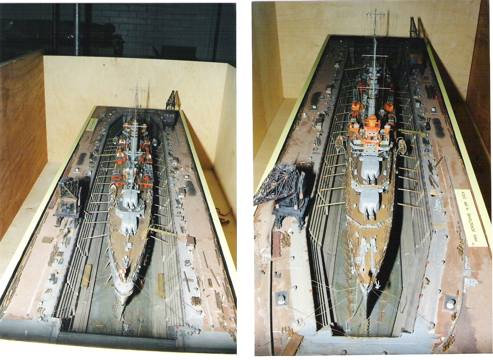

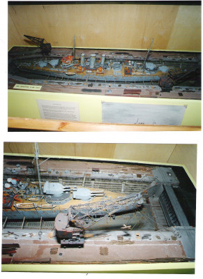

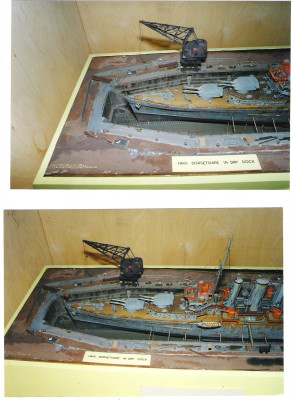

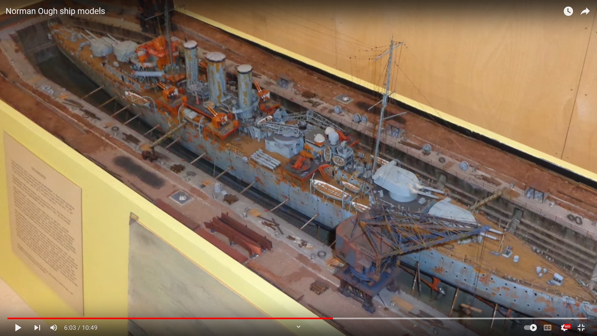

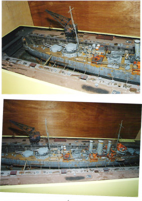

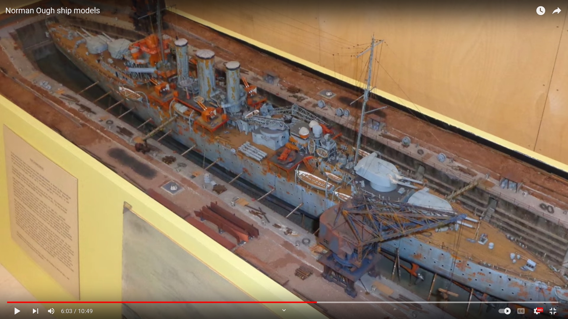

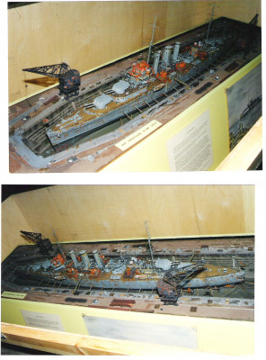

Back in 2005 I started this thread as an in-progress build log of my 1/192 scale (mostly) scratchbuilt model of HMS Dorsetshire. I contributed to the thread pretty consistently until mid-2008 when several factors (collectively known as “life”) slowed my, ‘til then, fairly steady progress on the model. Over the ensuing years I did make slow (sometimes very slow), but erratic, progress on the project until this year, 20 years later, I finally declared her finished. At some point most of the photos I had posted illustrating the build disappeared, so as part of the process of finishing the build, I have been going back and restoring the photos that I still have. One of the last posts made before the thread died was made by Mike E, who posted photos he had obtained from the Imperial War Museum of the justly famous Norman Ough model of Dorsetshire in drydock during her 1936 refit. Mike had sent me copies of the photos and I recently contacted him and obtained his permission to repost them in the thread. Here they are so County Class fans please enjoy!
I will be posting photos of my completed Dorsetshire model soon.

Post by Chris G »
A remarkable saga of your build thanks for sharing and for updating. those pics of the model in the dock are unique in my experience, an unusual idea!
they were lovely ships...i got to know them years ago when planning a detailed naval wargaming campaign of the search for the Graf Spee and there were county class cruisers involved. The Royal Navy sent me plans and a lot of help wow that was in 1973 or so. Never did manage to pull of the campaign. But i still have 1200 scale County class cruisers in my collection of waterline models . they survived all of these years.
Look forward to seeing the finished photos of your build thanks for returning to your thread and working to update it.

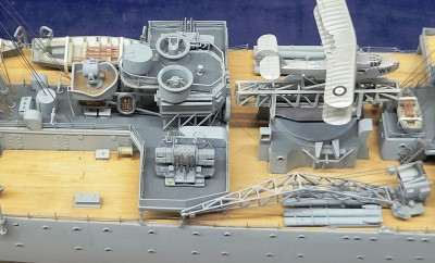

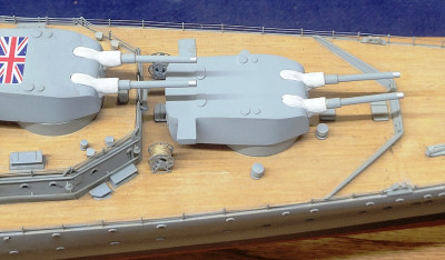

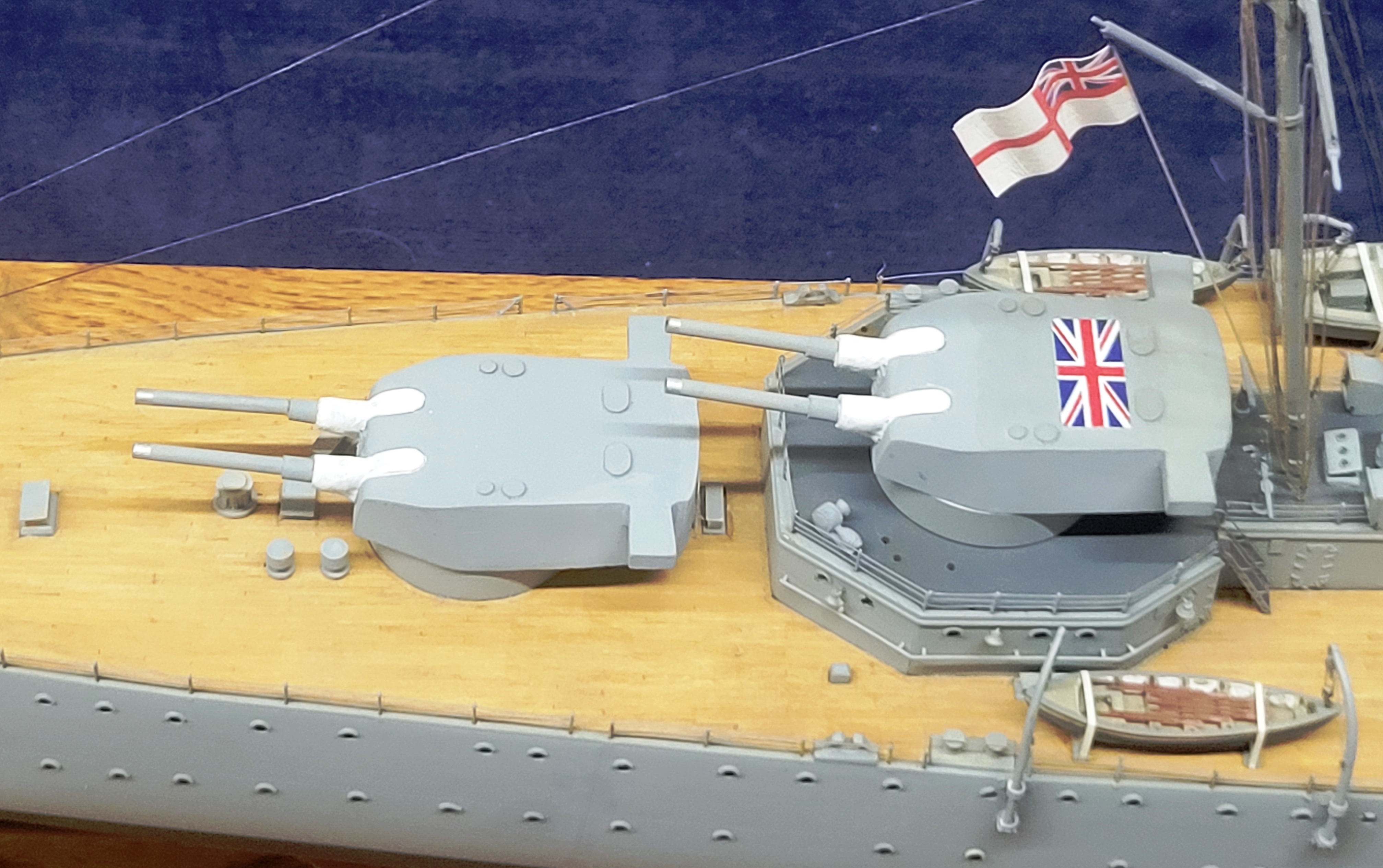

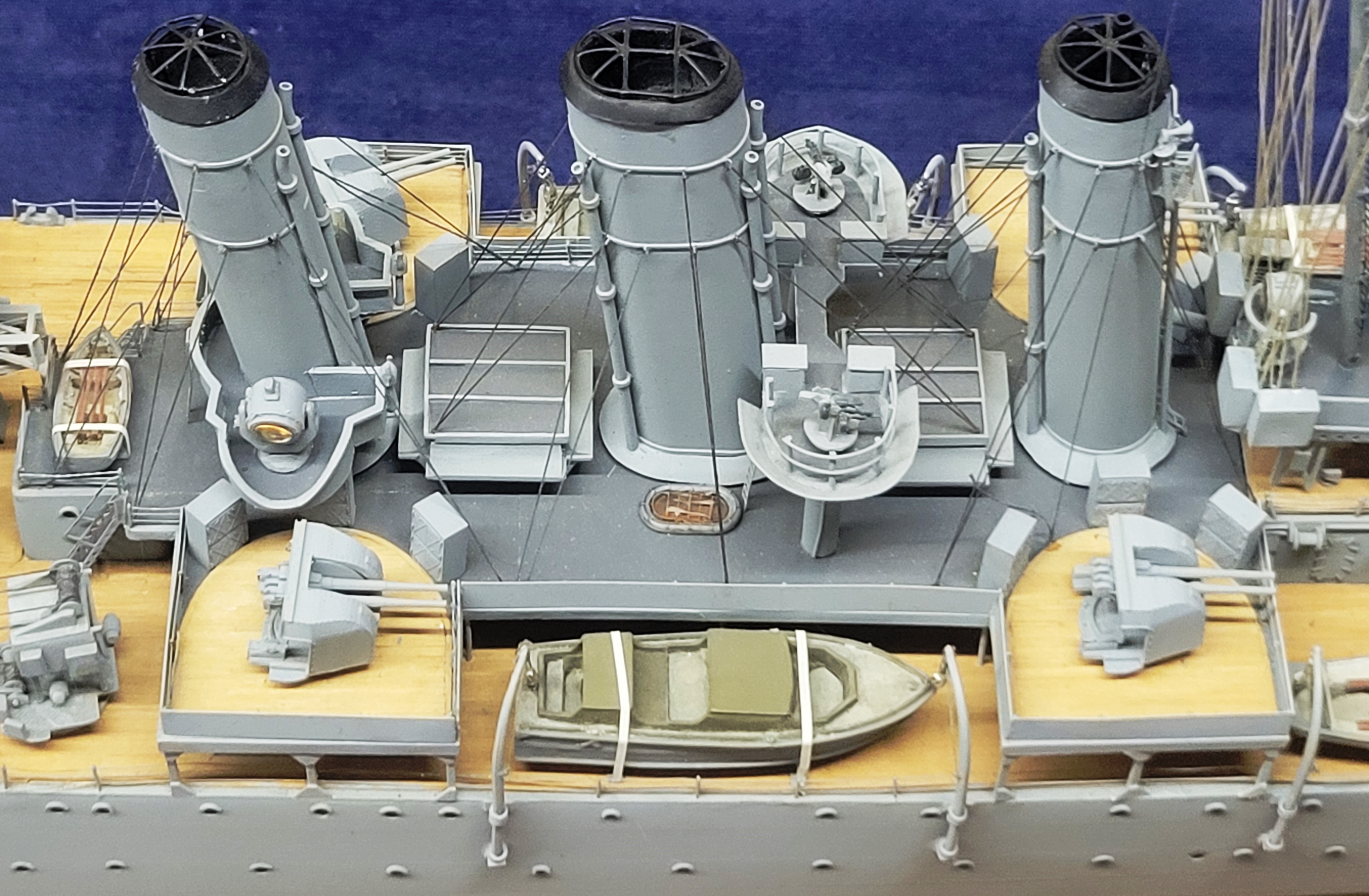

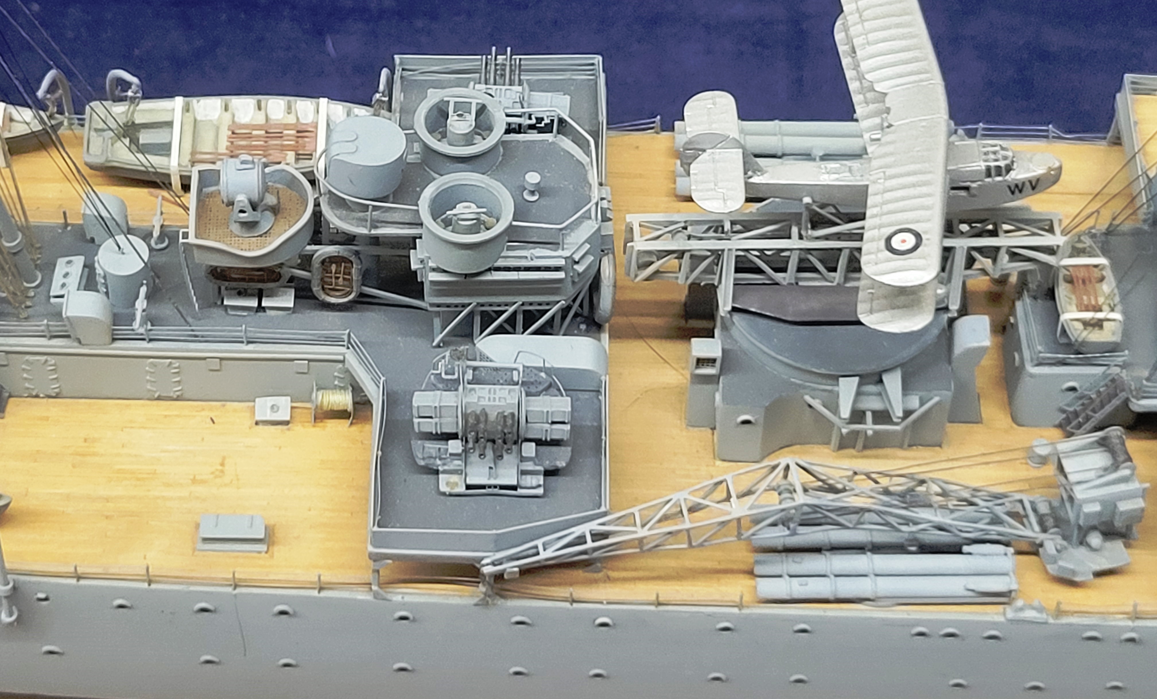

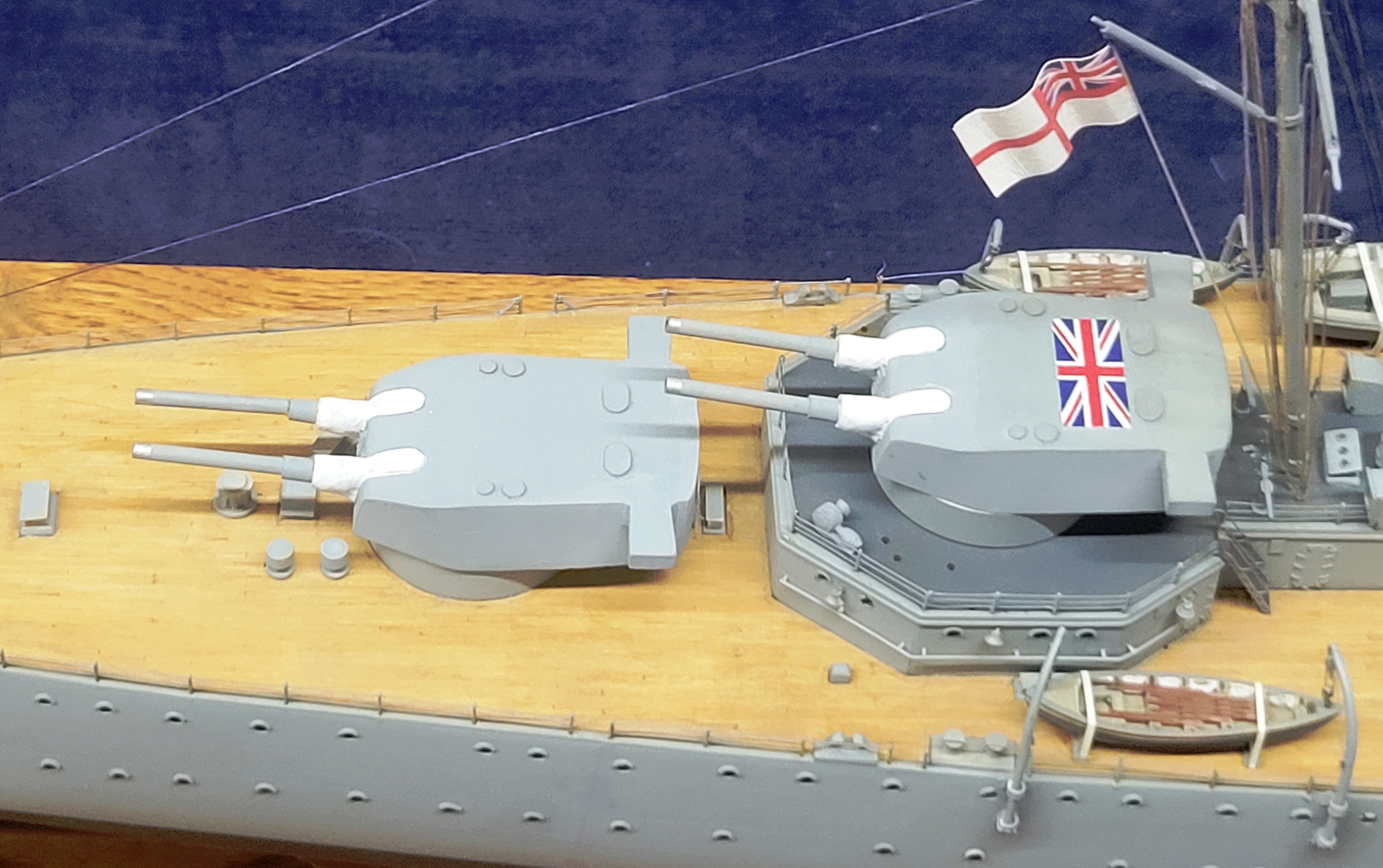

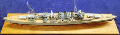

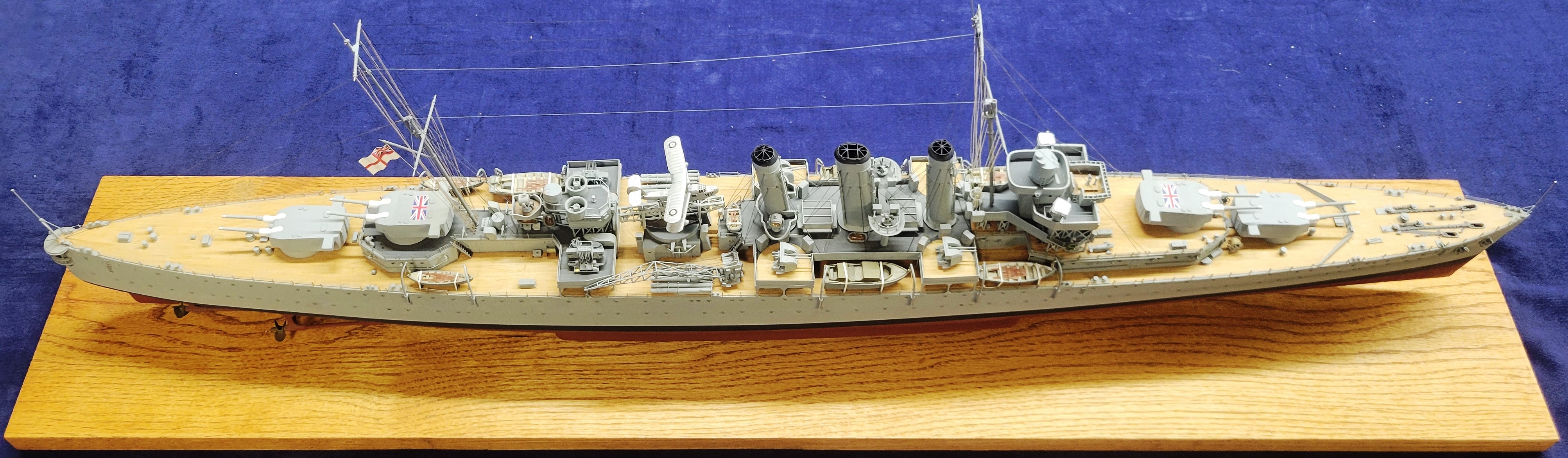

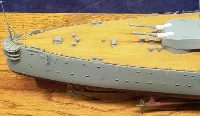

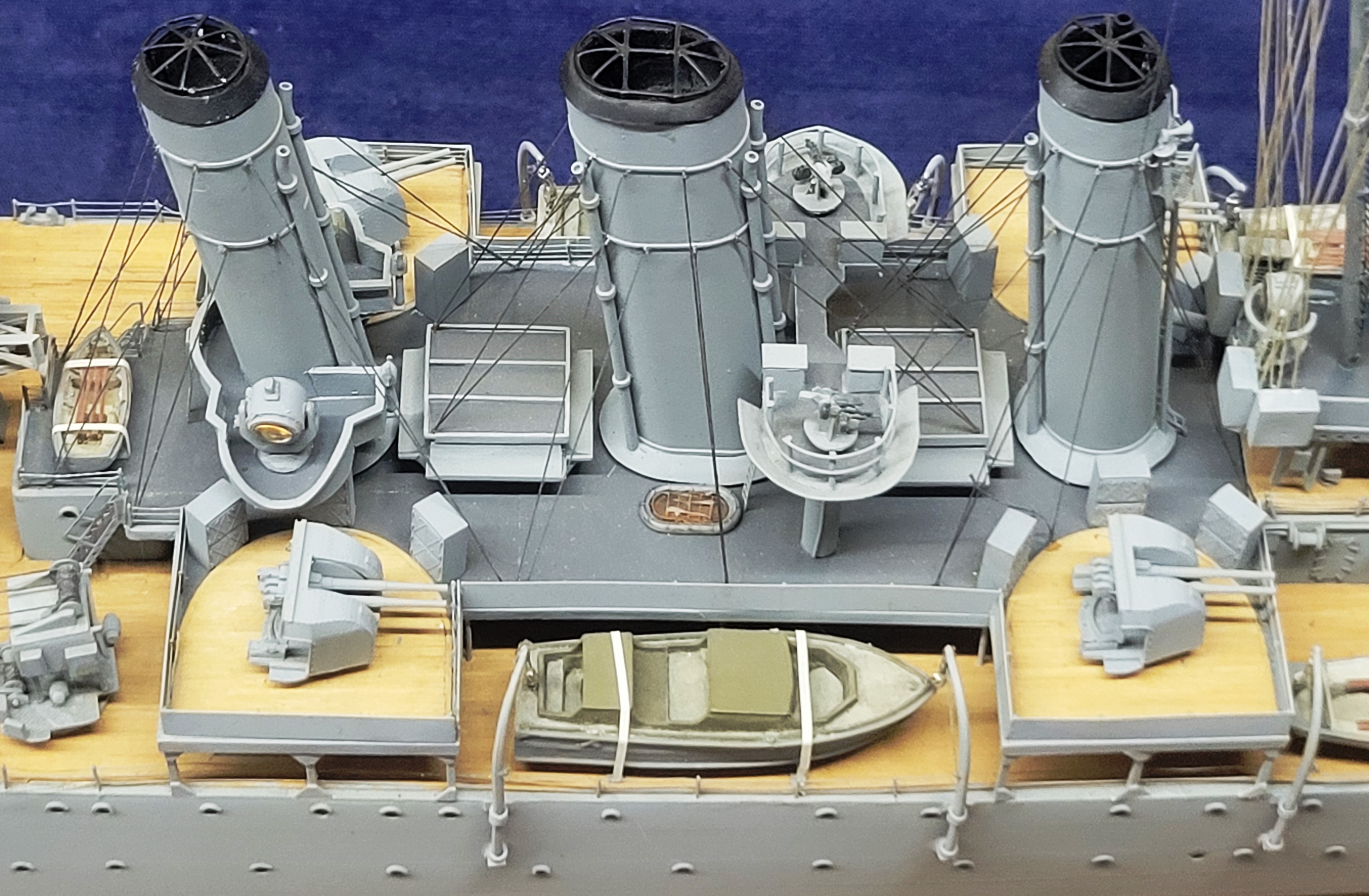

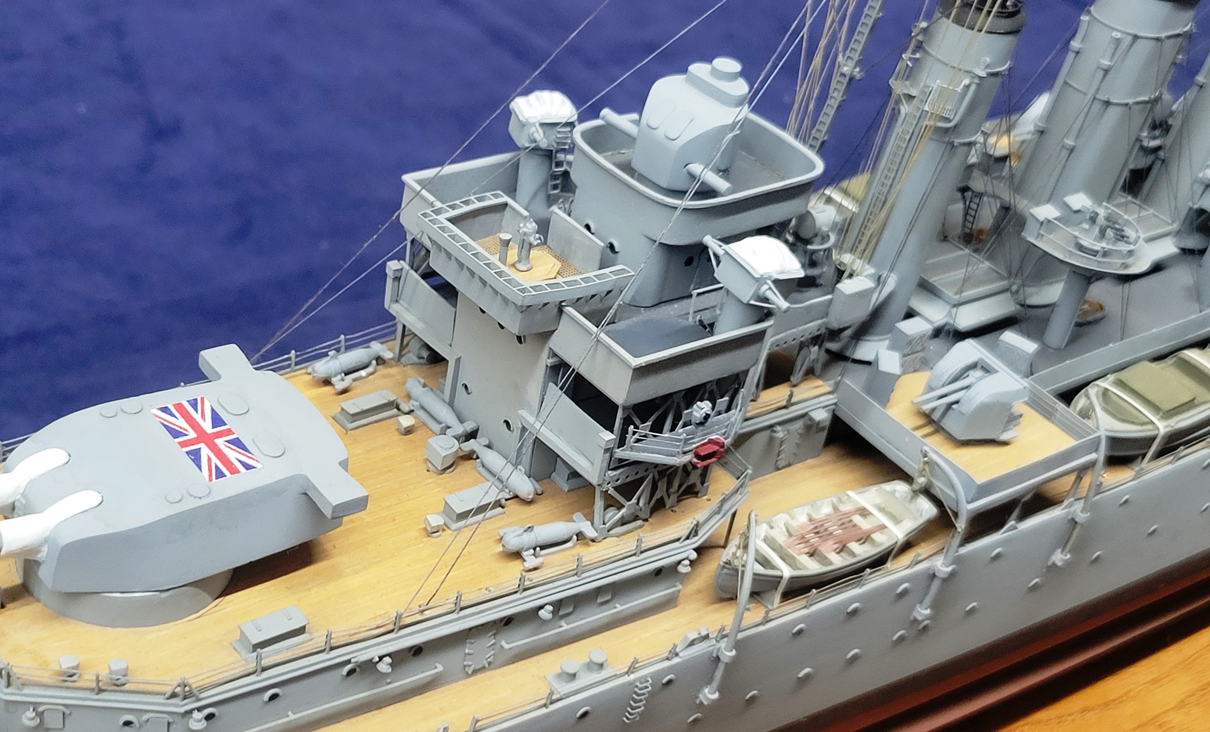

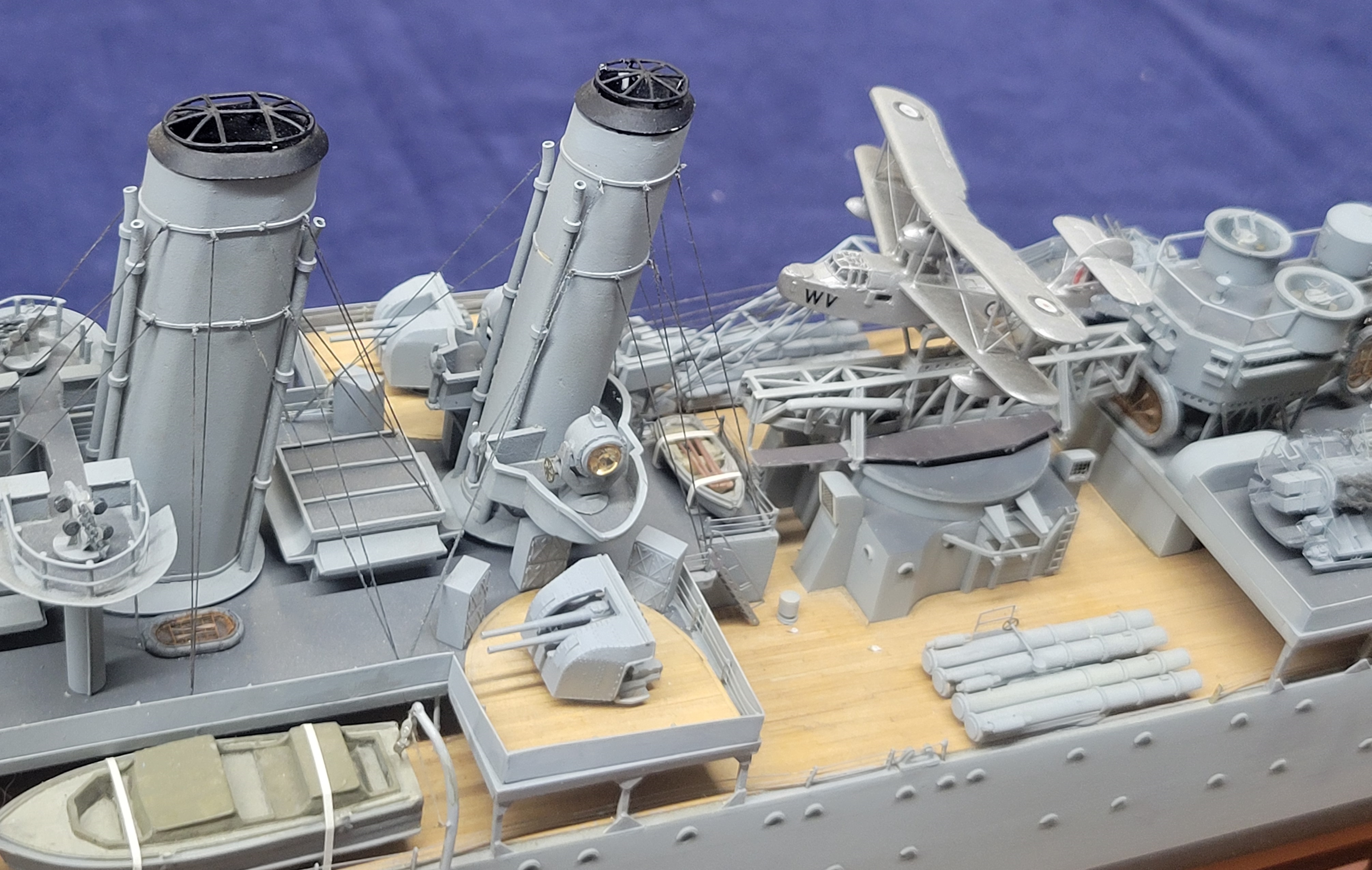

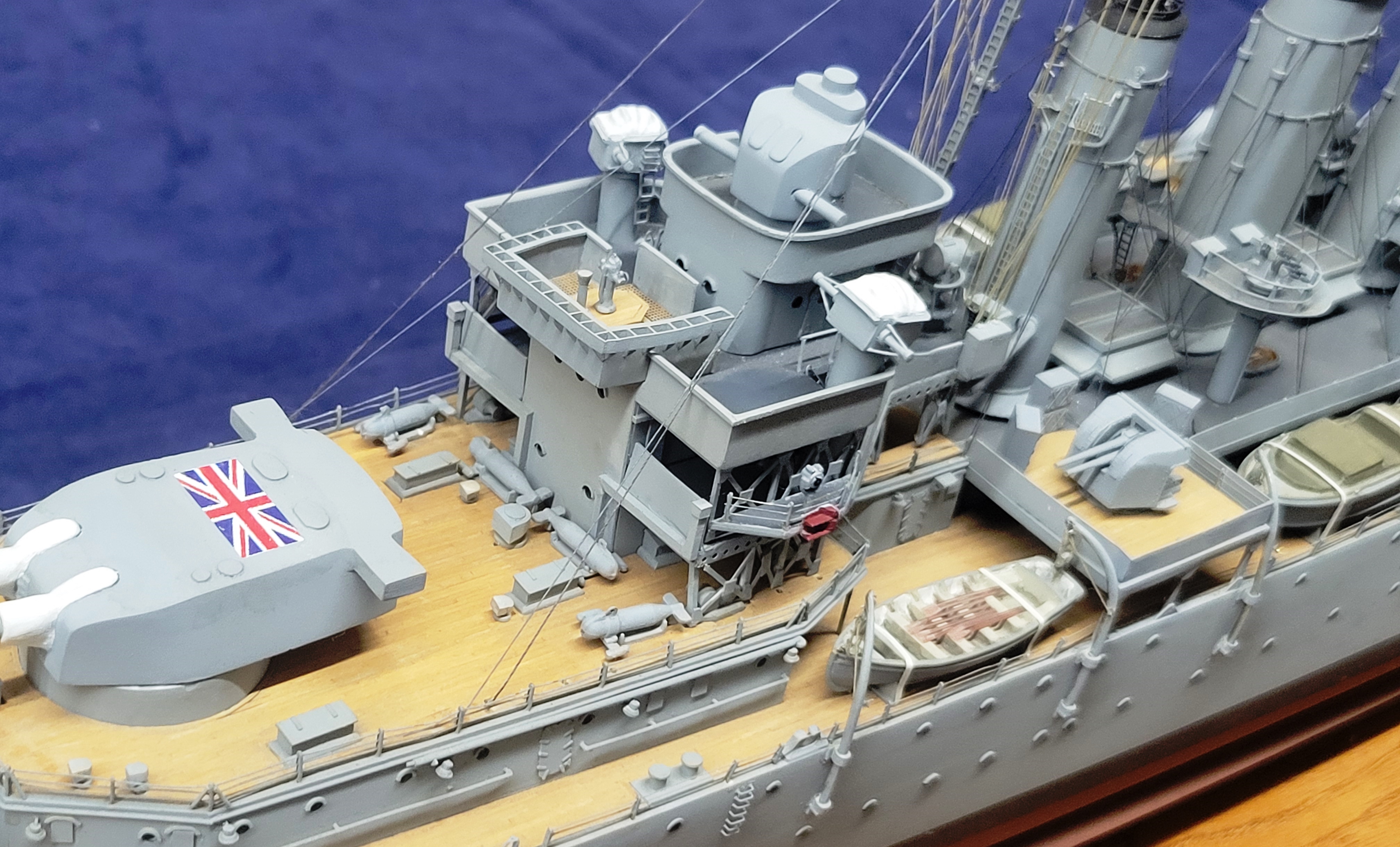

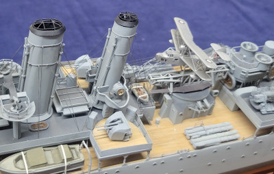

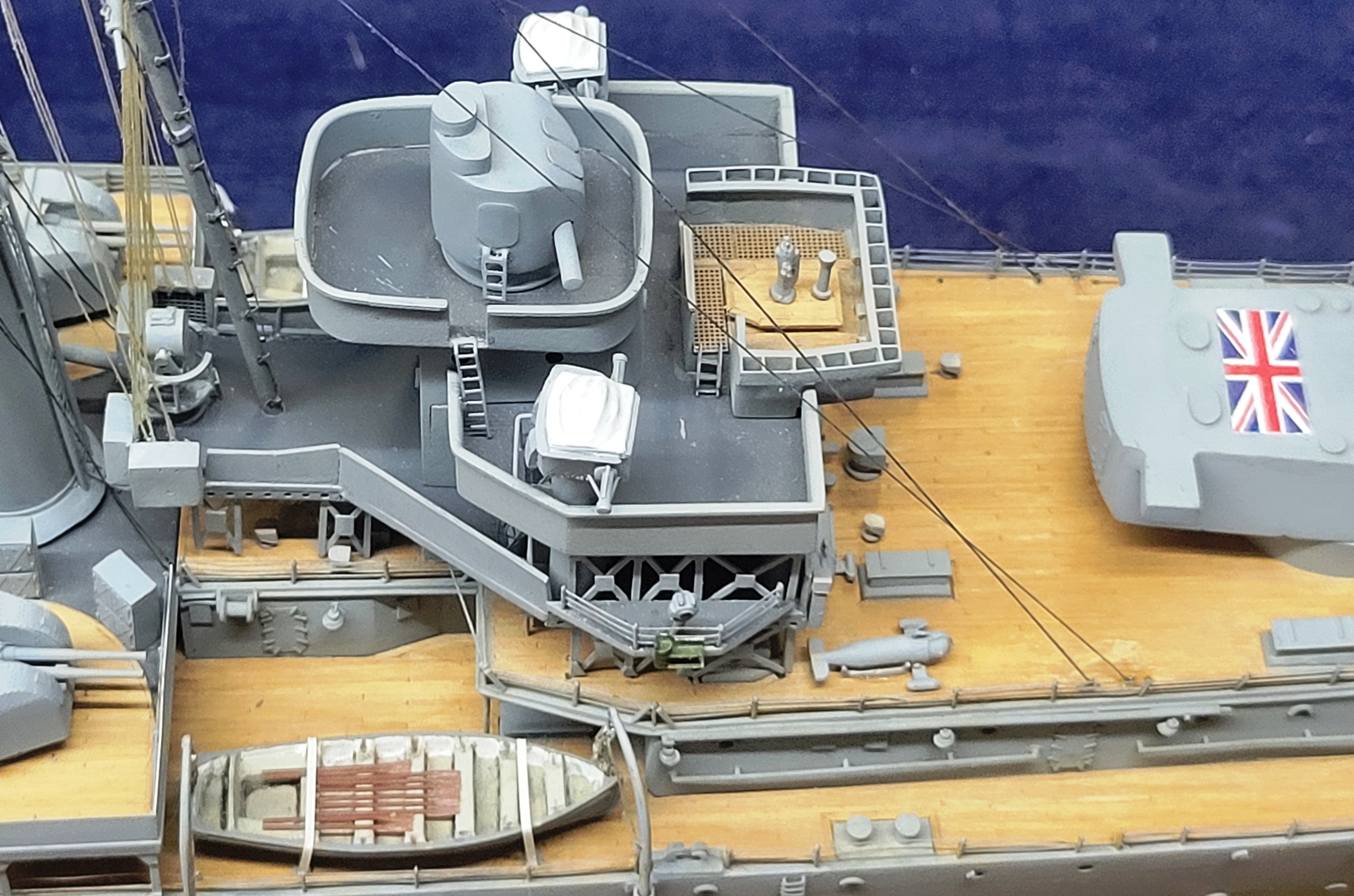

This is my model of HMS Dorsetshire, finally completed 20 years after I started her construction. To briefly describe her, she is built at 1/192 scale or 16”=1ft, the starting point was a fiberglass hull, which I purchased from an English shop called Midway Models. In addition to the hull, Midway Models provided vacuformed funnels and turrets and a potpourri of miscellaneous fittings from a variety of sources, none of which were used on the model. Also included was a set of plans by Norman Ough.
Decks and superstructures were fashioned from sheet plastic, a master gun turret was made and four resin copies were cast. Fittings were purchased when available or scratch built when not. Ship’s boats and a few other items were purchased from John Haynes, back when they were obtainable. The wood decks were individual 1/32”x1/32”x1” bass wood planks laid in the proper pattern. For those interested, many of the steps in the construction are documented in the preceding pages of this thread.
Prior to 1939 Dorsetshire spent most of her career on the China Station. The ship is shown as she appeared on a goodwill visit to Sydney Australia in 1938, with union jacks painted on the tops of B and X turrets for aerial recognition. I assume this was in response to the Japanese attack the year before in China on the gunboat USS Panay.

Post by Chris G »
Thanks for the pictures Steve. Amazing work...truly a fine representation of that ship. I know the class well from years ago in the Naval Wargaming Society in London we gamed the Graf Spee events, and there were County class Cruisers bearing just the same Walrus Planes as you show. At first i used to think the high sides of the ships was a detraction but over time understood the reasoning for that as they operated often in the North Sea and high sides were an excellent help for such stormy seas.
Your attention to detail and achievement of it is sterling in quality thank you so much for sharing the development, I have read thru many pages of it and plan to go back to the start and follow to the completion now. thanks

Post by iangazeley »
What a fantastic model and reassuring back story for those of us with stalled builds going back years. One small point, the Supermarine Walrus would not of carried a fin flash in 1938 (introduced in May 1940).
