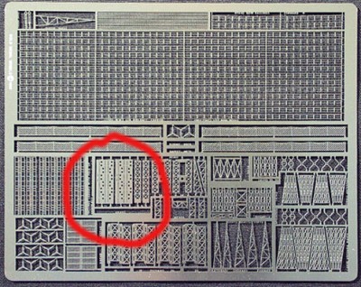

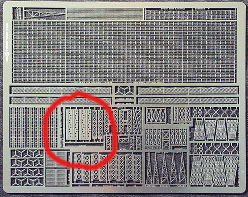

- Posts: 9071
Re: Calling all IJN Akagi and Kaga fans
Off the top of my head, without actually looking at a fret: if you have one of the GMM or Tom's PE sets for CA/CL or CVs, or auxiliarys, there might be a a couple of latticed crane booms that are wide/high enough to use with a little trimming. Not perfect but....
Or perhaps one of the dedicated crane sets from another PE mfg.

- Posts: 9071
These should work (PE fret photo courtesy of the Gold Metal Models website). I have extras.........
