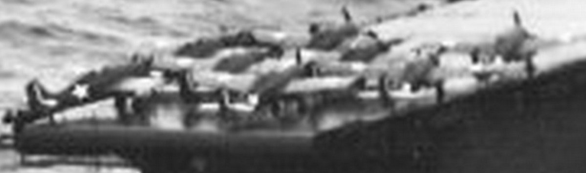

does anyone have any more detailed info about USS Nassau at the time of Attu invasion in 1943?
Specifically, I would need
- info on her AA guns configuration (preferably a drawing)
- info on her aircraft complement and units - so far I know about VMF-155 with F4Fs and VO-155 with SBDs. Dis she carry also Avengers at that time? What number of a/c per type?
- although info on her camouflage in 1943 is missing at http://www.shipcamouflage.com/usn_cve.htm I believe she carried Ms 21 like most other ships in that timeframe
Thanks!

Vladi wrote:- info on her AA guns configuration (preferably a drawing)
Have you looked over her Navsource page?[?URL] They have some Attu pictures there. Looks like a fairly standard setup - I would compare the photos to [URL=http://hnsa.org/doc/plans/acv6.pdf]this reference plan (page 13).
She's not really included in the aircraft summaries for the time, but "[URL=http://www.amazon.com/Low-Ceiling-World-Pilots-Diary/dp/0533142822]Low Ceiling
" by R. L. (Dix) Loesch has this in the preface (page viii):
On board the Nassau, there was one squadron of 24 pilots with 26 F4F Wildcat airplanes; three Marine pilots and three photographic F4Fs, and a SOC-3a aircraft.
Vladi wrote:- although info on her camouflage in 1943 is missing at http://www.shipcamouflage.com/usn_cve.htm I believe she carried Ms 21 like most other ships in that timeframe
Most likely - Measure 14 is a possibility, but I haven't found anything yet that says either way.

Dear Tracy, thanks a lot for your reply!
Have you looked over her Navsource page?[?URL] They have some Attu pictures there. Looks like a fairly standard setup - I would compare the photos to http://hnsa.org/doc/plans/acv6.pdf this reference plan (page 13).
Yes I saw the Navsource - and thanks for pointing me to the plan! There was most probably no time to make any modifications to her before Attu so we can assume she was as-built (and that they builders adhered to the plan of the class).

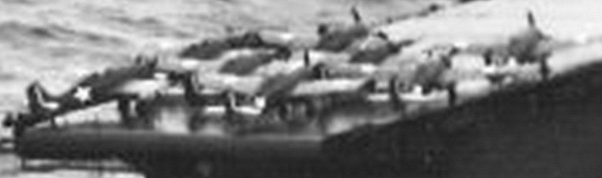

This is really interesting. Unfortunately the Navsource photos are taken from a distance and the resolution is quite low. Do you think that the a/c on http://www.navsource.org/archives/03/0301602.jpg (enlarged below) are all Wildcats? Theyx may be, but some on the right look to me like having wider undercarriage than F4F, but the photo is very blurred to be sure. The most forward one in the centre may even have rounded wing tips (SBD?) but it may have just been obscured by something/someone...
(Ms 21) Most likely - Measure 14 is a possibility, but I haven't found anything yet that says either way.
Exactly. Thanks!

I'm pretty sure those are all Wildcats. Not 100% sure, but pretty sure.

Thanks, Tracy! After staring into it for more I tend to agree. Especially as I cannot see larger cabins of any other types.
