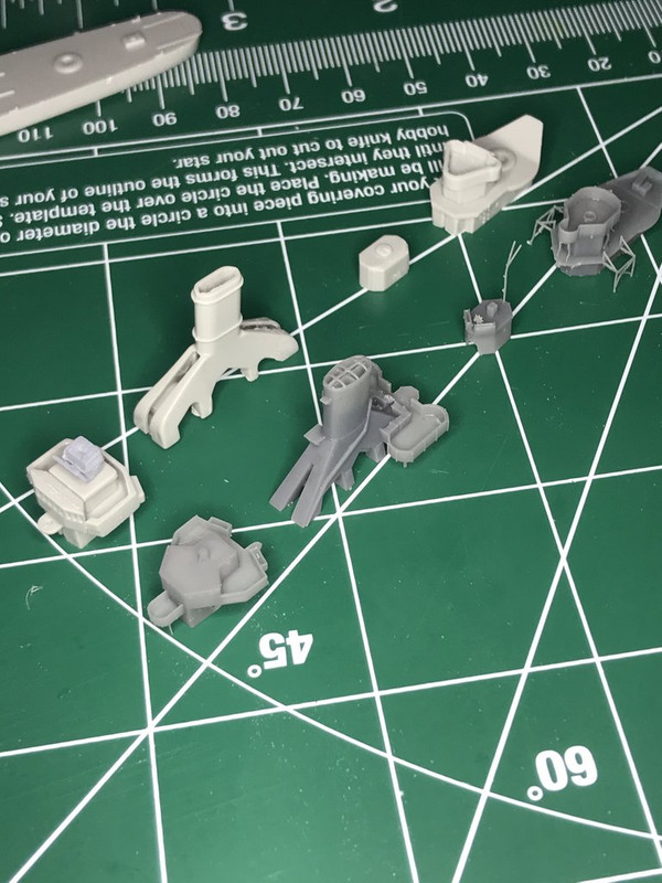

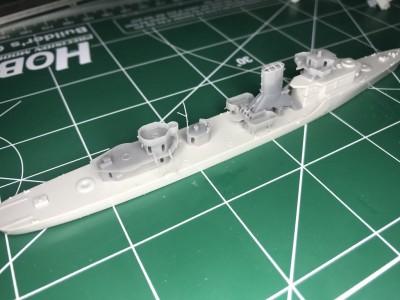

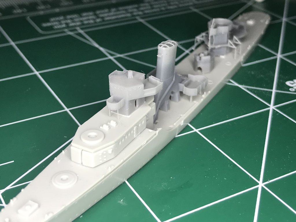

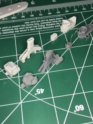

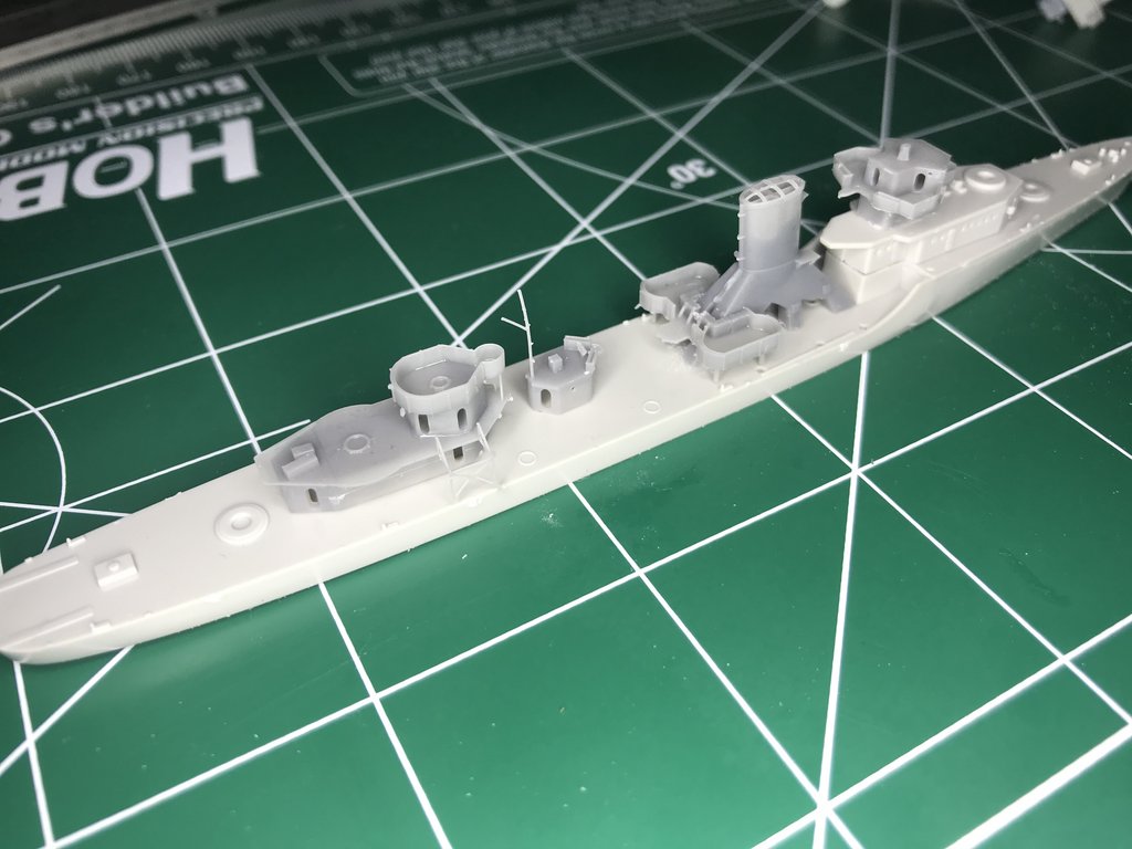

So what do you do when you have a bunch of Midship Gridley, Bagley and Benham kits? Build the as is? Or..... Do you do something radical and you improve them? Well I have been working with a company that's on the verge of releasing some 3D printed ship accessories.
Here you see an early test fit, mind you there is still much to be done and adjustments to make but wanted to see if he experts here felt we are on the right track? The Bridge is a little small and subsequently will be adjusted
This is a Bagley in 1944, a 1942 version is in the works as well.

Much of what is shown is needed improvement, but be careful on the bridge. While the kit doesn't angle the side faces back enough, your printed replacement angles them back too far. Check this overhead shot of Mugford: http://www.navsource.org/archives/05/pix1/0538904.jpg
Also, the 20MM galleries on the stack are very late war. Are the galleries attached to the stack or are they separate pieces? My preference is to do several ships at different times to depict the progression of the mods. It is easier to do if the stack is a stand-alone piece.

Dick J wrote:Also, the 20MM galleries on the stack are very late war. Are the galleries attached to the stack or are they separate pieces? My preference is to do several ships at different times to depict the progression of the mods. It is easier to do if the stack is a stand-alone piece.
Dick,
In the photo they are attached, the design we are currently working on will have the stack separate from the tubs. Should have more to show soon :big_grin:

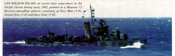

There�s a color photo, id�ed as Wilson (starboard side - full length of the ship), I think it�s in the Squadron/Signal book on US destroyers... I took a pic of it, but I don�t know how to upload it here... maybe someone could help me with that, and/it confirm whether or not it�s Wilson?

Don Andrews wrote:There�s a color photo, id�ed as Wilson (starboard side - full length of the ship), I think it�s in the Squadron/Signal book on US destroyers... I took a pic of it, but I don�t know how to upload it here... maybe someone could help me with that, and/it confirm whether or not it�s Wilson?
Posting the photo mentioned above, Don kindly sent it to me today. Unfortunately, the resolution is not great and the hull number is obscured by the bow wave.
For sure we�ve made a great leap with the photo Matt posted and now there�s even hope for more :)

First off, I strongly suspect this is a "colorized" image (the "yellowish" color to the life raft is a strong clue). Second, the author of the Squadron "USN DESTROYERS IN WWII", had numerous ID and other errors, plus poor images, to such an extent I refused to buy any of his books after the FLETCHER CLASS and FLUSH-DECKERS books. The author never gave citations for where he got his images from, so no way to check for a better copy of the image. So I'm biased against trusting what he has for a caption.
How then, it still could be USS WILSON, but it also could be of another BENHAM class unit, in the Atlantic or the Pacific.
USS STERETT (DD-407) had a similar pattern to what is seen on USS WILSON and this destroyer. STERETT's Ms 12R(mod) pattern was applied and documented at NorNY (portside only), and I have suspected after seeing the image that Matt located, that USS WILSON may have had the same artistic pattern "style" (but not the "exact" same pattern) applied at NorNY as well. USS STERETT changed her pattern sometime AFTER returning from service with the RN Home Fleet in the USS WASP (CV-7) Task Force, and being photographed at Pearl Harbor.
For comparison sake, I have posted my new crop view of USS WILSON on 13 October 1942.
