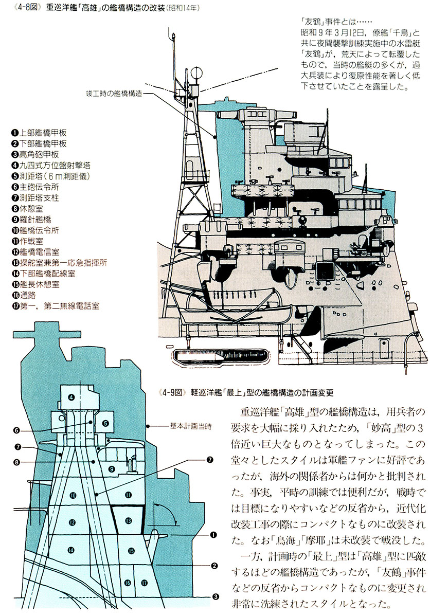

As I believe you're aware, Jose, topweight became a big concern after the 4th Fleet incidents. The Mogami class original design had a much larger bridge structure - see below.

Dan K wrote:As I believe you're aware, Jose, topweight became a big concern after the 4th Fleet incidents. The Mogami class original design had a much larger bridge structure - see below.
I remember seeing that drawing on my Mogami class Kajinsha book but given my Japanese is awful I never really understood what was being explained here. I thought it was the opposite as a matter of fact, I thought the navy wanted to make their main bridge structures bigger. I remember reading about the nasty typhoon years ago but I honestly forgot. Thanks for the history lesson though :thumbs_up_1: :thumbs_up_1: BTW, I was watching Chokai's underwater video and Petrel snatched some great shots of the single HA 45 cal guns. These guns are sitting in plain sight there is no shield housing whatsoever I found this most interesting.

Post by Dan K »
Concerns about excessive topweight. She and Maya never got the the extensive rebuild that Takao & Atago received because of timing. The escalating war situation and busy yards made it impossible to schedule the rebuilds. So, she never got the additional bulges and reduced superstructure that would have accommodated the new armament. That's also why she never received quad TT mounts and reloads.
