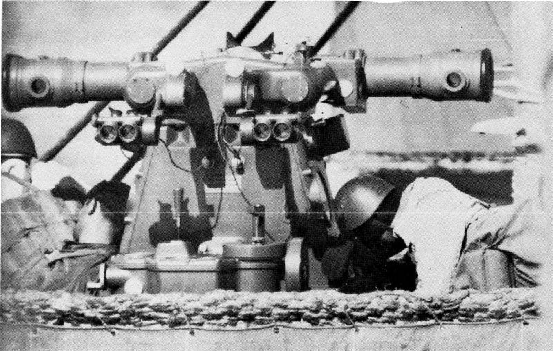

Can anyone clarify for me what each of the big directors on the Roma is for?
Specifically the 2 big coaxial directors on top of the bridge, the 2 to either side of the bridge, and the 2 to either side of the funnels.
Also, does the round pill box on top of the foremast, right under the radar, rotate? If so, does it rotate independently of the big director underneath? Also, is it a periscope sticking out the top of that pillbox?
Btw, where are the directors for the light 37 and 20mm AAs? Are they on the gallery on either side of the funnels?

To complete what I had alredy written (thanks Atma for having mentioned itchuck wrote: Also, does the round pill box on top of the foremast, right under the radar, rotate? If so, does it rotate independently of the big director underneath? Also, is it a periscope sticking out the top of that pillbox?
I don't know exactly where the AA directors were on Roma; there were six of them, three on each side, each one directing a fire group (there were three different fire groups); to find them, you have to seek for objects ressembling this

Thanks. Is there only 1 director for the main battery, or are there others?

The secondary director was on the bridge, placed between the tactical rangefinder and the admiral's bridge (upper level; the lower one was the navigation bridge); it's that kind of oval structure without windows and with another periscope on the top (this periscope was called A.P.G., standing for Apparecchio Punteria Generale, main spotting device).chuck wrote:Thanks. Is there only 1 director for the main battery, or are there others?
Just for curiosity, four combinations of fire direction were possible:
I All the turrets slaved to main fire director, using either the main fire control computer or those of turrets 2 and 3 (turret 2 and 3 each had a backup fire control computer)
II All the turrets slaved to secondary fire director, again using either the main or the backup FCC
III Turrets 1 and 2 slaved to secondary fire director, using the main FCC or the one of turret 2; turret 3 slaved to main fire director, using the turret's FCC
IV All the towers slaved to turret 2, using the turret's FCC
Then, each tower could fire indipendently as each had its own 12 m rangefinder; usually in this case turret 1, which did not have its own FCC, would be slaved to turret 2. Spotting to be done through each turret's sighting optics (turrets didn't have an A.P.G. of their own).
