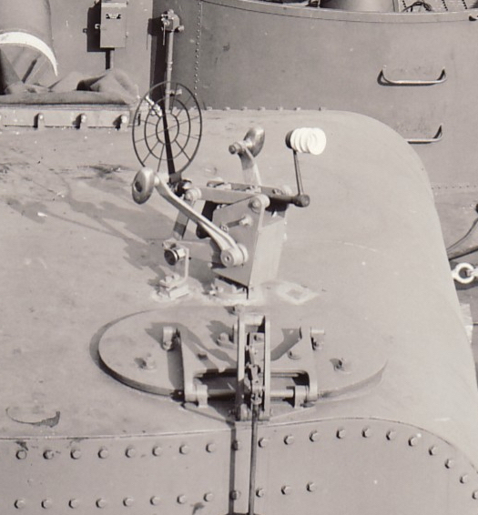

Post by Fliger747 »
As installed on twin mounts... USS Alaska

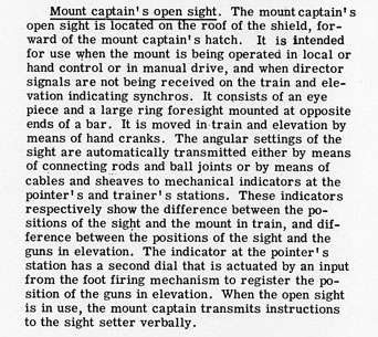

Posts: 3880
Post by Rick E Davis »

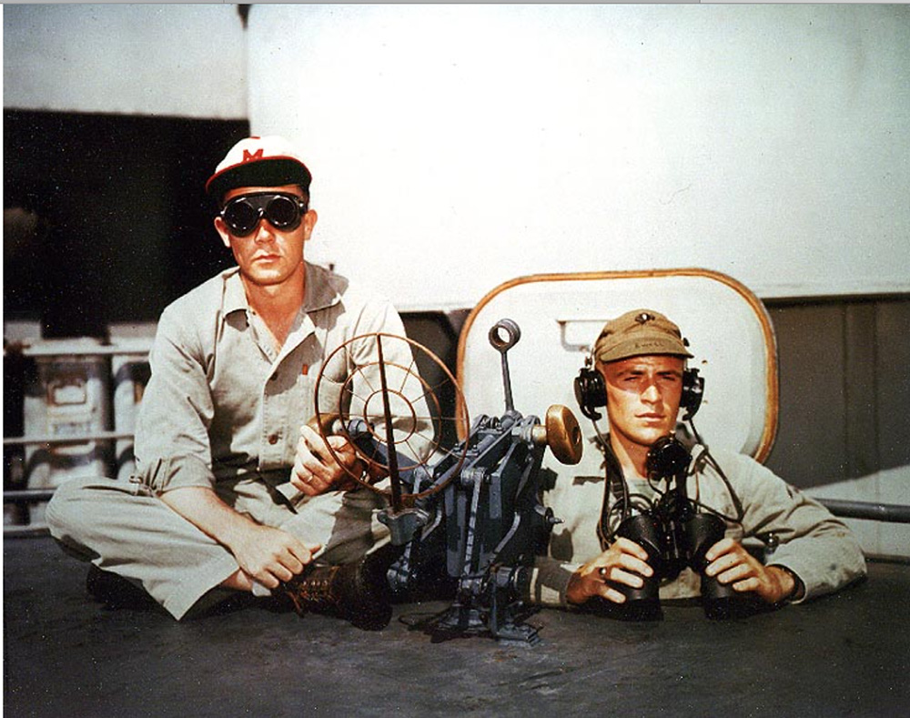

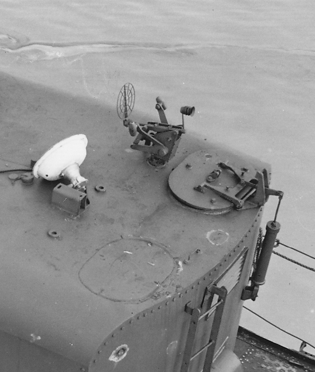

What we are looking at is a manual "open sight" for the Mount Gun Captain to use. The purpose was if all else failed the gun captain could point his weapon locally. Plus, because his head was "outside" of enclosed mounts, he had a better "situation awareness" of what was going on. It was also found to be very useful in fire support missions where the destroyer was being directed to hit a very specific target like an enemy bunker. The rangefinders and Mk 37 directors were not ideal for picking out a small specific target close-in to shore.
I actually thought that all or most of these were removed post-WWII at some point. But apparently not. Apparently they were still useful in "plinking" a target by good Gun Captain shooter.
These sights are hard to spot at times, because they fold down when not in use and/or had a canvas cover put over it. I don't know of drawings with dimensions. But here are a couple of images that pretty well shows the devices. Trying to get a good view of these with the Gun Captain Hood isn't as easy. :eyebrows:

Thanks a lot for your prompt and superb answers. These pics leave nothing to imagination, and one of them, being taken on board of DD678, is McGowan / Jorge Juan herself !!!!!!
"... These pics leave nothing to imagination, and one of them, being taken on board of DD678, is McGowan / Jorge Juan herself !!!!!!"
I thought that you would like that. I hunted for a couple of images of the open sight from different angles and USS McGOWAN happened to have a very nice view. I couldn't find a good view from head-on, but I'll keep an eye out.
This is something that is in the back of my head, which makes it dangerous, that the round "iron" sight part of this device, was the same as was used on the iron sights of 20-mm guns before and without the Mk 14 gunsight.
Posts: 5068
Post by Fliger747 »
Indeed the resemblance to the 20 MM iron sight is significant. I suppose that the salient issue here is how much of such a small item one can create accurately in 1:144.
Always things to learn!

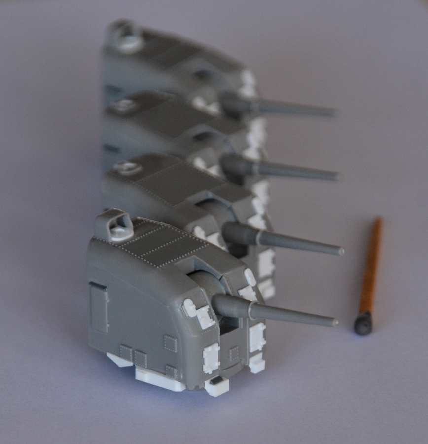

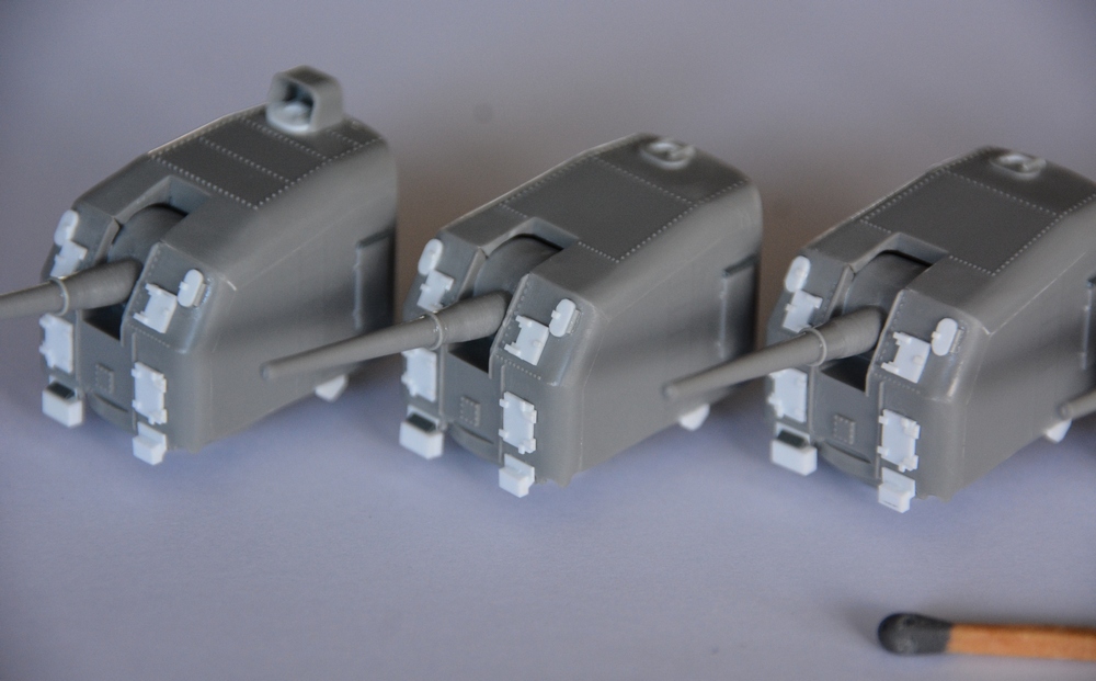

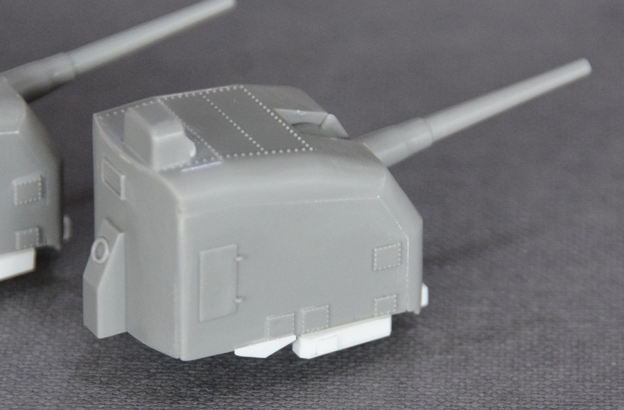

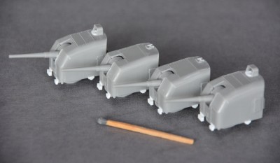

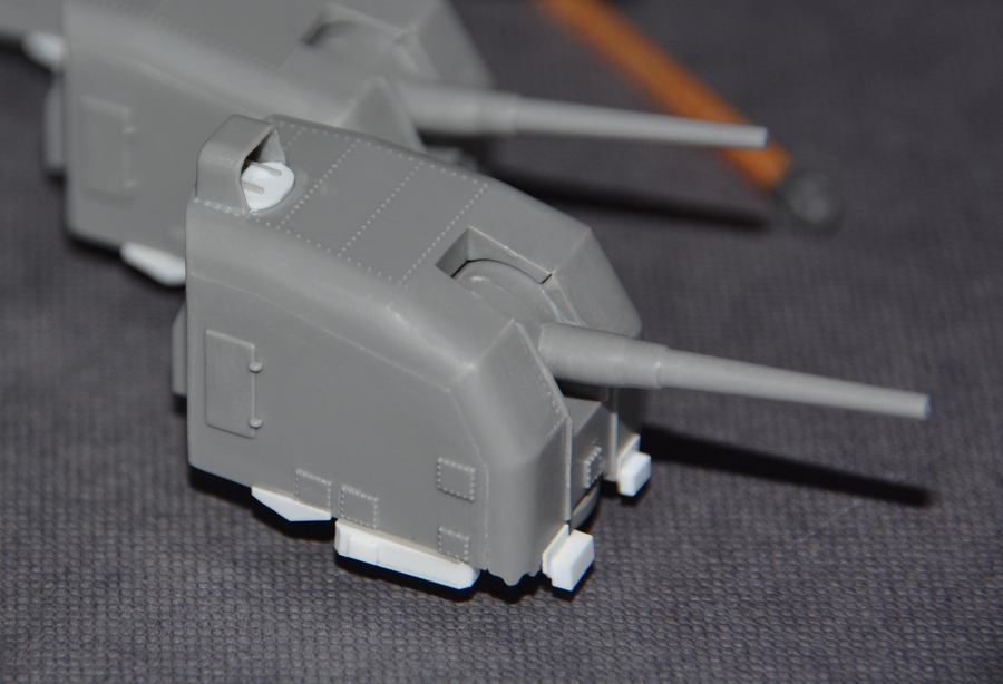

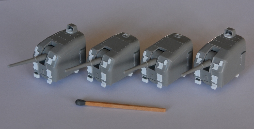

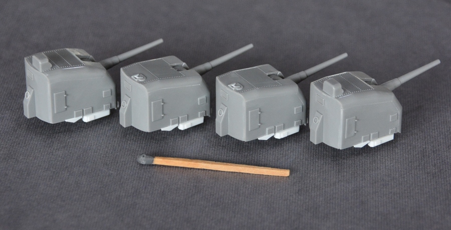

Hi again, folks.
While I think on how to make the b****y blast bags, I thought I could star detailing the many elements that will suffer no damage while handling the mounts for the construction of the said blast bags.

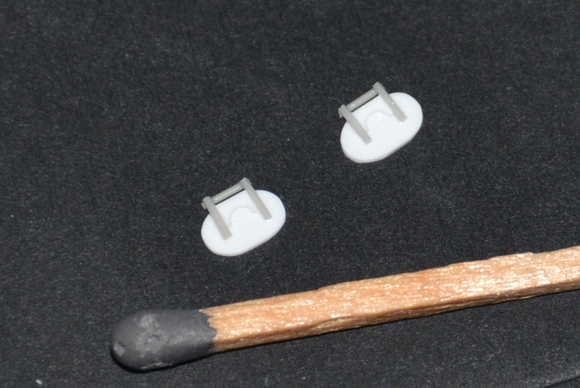

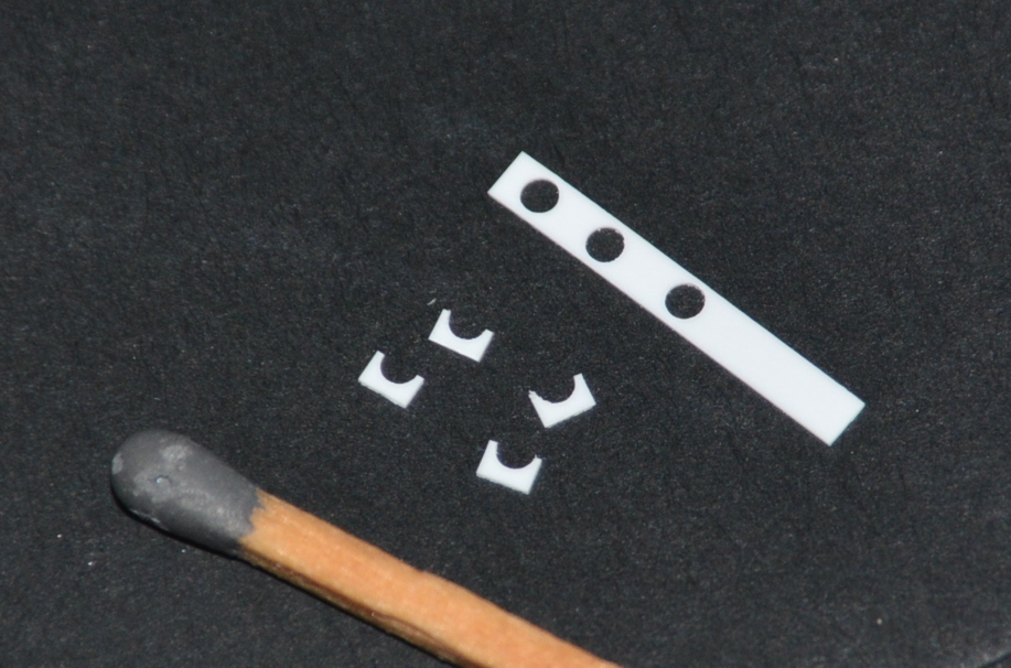

I started with the hatches on mounts 2 and 3. What you are given in the kit is correct but pretty basic, but it can be easily improved. First I made the inner elements with a scrap of plastic strip, two drills and a file.
I completed the set with some stretched sprue, and after it dried, I refined it with fine sandpaper:
Then I made the two hatches for mounts 1 and 4 that you are not given, following the same process:

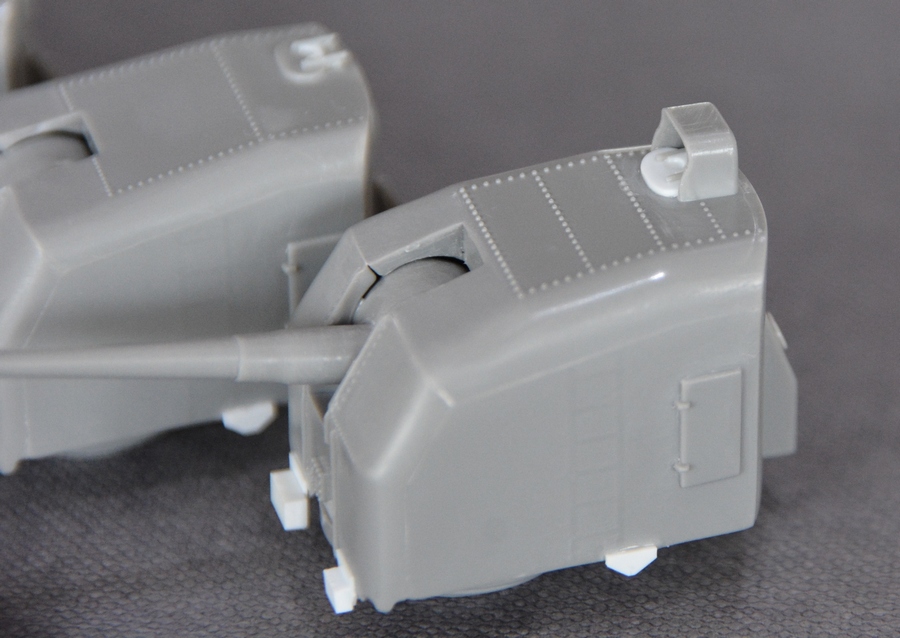

The mounts captain�s cupola is basically right, and big enough to be refined to give it the correct shape:
Once the elements are set in place, they are like this:

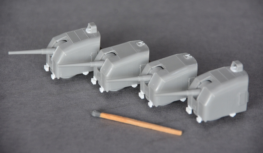

So after adding some other basic elements, the mounts are like this at the moment, waiting to dry completly and be further detailed:
The next thing will be to detail the cupola and to make some other other easy elements in the front armor, unless I can start directly with the blast bags.
In the meanwhile, the mounts are starting to get some Fletcher shape.
I hope you like them, and very best regards from Spain,
Willie.[/size]

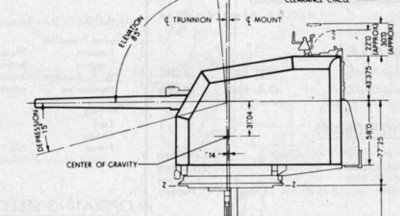

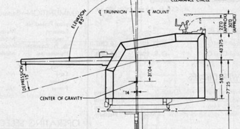

Posts: 5068
Post by Fliger747 »
Willie:
Some bare dimensions for the gun Captain's slewing sight taken from the HNSA Gun and turret catalogue. On my now ancient (begun 1965) 1:192 Missouri I did all the 5"38's in resin, cast from a homemade master, and they are satisfactory. I also cast the blast hoods, but will probably replace them with some printed units that I will make. Since you only have a couple of those you should be able to do a good traditional job with your chosen plastic card methods.
Let us know how the "bloom'n" blast bags come along!
Regards: Tom

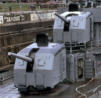

Willie,
Very nice work on the 5" mounts!!! One thing I've noticed about the kit gun barrels - they have a "joint" in them that was not there. Here is a photo of USS STODDARD's Mt. 53 & Mt. 54 in 1967 when we were in drydock in Sasebo, Jn. If you notice, the barrels are smooth from the muzzel back to where the barrel disappears into the gun mount housing:
DD-566 Mts 53 & 54 closeup.JPG (30.99 KiB) Viewed 1823 times
I don't know why the kit manufacturers can't get this detail correct. I would suggest gently sanding the barrels until they are one smooth surface; perhaps add some putty prior to sanding, etc.
Hope this helps,

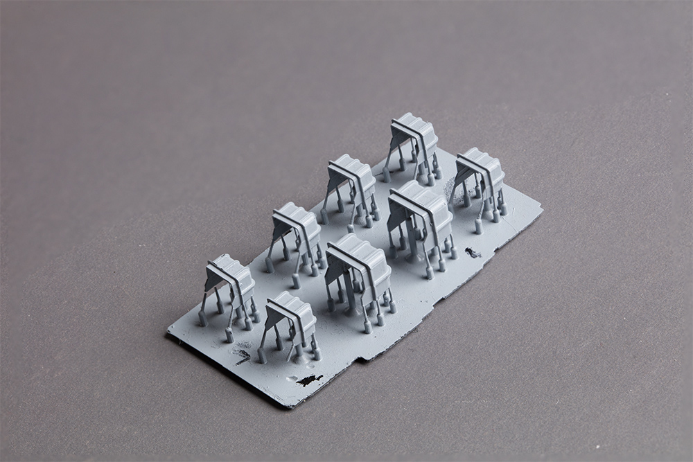

Posts: 5068
Post by Fliger747 »
Some mount Captain's blast hoods I printed today in 1:192 and 1:144. The 192 ones are for Missouri, though currently she only sports four of the little devils. There seems to be a number of patterns in use with regards to the stiffeners and I did these from some drawings I had, but need to consult my BB63 photos to insure they are the correct pattern. Do you have any photos of the ones on JJ?
Regards: Tom

Fliger747 wrote:Some bare dimensions for the gun Captain's slewing sight taken from the HNSA Gun and turret catalogue.
Tom, thanks a lot for the tip and the excellent sketch. No doubt it will be of great help.

BB62vet wrote:One thing I've noticed about the kit gun barrels - they have a "joint" in them that was not there. Here is a photo of USS STODDARD's Mt. 53 & Mt. 54 in 1967 when we were in drydock in Sasebo, Jn. If you notice, the barrels are smooth from the muzzle back to where the barrel disappears into the gun mount housing. Hope this helps,
It does. Actually it also helped to give me a shock when I read your message and realized of the new blunder in the kit. I was following straight away the detailed drawings in AOTS The Sullivans, which reproduce the same mistake as in the kit barrels, and had never realized about the true lines of these barrels.
BB62vet wrote:I don't know why the kit manufacturers can't get this detail correct. I would suggest gently sanding the barrels until they are one smooth surface; perhaps add some putty prior to sanding, etc.
My shock had to do with bleak visions of the sanding and pasting that you mention, with the mounts already closed and very little room to work, but I later realized that the mistake in the barrels begins at the very same point where the ring to set the blast bags has to be fixed, so there is no need to make any kind of correction, as the blast bags will cover all inaccuracies. This is also the reason why I have not closed the gaps around the trunions in all four mounts: uncomfortable, and unnecessary. I have already set the rings around the guns, made with stretched sprue, and I feel much better.
And after I have no fixed idea as how to make the said blast bags, I went on with further detailing. I have seen that there are many variations in the small stuff on these mounts, so I have followed the pictures that are closer to the hatches on board Jorge Juan. I have already made the doors on the front shields, using pieces of Evergreen profiles and stretched again sprue. They are like this at the moment:
Best regards from the North Atlantic,
Willie.

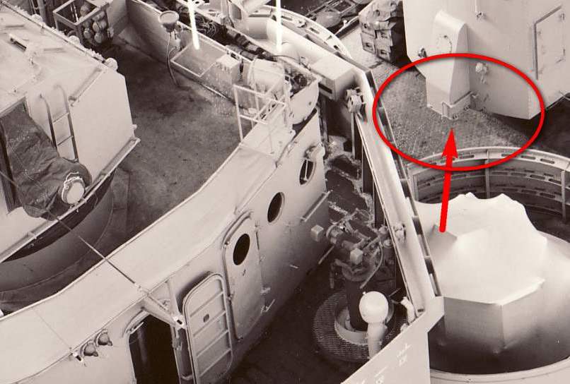

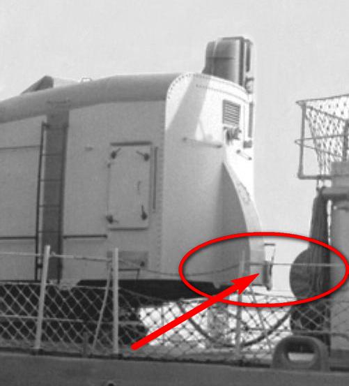

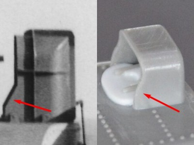

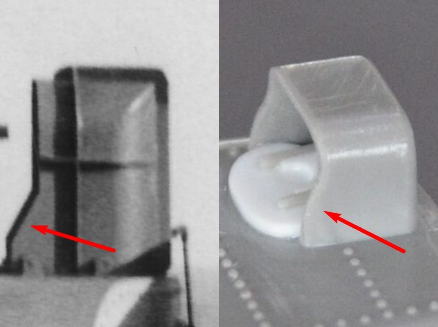

Hi Tom and all,
Fliger747 wrote:Some mount Captain's blast hoods I printed today in 1:192 and 1:144. The 192 ones are for Missouri, though currently she only sports four of the little devils. There seems to be a number of patterns in use with regards to the stiffeners and I did these from some drawings I had, but need to consult my BB63 photos to insure they are the correct pattern. Do you have any photos of the ones on JJ?
Tom, you are absolutely right: there are not, apparently, two Fletchers that are the same in virtually anything. I have only one picture of Jorge Juan�s cupolas, so I attach a close up:
And at the same time: Would somebody have a picture of the element I am marking in red ? I suppose that it is the opening mechanism for the shells ejection hatch, but I have no clear pic of it. Your help would be again greatly appreciated.
TIA, and again best regards from this side,
Willie.[/size]

I have a sinking feeling that the opening for the barrel in the front of the mount is too wide, so as to accommodate the oversized kit barrel? Worth measuring if you can find an accurate dimension on this.

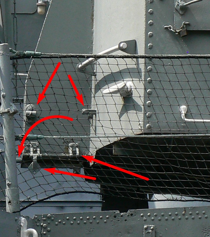

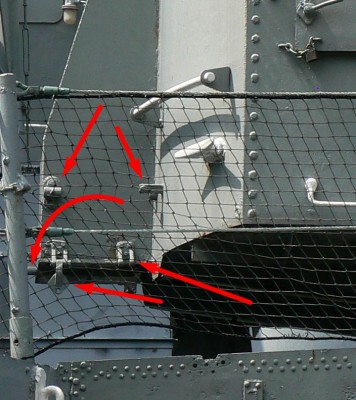

Hi there David, Tom and all,
David,
DavidP wrote:I don't think that is the opening mechanism for the shell ejection hatch being the empty shell casing comes out of the bottom of the chute not the side.
As you very correctly say, the hatch opened downwards, but I am quite sure there was some mechanism to open it, hence my question:
This picture of USS The Sullivans shows that two hinges and that apparently the hatch itself is missing, but also shows some other missing elements.
This one, on the other hand, shows something else, but the gadget is apparently still in construction, and therefore not complete.
The previous picture of Jorge Juan shows something else, brick-shaped or alike, but again very blur due to the poor quality of the picture.
Tom, regarding your observation:
[/size]
Fliger747 wrote:I have a sinking feeling that the opening for the barrel in the front of the mount is too wide, so as to accommodate the oversized kit barrel? Worth measuring if you can find an accurate dimension on this.
Honestly, I am no longer sure of anything else regarding the 5in./38 mounts, let alone Fletchers in general. I have seen so many variations that I don�t feel confident to affirm anything with guarantees.
As for the opening for the gun, more of the same. This is what I mean:
Notice that the opening for the gun on the right picture (USS Brown) is even bigger than the one in my kit, and that the mount captain�s hatches are placed in the oposite corners in USS Brown (right) and in USS Strong(left), while the ladders are in the same position. We have to deduce that the variations were possible not only in the ship structures, but also in the equipment and armament.
On the other hand, USS Brown�s mounts are closer to those of Jorge Juan�s, so I will accept the ones in the kit as they are, as they can be considered basically correct.
Again best regards from across the pool,
Willie.[/size]
