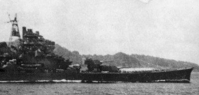

- Posts: 9053
No overhangs - see this small Takao photos
- Atma
- Posts: 3134
- Location: Oslo, Norway
Oh thanks Dan, so Takao's and Atago's rangefinders on mumber 1# went the same treatment like the Myoko's class.And I see that the rangefinder windows on number 2# turret increased in size like Myoko class.Did Maya and Chokai didn't had any change at all on number 1# turret ?

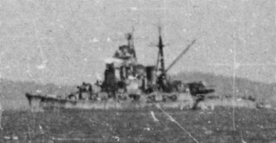

- Posts: 9053
I'm just not sure by late war. Certainly, Chokai & Maya had them thru mid 1943. As I wrote above, L & W drawings make it seem like they were removed, and the housing shell minus the overhangs remain. It would make sense. The photos aren't clear enough. Maya at least retained the housing.

- Posts: 9053
One last try at 400dpi. I think it's just a housing remnant on top of the turret.
- Atma
- Posts: 3134
Yes Im deffinetly sure is a housing remnat of the rangefinder there Dan. But as you said too, is hard to tell if the overhangs have been removed too.
