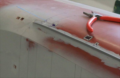

Hi,

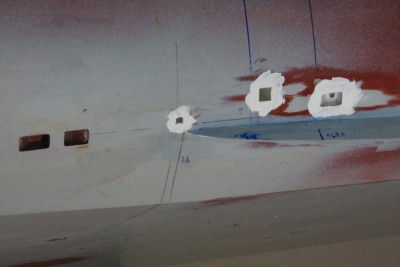

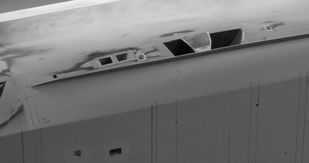

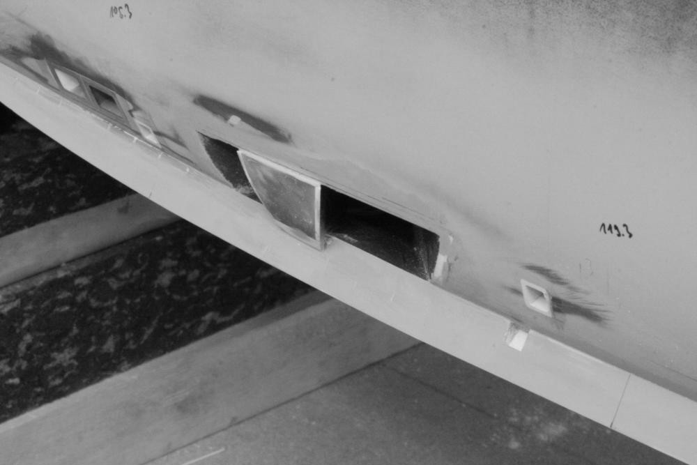

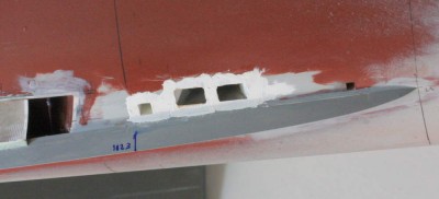

just adding more sea boxes (auxillary cooling water inlets and sea valves) in the starboard bilge ... there must be a sheer endless number of sea boxes in that ship ... :heh:
Dinner! :woo_hoo:
2 aux. cooling inlets and 2 sea valves in progress at the beginning of the bilge keel.

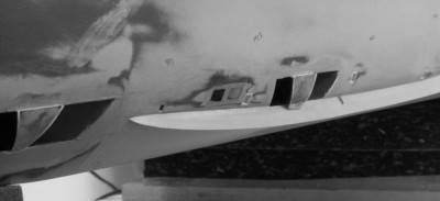

Details of hull bottom
Starboard turbine inlets, 2 sea valves in progress  and 2 further aux. cooling water inlets above the bilge keel

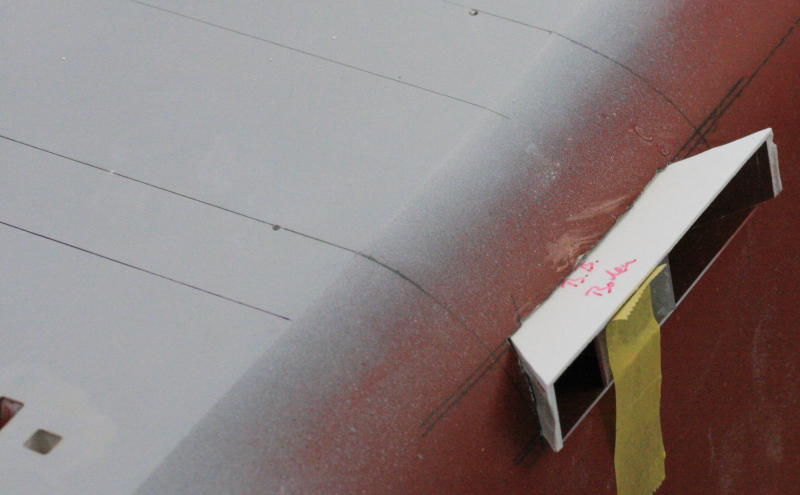

dito
dito
Forward inlet for stb-turbine

Any idea how the drag from all those sea boxes slowed her down .Looking forward to more. :thumbs_up_1: :thumbs_up_1: :thumbs_up_1:
109
Posts: 627
Re: Reconstruction of hull, Battleship BISMARCK, 1/100 scale
Post by 109 »
Hi richard,
I think sea boxes and so on are typical for all kind of steel ships.
We don�t see them on models because the info is hard to find;
and RC models are prone to damage to the hull ... :heh:
Have a nice weekend! :wave_1:

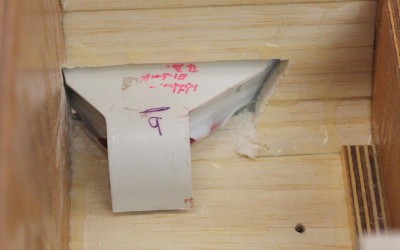

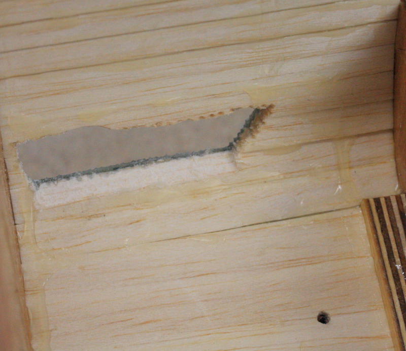

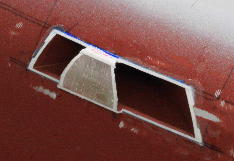

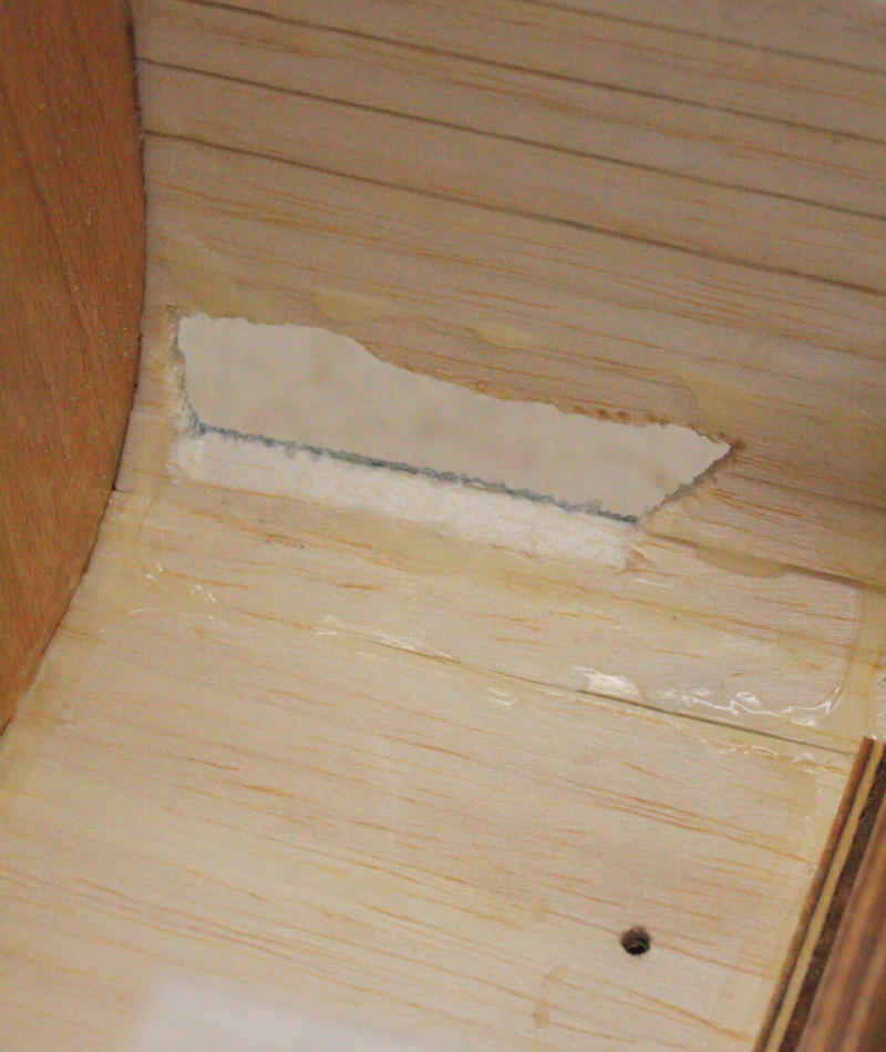

Hi,

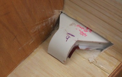

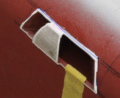

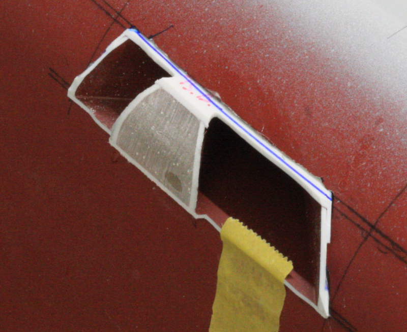

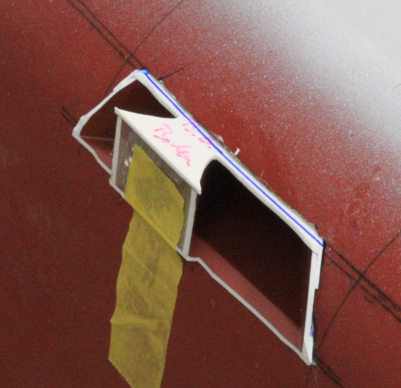

I add a few pictures showing the early basic steps of installing the sea box for the port turbine cooling water inlet.
There seems to be an end of installing sea boxes .... just about a handful left to install! :woo_hoo:
109
Posts: 627
Post by 109 »

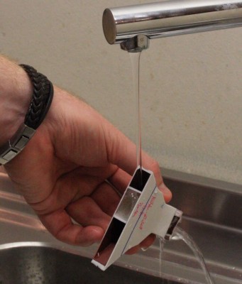

A few more pictures ...
:wave_1:

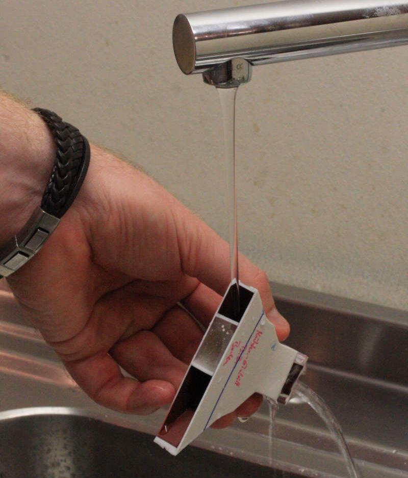

Testing the function of the seabox ... it works! :-)
Rough adjusting of the seabox to fit the hull shape.

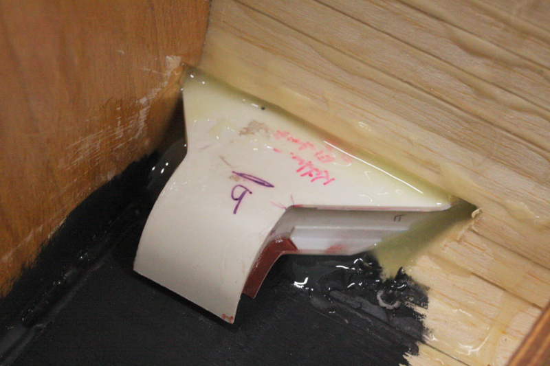

Rough shaping of the wedge.
Fixing the seabox with CA and rough sanding.
Painting black anti-glare panel and glueing the seabox with epoxy permanently into the hull structure.

Is that seawater coming out of your sink :huh: How else would you test the Seaboxes . :scratch: Incrediable detail . :thumbs_up_1: :thumbs_up_1: :thumbs_up_1:
109
Posts: 627
Post by 109 »
Richard J OMalley wrote:Is that seawater coming out of your sink :huh: How else would you test the Seaboxes . :scratch: Incrediable detail . :thumbs_up_1: :thumbs_up_1: :thumbs_up_1:
Yes, seawater. The sink in the bar delivers Burbon .. ;-)

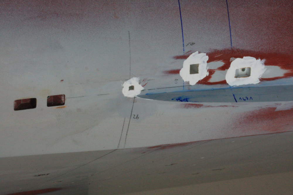

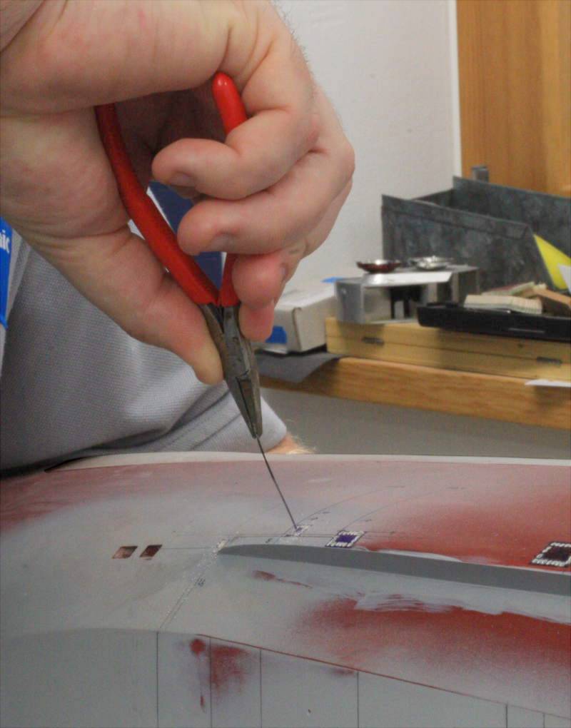

How to cut openings into a hull
Post by 109 »
Hi,

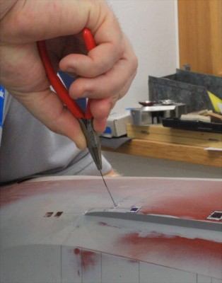

for cutting an opening into my hull I developed the following procedure:
1: Marking the position and the outline of the seabox.
2. Drilling holes (approx. 1mm DIA) inside and along the outline, tightly spaced).
3. Inserting a saw blade into one hole (sawing action with the outward stroke). Holding and leading the blade inside the hull with one hand. With the other hand grap the free end of the saw blade with pliers and execute the outward strokes.
Bye now! :wave_1:

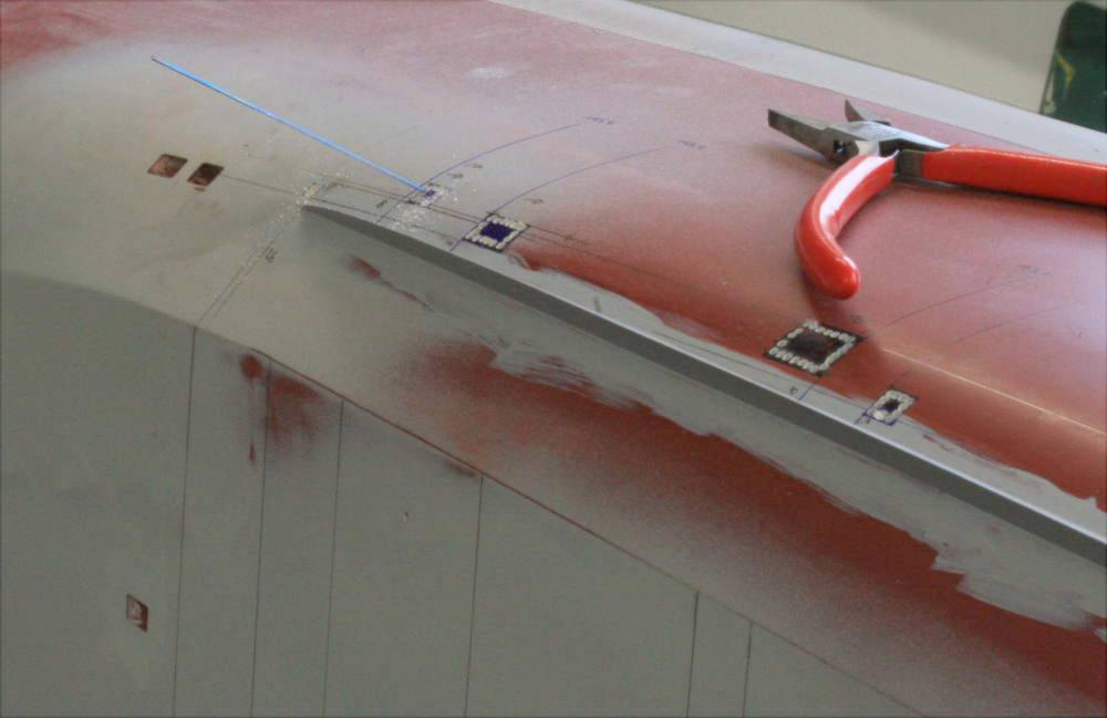

Placing the holes along the outline.
Sawing.
Sawing.

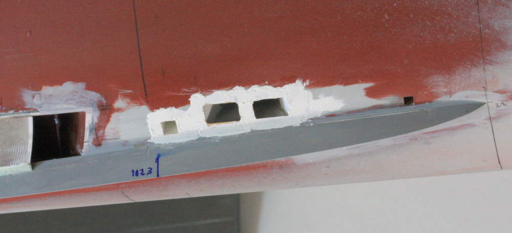

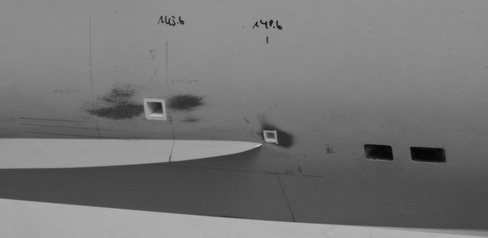

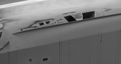

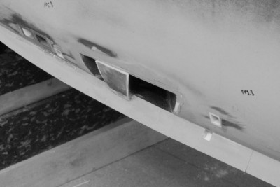

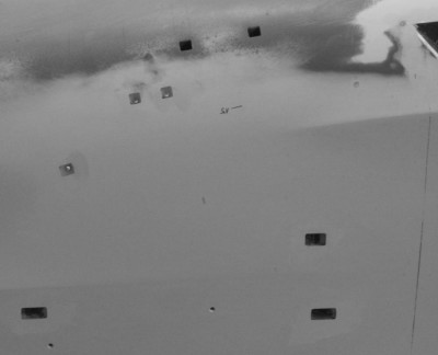

Thanks and finally I added the last seabox! :woo_hoo:
Pictures show the port bilgekeel area.
Bye now,
Bernd.
Front end of bilge keel
Rear end of bilge keel
