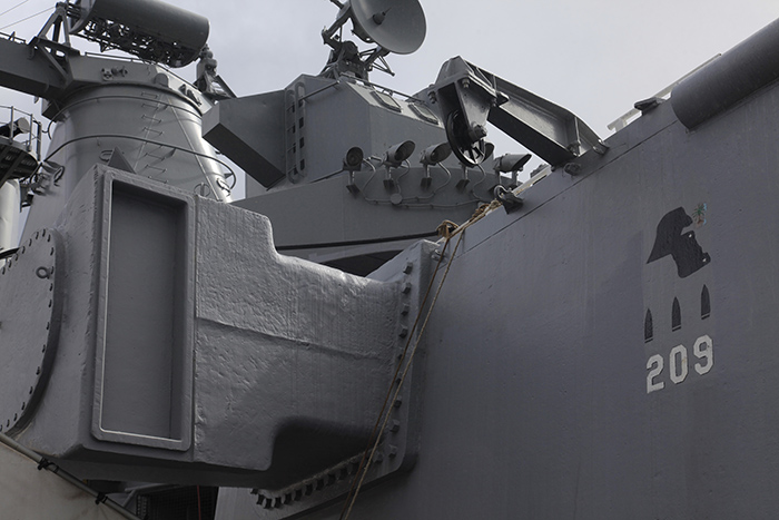

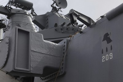

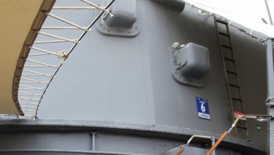

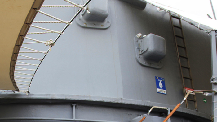

A couple of photos for Randy:
Note the width of the sliding shutter for the turret rangefinder, also note the roundedness of the pointer/trainer hoods and the shape of the hinged cover.
Hope this helps, have some better photos somewhere!
Tom

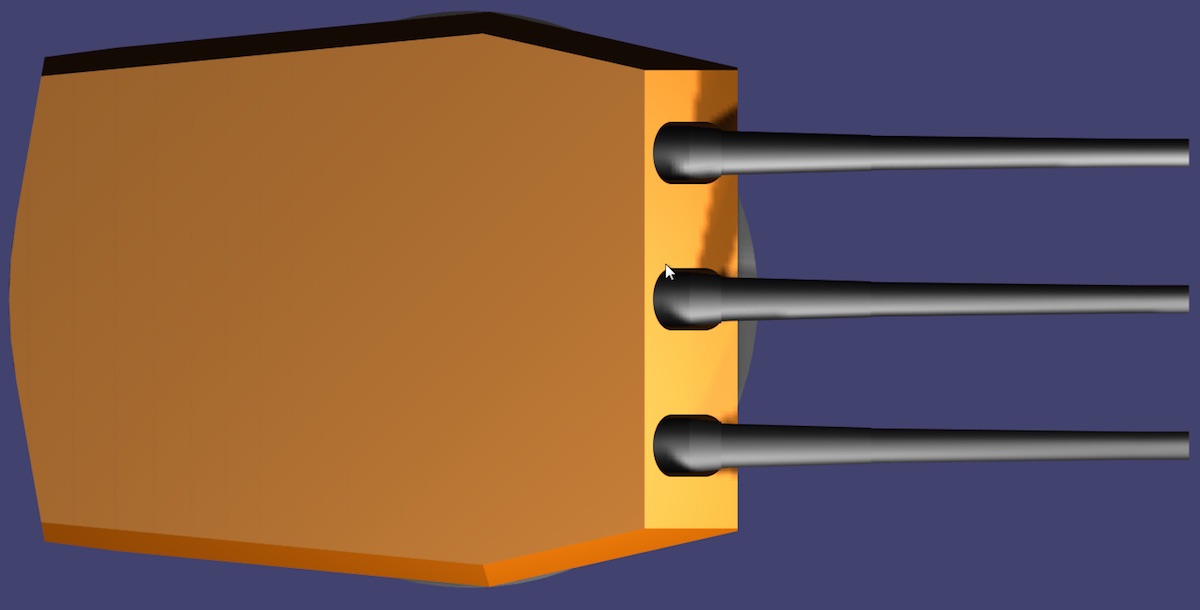

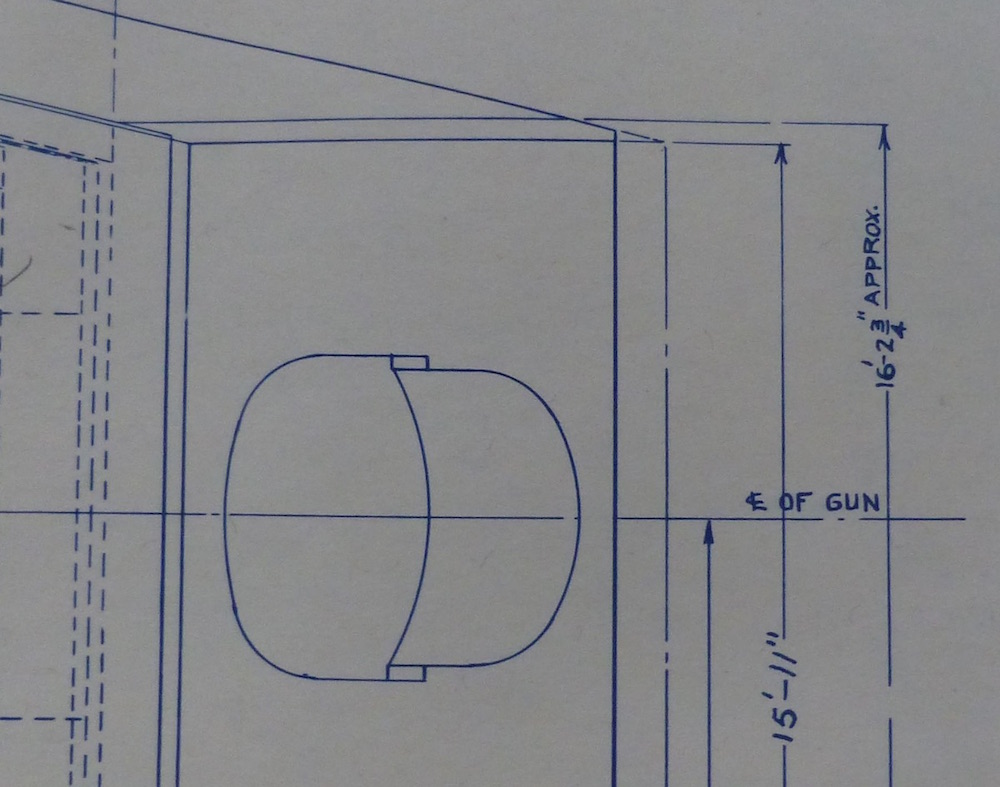

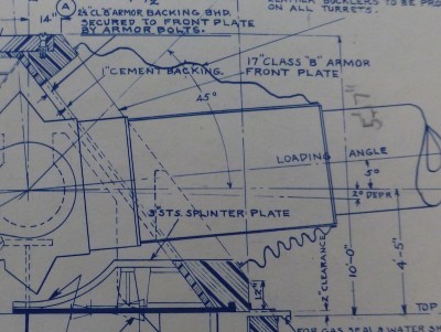

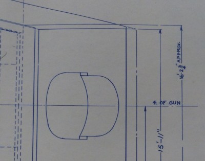

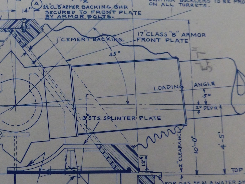

I was able to calculate the facet sizes for the turrets using the measurements on the Iowa planes. They give 3 XYZ coordinates for the forward side facet and the X coordinate for the last corner.
They 2 XYZ coordinates for the side rear facet. Combined with the the others I can get all for points.
Apparently, the just specified the points with nice round inch measurements.
I don't have any measurement of the gunport. I can estimate them. The NARA plans appear to show the gunports being larger at the top than at the bottom with a transition point. That would make sense because when the guns are elevated to 45, a wide part of the barrel goes through the port than when lowered to -2. However, I have never noticed a transition point in pictures.
The plans say "Hoods to be provided by the government" and only show rough outlines.

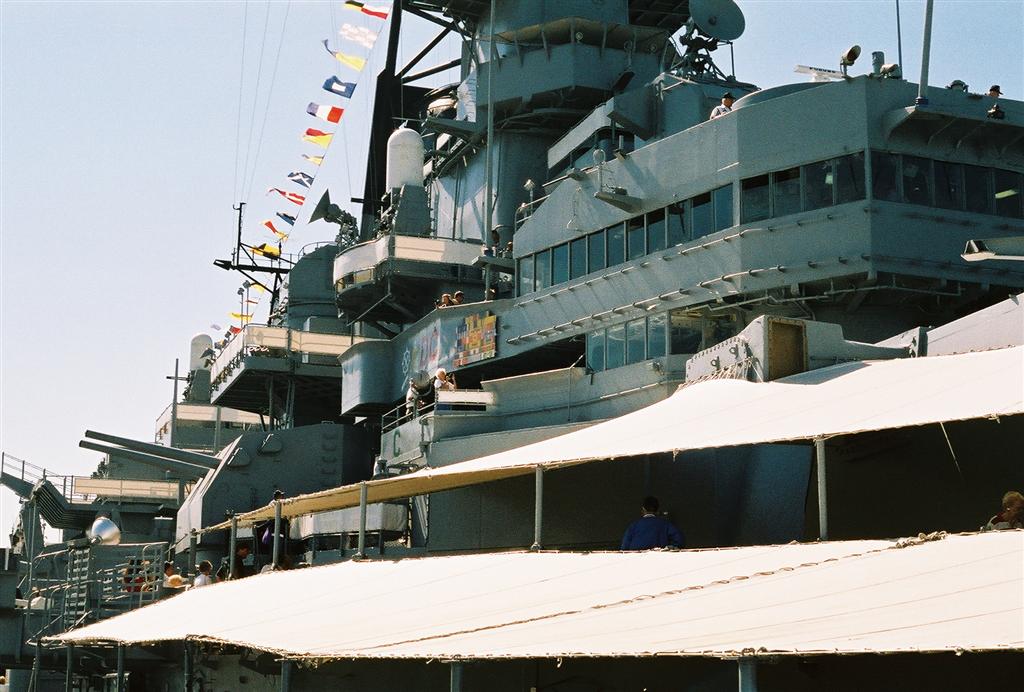

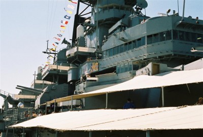

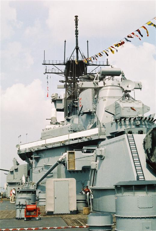

Here is a shot from NEW JERSEY when I was there in 2001 (Turret 3):
I don't know why the shutter and its flange are brass and unpainted, but Turret 2 is also like that:
Hope these help the cause. I'm still not sure what the real question is here. But, I will put dimensions on TFD's drawing of these parts of the turret next week and post.

I suspect it is because brass is cheaper to machine to fine tolerance than steel.

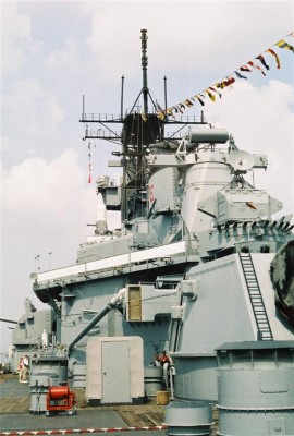

Can anyone point me to clear pre-modernization photo of support structure under broadside mk-37 directors? I am trying to add the diagonal support braces that extended from the sides of support structure underneath the my-37 director to the underside of the searchlight and AA director tubs just under the broadside my-37.
Specifically I am trying to determine:
Is there one or two diagonal support brace beams below the AA director tub?
Do the brace beams under the searchlight tub connect directly to the support structure, or does it connect through the little catwalk behind the support structure at the 04 level?

Fliger747 wrote:I don't believe there is any taper where the barrels protrude through the embrasures as this section of barrel recoils into the trunion sleve. The bucklers appear to have parallel sides. There exist some shipyard photos of the turrets minus the bucklers ( bloomers...).
It's not a tape but rather a discontinuity. You can see from the side view here that when the gun is at the 45 position, a thicker part protrudes than when it is in the -2 position.
The top view shows the gunport being narrower at the bottom than at the top.
Sadly, no measurements of the opening.

Chuck,
OK, late '45 period - MISSOURI - I'll see what I can find. My initial answer to your question is that there were TWO tubular angled supports under the side MK. 37 Director bases from the deck below. But, we shall see....

Well, it appears SpyderDan has provided the needed photo of the turret face. It also appears the face openings are a straight oval, w/o any difference in width from top to bottom. Internally, that may be another matter.

Looking at turret #2, I can see a step in at the bottom of the gun opening. I think it may be the blast bag fastening ring that could have thrown you off BB62vet. I can't see it on turret #1, but that could be because of shadows or the higher elevation of the guns possibly. Just my .02 cents.
