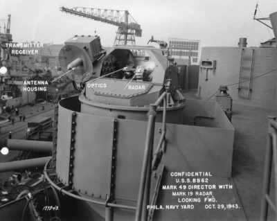

Getting back on topic...
I found an interesting photo of the Mk. 49 F.C. Director on board NEW JERSEY, circa 1943 - I won't be modeling this, but I know others that are building the 1940's era IOWA class and this might be of some help.

Does anyone know how effective a 1942 vintage radar fire control system was?BB62vet wrote:Getting back on topic...

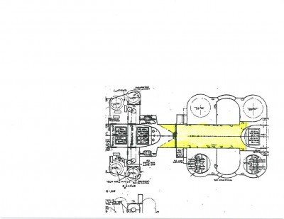

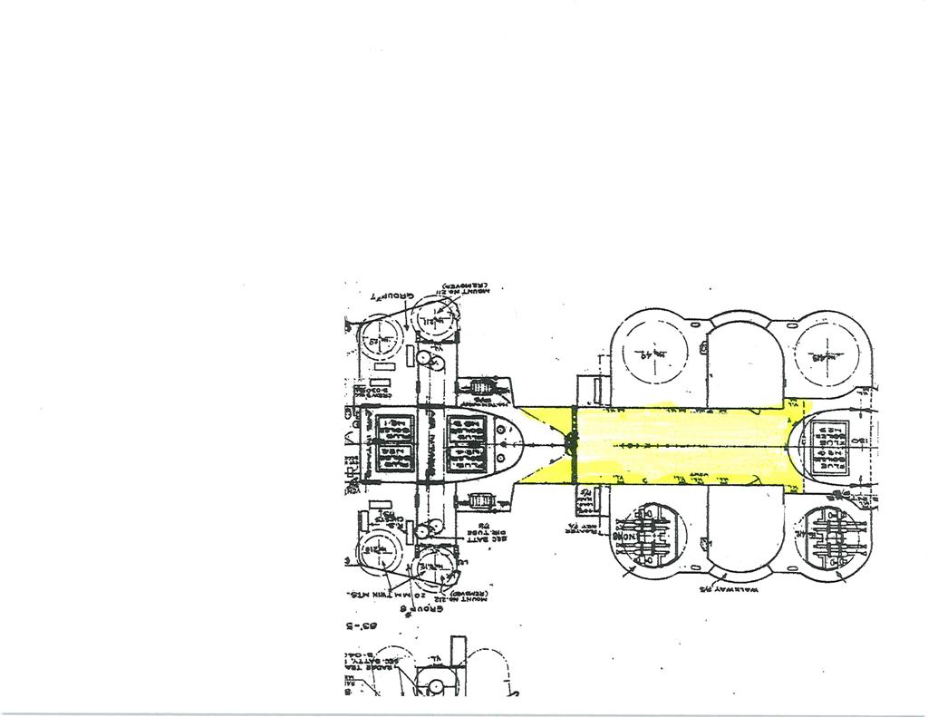

REQUEST FOR INFORMATION RE: USS NEW JERSEY (BB-62) - 1967-9 VIETNAM ERA.
I need any detailed information regarding the configuration of the 03 Level open area between the stacks (fore/aft) and forward of the center 40mm tubs which was enclosed. See plan below for yellowed area. This is NOT how this area looked in 1967-9. Any photos, plans, etc. would be helpful. NOTE: the 1967 NEW JERSEY Booklet of Gen. Plans does not show that area AS BUILT, only a gen. arrangement. Any of you West Coast IOWA guys or East Coast BIG JAY fans that may have info, please reply!!!

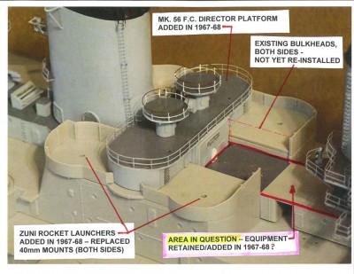

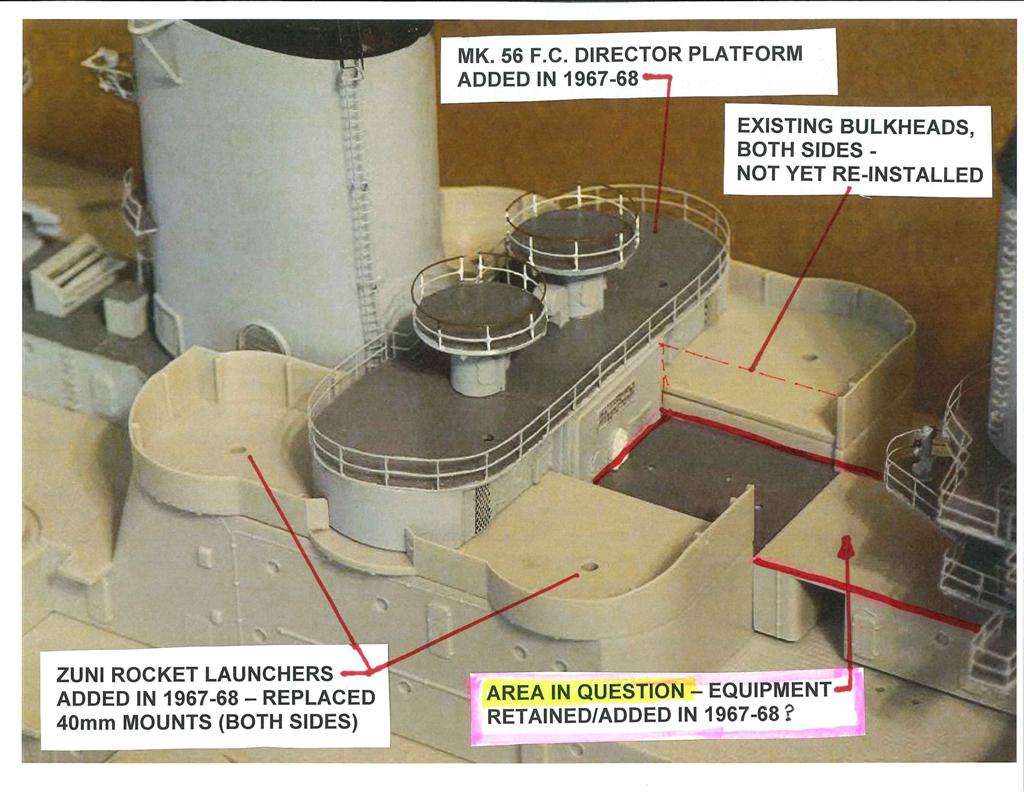

Gentlemen, I appreciate your replies, but perhaps THIS photo will give more of an updated view of the area in question -
This shows my model as of Nov 14 - I've done quite a bit more since then, but this shows the additional Mk. 56 FC director platform (or as Chuck calls it, a deckhouse).
The area I've highlighted in red is what I'm having questions about. The several holes in that deck area are for WWII radio antenna foundations per the Trumpeter kit. This area was modified during Korea on all 4 ships to include gas mask lockers and/or radio/radar equipment storage and differed on each ship. The Booklet of General Plans for MISSOURI (1950) and WISCONSIN (1956) give a general view of how those two ships were laid out (proposed).
When the Mk. 56 Fire Control Equipment was added to NEW JERSEY in the mid-50's the central open area (fore/aft) between the 40mm tubs did not change. It was only during the 67-68 refit that the Mk. 56 directors were removed and a new athwartship platform added in place of the center 40mm tubs on either side and the Mk. 56 directors then reinstalled on that platform. The remaining central open deck area is once again, the question at hand.
The problem is that after going through ALL my reference mat'l, I haven't found one close up, detailed photo of that particular area of the 03 Level that shows the equipment layout as it was in 1968-69. Only a couple photos are vague, at best, and are overhead shots from a distance.
Cliffy B - the spaces below the rocket launchers were used for Zuni storage/maintenance, etc. and the area below the Mk. 56 FC Platform was FC radar equipment rooms and shops.

Hey Hank... it appears that the entire area around the 40mm triple towers is resin in your photo... is this correct?
