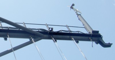

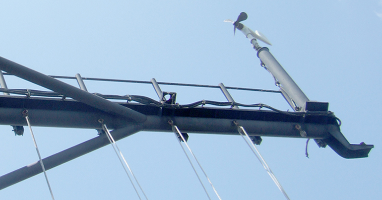

Interesting that the above photo showed the "closeline" for the signal halyards, we hadn't noticed that before you pointed it out!

Well, it was something that was part of both the kit plastic yard and Pontos PE yard that I couldn't figure out until it was time to look into the signal halyard arrangement. That's when it became apparent that this was a unique setup.

Here's a cropped view of the forward facing side of BB-64's port yardarm. We've since re-run the outboard halyard after it broke.

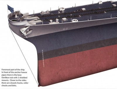

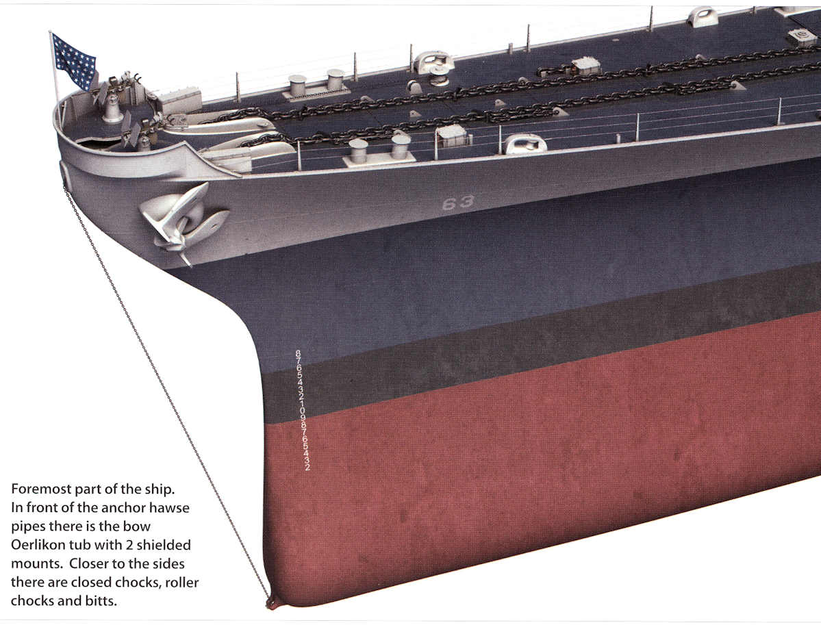

While I'm waiting for the Pontos Detail kits for my 1:200 Trumpeter Missouri, I've been reading about and studying the real ship. One of the references I have is a book by Stefan Draminski titled "Super Drawings in 3D: The Battleship USS Missouri", published by Kagero. In this book, they show two things that confuses me.
Question # 1: They show a paravane chain running from the hawspipe at the tip of the bow down to the paravane skeg at the bottom tip of the bow.
When exactly was this chain in place? Is it appropriate to add it to a model of this ship?

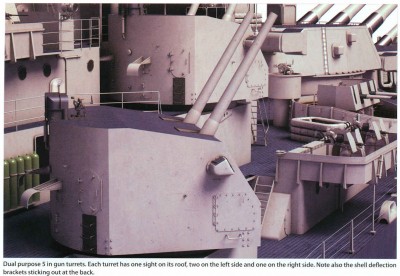

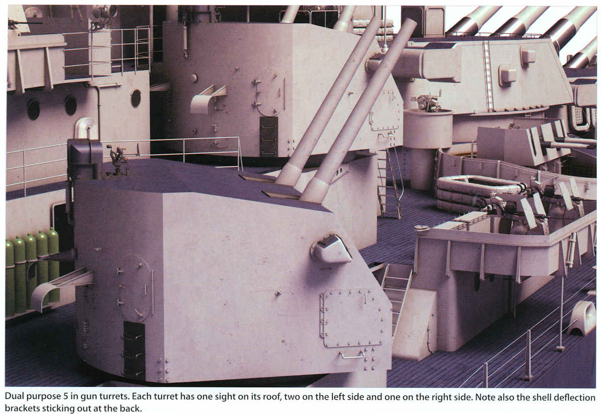

Question #2: On the rear of the 5" gun turrets the book shows something they call "Shell Deflection Brackets".
None of any of the other references I've ever seen, including photos of the actual ship, show these brackets. Are they just a figment of this writer's imagination. or was there really such items at one time on these ships? Is sounds a littler strange to me.

Interesting item, always something new showing up. I once occupied the position of hot case man on a single 5" 38 mount, the job being to toss the hot spent case out the back of the mount, wearing a long pair of asbestos gloves. We had a deflector that was part of the mount. For the twin mounts many different setups were used or tried. haven't seen these before. As my 1:192 Missouri was a modern version these weren't part of my research. All my battleship books are now up in "winter Camp" in Fairbanks.
Great question!

I could not find any photos to substantiate the 3D drawing showing the shell deflector bracket. When 5" mounts are in operation, empty (spent) brass is ejected BELOW the mount thru the upper handling room into the space below. As an example, our berthing area on the main deck amidships was below the upper handling room for Mt. 56 - there is a spring-loaded circular door in the overhead and empty 5" casings were discharged thru that opening into our area when the mount was firing. The casings can also be discharged externally from the back of the mount itself, but I don't ever recall seeing any "bracket" for that purpose. I have a photo in my cruise book showing empty brass casings all around one of the port 5" mounts after a day of firing. I would not rely on these "modern" renderings as much as I would actual photos of the IOWAs thru the years.
As for the paravane chain - I did find a couple photos (NavSource) of MISSOURI with her paravane chain in place thru the hawse hole down into the water, presumably into the bellmouth opening at the forefoot skeg (there is a 7" dia. pipe that extends up thru the forepeak tank to the main deck into which the chain runs which guides the paravane wires used for minesweeping).
I don't think I would show this chain on the model as it would seem to me to be inconsistent with a display model. Perhaps in a diorama it might be appropriate.

There is a small chain windlass just forward of the anchor capstans on the starboard side that is for the paravane down haul chain. It goes forward thru two other pulleys to the bullnose casting.
The controls are down in the anchor windlass room below it.
Here's a picture of the windlass. It's the windlass on the left with the angled pulley going into the chain locker.
http://navsource.org/archives/01/063/016331.jpg
Here's a picture of how the chain was rigged going forward
http://navsource.org/archives/01/062/016294.jpg
Here's a photo of the other pulleys.
http://navsource.org/archives/01/061/016130b.jpg
The open scuttle to the left is the sand locker for holly stoning the deck.
The downhaul chain would always be rigged even if the ship wasn't streaming the paravanes.
The chains for steaming the paravanes would be come up from the forefoot and secured to the deck when they weren't being used.
The Iowas had them in WWII and Korea. The New Jersey didn't have them for Vietnam.

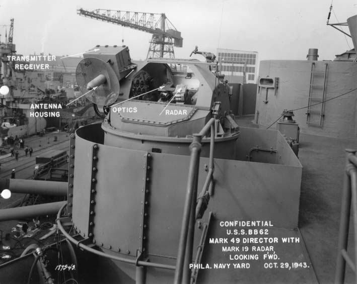

I found an interesting photo of the Mk. 49 F.C. Director on board NEW JERSEY, circa 1943 -
I won't be modeling this, but I know others that are building the 1940's era IOWA class and this might be of some help.
Looking at this the first time around, I actually thought it was a post-war 1960's era gun director on account of the overall R2-D2 shape and the 'fancy' radar dish. It's because I thought I knew all the different gun directors on the WWII era-Iowas and the type of director that I thought was supposed to be installed in that location was the kind that you stood behind and aimed manually (a MK 51). This photo should prove very useful.

I don't know why that is--just another forum quirk which I must admit I'm not a fan of, nor of the format. Here's the photo in question originally posted by BB62vet:

I remember reading about these, apparently not totally sucessful. Thanks for dredging up the photo. I hadn't looked at this closely enough before to realize that they were located on the 05 level just aft of the fire control level of the coning tower.
