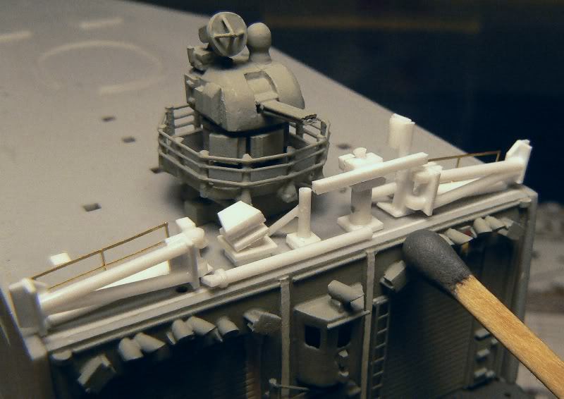

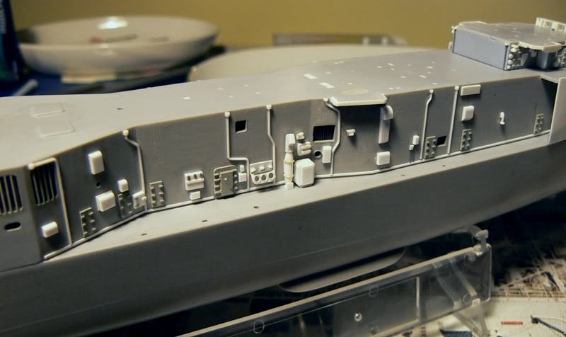

Hi all,

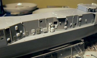

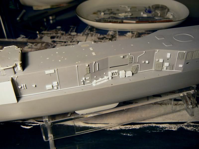

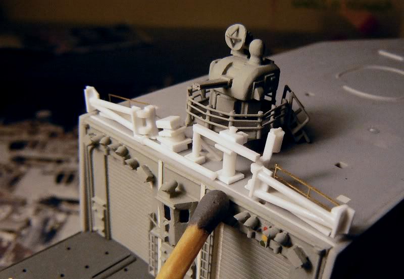

I am busy at the moment completing the details on the bulkheads. It is very easy to do, but it is necessary to be very careful to make room for everything that has to be set in place. They are at the moment like this :

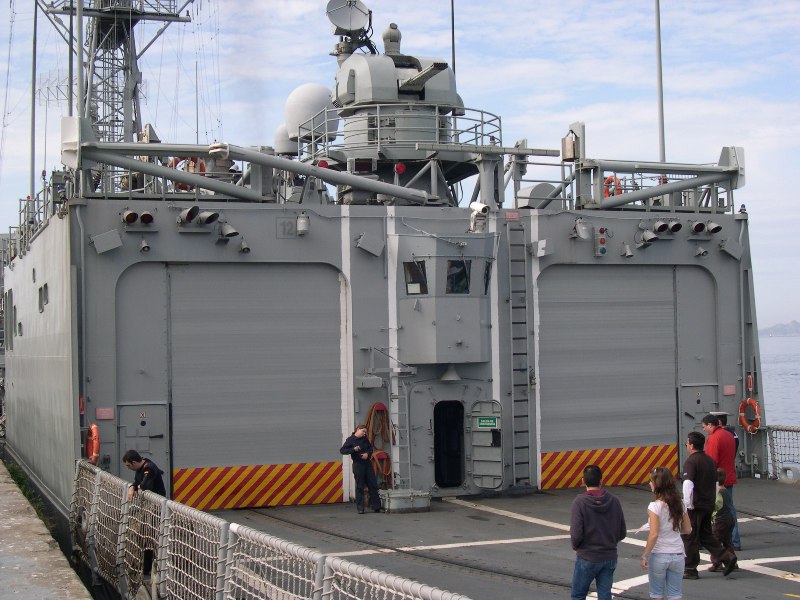

The derricks over the flight deck and the signaling for landing are like this :
And this was my solution :
The derricks are fallen down for lack of glue, but will be erected when set in place.

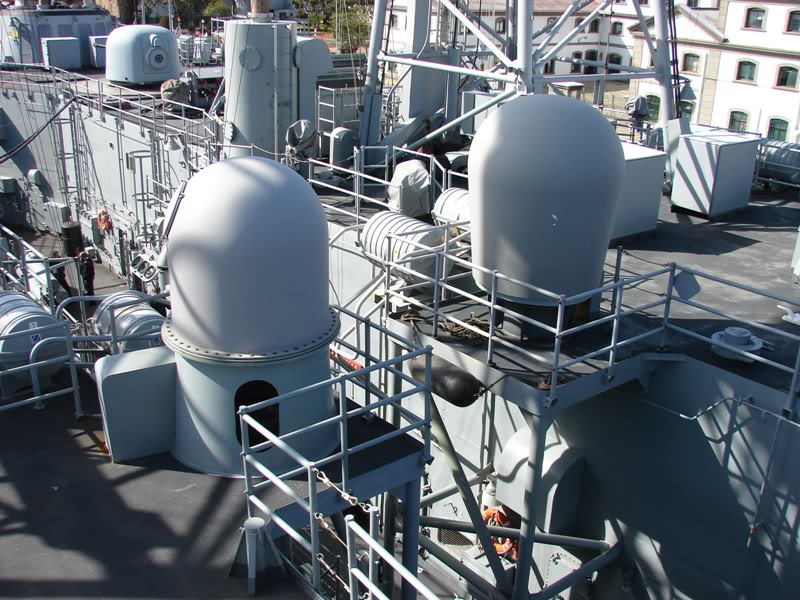

The satellite aerials are the specific for F81 Santa Mar�a in Fall 2006, and they are far different from the rest of the frigates of the squadron, which hace the shape of a match. This is what has to be reproduced :
The base is Evergreen tubing, and the aerial cover is made with a piece of thick sprue, filed and sanded to match the base diameter. Very tiring, but not difficult at all.

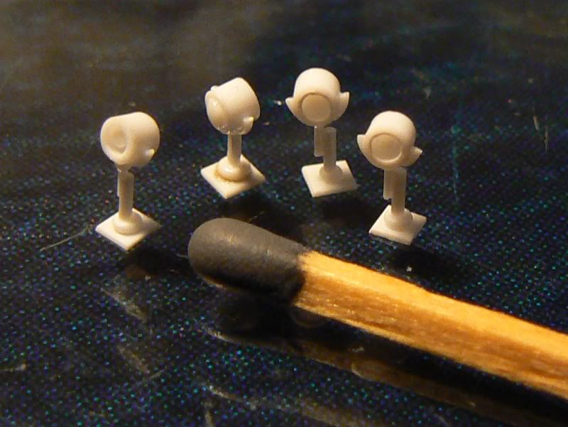

Hi all again ,
The signal lights were very easy to make. Up to now I used to make thyem with rod, using a stretched sprue ring to simulate the lenses, but this time I thought I clud try something else, so I used Evergreen tubing reopening the hole with a drill, and closing the back with a buttom made with molten rod as well. The first set was not very brilliant, so I discarded them and made a new set, like this :
I will simulate the lenses with a drop of gloss varnish.
I hope you like them, and very best regards from Spain,
Willie.

Hi all again ,
The signal lights were very easy to make. Up to now I used to make them with rod, using a stretched sprue ring to simulate the lenses, but this time I thought I clud try something else, so I used Evergreen tubing reopening the hole with a drill, and closing the back with a buttom made with molten rod as well. The first set was not very brilliant, so I discarded them and made a new set, like this :
Willie.[/size]

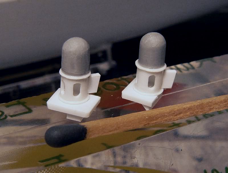

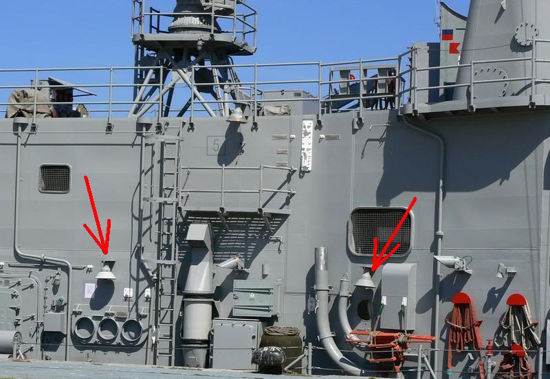

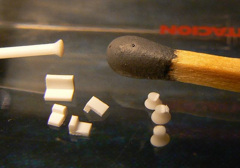

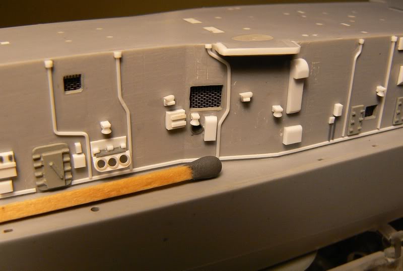

One of the trickiest elements are the manouvre lights on the bulkheads on main deck. They are not very visible, but they have a quite complicated shape. They are these lights, marked with red arrows :
After thinking for a while, the solution was surprisingly simple : Evergreen o.88 mm. rod, heated to make a rivet, flattened with sandpaper and cut to a half mm. of the head, set in place on a piece of Evergreen angle, cut to half in one of the sides, like this :
I was very happy with this simple solution.
Very best reagrds,
Willie.[/size]

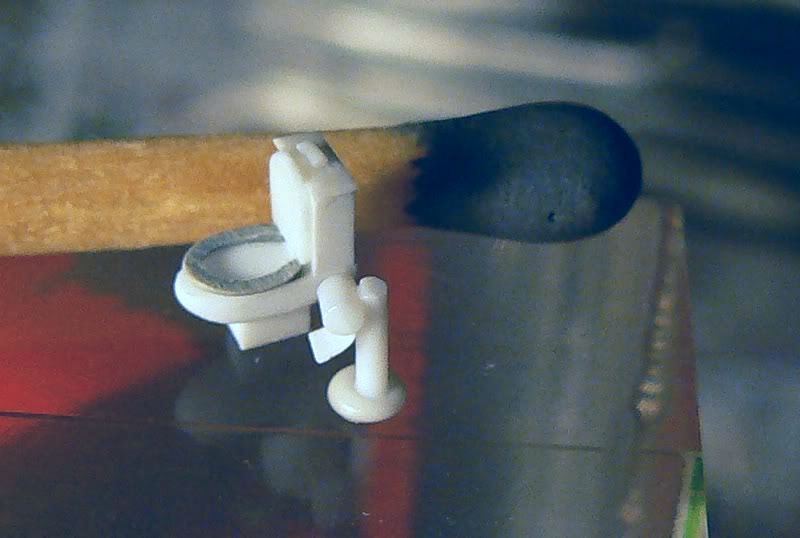

Hi all once more,

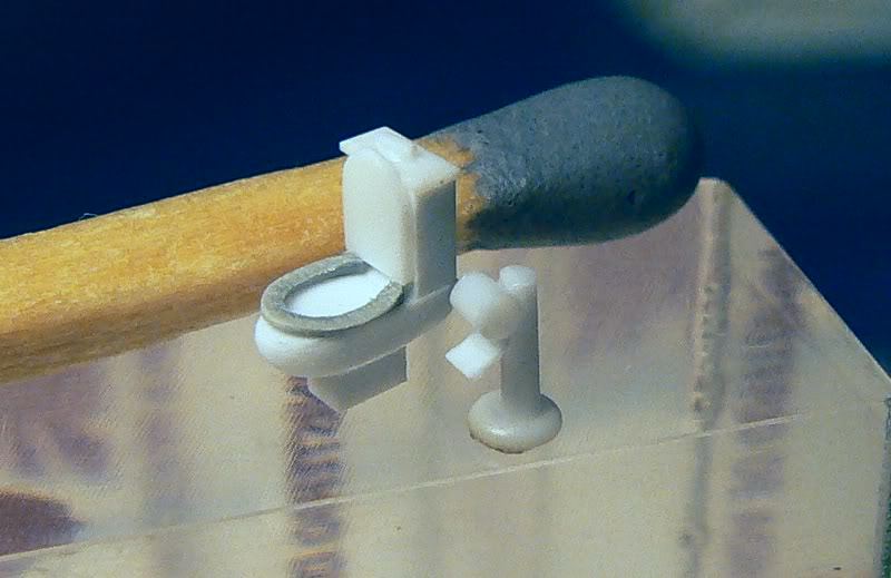

One of the friend modellers in the Spanish forum made a remark saying that too bad the ship�s heads are not visible, because he would like to see how I would negotiate the toilet paper.
Well, what has to be reproduced is well-known, so we do not need to get into details... :cool_2:
The truth is that I didn�t make a pic of this element when I was onboard the Santa Mar�a, so I had to use the model I have at hand -- you know what I mean.
What I was able to reproduce is this :
The leaf of paper is a little plastic chip of Evergreen as well. The paper stand and the paper roll are a bit too oversized, but at scale 1/300 one does not have to be too fuzzy so-and-so, so I have to say very clearly the paper is NOT double tissue... :lol_pound:
I hope you will excuse this little off-topic joke, and very best regards from the North Atlantic shores.
Willie.[/size]
