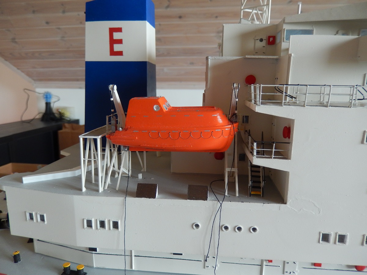

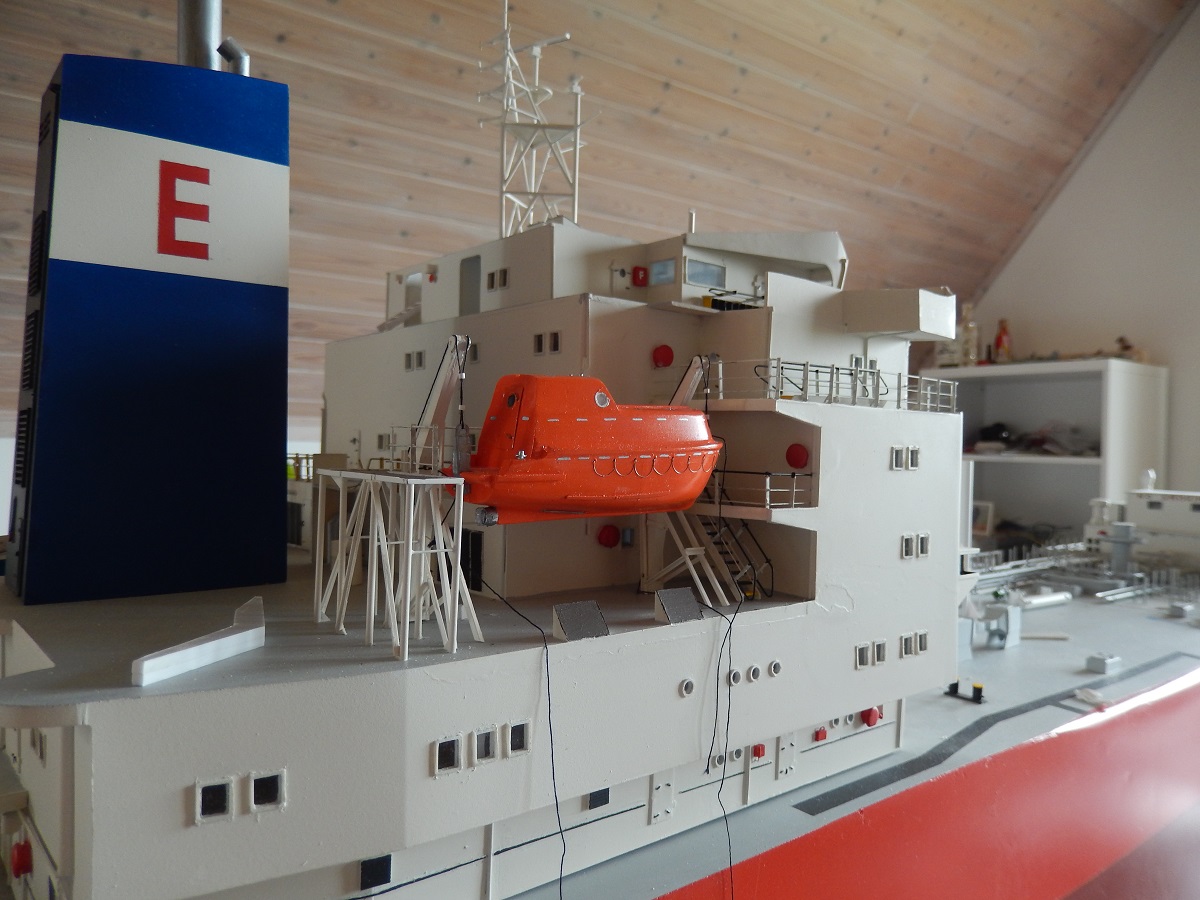

Thanks for the compliments. Thought an update was in place, so here it is. It shows most of the work that was done the last couple of months (on this ship at least :heh: )
Practically I had to first put the railing and stairs on around the lifeboats before I could install the boats. At first I ordered some Dean's Marine stairs, but they were too wide and the brass was too thick to modify them. So I modified my jig to resemble Capt Haddock's and created the stairs that way. The railings on the stairs are heavily modified Dean's Marine railings and the rest of the railings are Dean's as well. Quite strong brass, easy to install and looks good.
The last couple of weeks I've been testing things for the davits and finally finished the lifeboats (propulsion nozzle and grablines were remaining).
For the grablines I tested a jig to make them in one turn, but actually a method with each bow seperate was working better.
I wound 0.1mm brass wire (from a telephone cable) around a brass tube with a suitable diameter. Then I cut small circles from this "spring". After that I bent one end at a 90� angle to fit inside the hole in the lifeboat. I held the other end with a tweezer and like this I could vary the curve of the bow to all be more or less at same height. Once correct curve was visible, I adjusted the length on the other side to hold it just below the next hole and bent the remaining part of the wire to fit inside the hole. This relatively easy procedure was repeated for each curve. They aren't 100% equal in shape, but in reality they look much worse :big_grin:
Here is the tube with the wire and some pre-cut circles. And a pencil for scale:
And the boat more or less in place. The davit with boat was test-fitted with weights holding the cables on my workbench. Once at correct height, the cables were glued on each wheel to hold it. Once the weights were removed the davits could stand by themselves wiht the boat attached. So in these pictures the whole unit is dry-fitted and will be removed again to finish the final supports, railings and lifeboat winch before final installation.
I guess my next sea trial will be with this 1 boat just to make sure it stays onboard and see if I need any addition reinforcements before starting the next boat installation.

Finally I got it installed. Had still to put some markings on the fireboxes and eventually also decided to insert some brass pins in the bottom of the davits in order to fix them better. Still looking to improve that forward lashing though. I think I'll have to move it a bit down in order to right. Won't be very easy though.

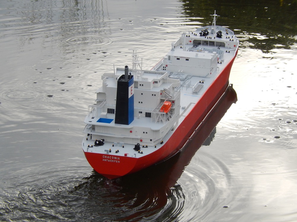

Quite a while since the last post. Of course the tug got priority. Not sure if I'm going to continue this build, but at least I took the chance to take the ship out to the water recently. Together with the kid I tested it on a relatively new pond that serves as a fire extinguishing water reserve for an industrial area. Excellent pond for sailing due to its stepped and reinforced sides. Only disadvantage was a lot of floating plants, but it didn't really hamper the sailing.
And full speed trial.

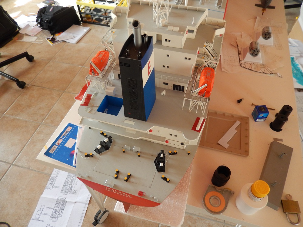

After completing the TI Europe in 1/700, I decided to continue (and finish?!) this build. She's taking up a lot of place and would look nice when finished.
Kind of forgot why I stopped this build, so I guess the interruption was long enough :big_grin:
During the Europe build I added a couple of parts on deck, but due to some construction work in the workshop I can't work on the hull right now.
So decided to tackle and finish the accomodation block first. I started the railing a couple of years back on places where it was required, so now I continued with the railing and finally tackled some parts that I wasn't too keen on before: The magnetic compass and gyro compass repeaters on the bridge wings.
The magnetic compass is just a rough shape as she'll be covered in canvas later on (I think I'll use alu foil for that).
The gyro repeaters need some small detailing, but look ok for now, turned them on the lathe.
I'll try to update the older pics from the photobucket account as well in the near future.
Magnetic compass in position on the top centre. The platform still needs railing as well.
Gyro repeaters dry fitted. Mr. pilot is checking the heading, used that one to evaluate the height of the repeater.

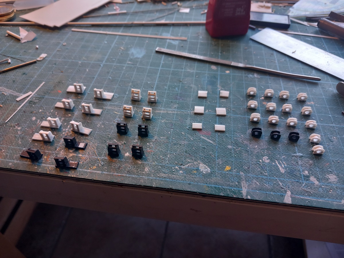

Mooring fittings were made using several jigs for both length and spacing of all rollers on the roller fairleads.
And an overview with the mooring fittings installed.
