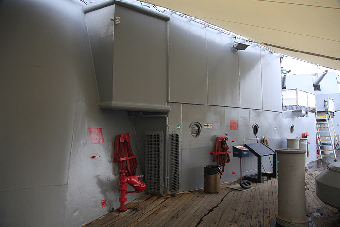

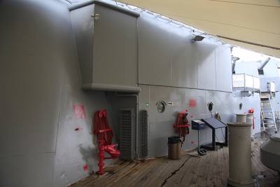

01 Level, port side fwd.
Following up on my previous question on Page 138 - I needed to read EVERY page of the forum, page 74 specifically. They must be vents of some sort. Thanks again. Thanks Flinger 747

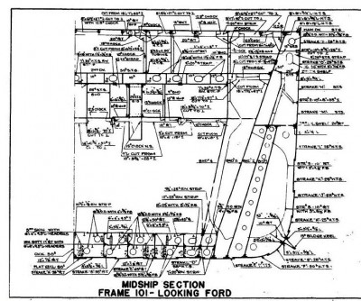

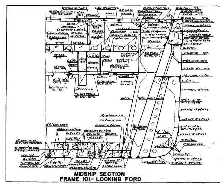

For most of our models in these larger scales, I have yet to see an out-of-the-box model of an Iowa with hull plating details--they are all smooth as a baby's bottom. I always wondered if the Iowas had a discernible keel too. Now looking at a hull frame cross section from the Booklet of General Plans (BB63), we can see a 'flat keel' that runs down the centerline of the hull and I know from experience that this keel must terminate at the small skeg 'nub' that lies between the two inboard propeller skegs. I also note that the plans show alternating overlapping and underlapping 'strakes' that run down the hull parallel with the waterline. See attached illustration:
Has anyone tried to replicate these with thin sheet styrene? Pros, cons, opinions?

Harq -
You are correct in noting that most (if not all) kit hulls are devoid of any plate detail. At least (and this is with tongue in cheek!) Trumpy's 1:200 IOWA/MO hulls have minor indentations for where various PE parts should be placed. This, of course, notwithstanding the obvious distortion/incorrect shaping of the hull itself.
Your further comment about the IOWA hull being devoid of a visible centerline keel is also correct. The side bilge keels are the only external protrusions from the hull, as such.
I haven't seen any IOWA models in this scale (1:200 or 1:192) that have depicted the rows of bottom plating as you describe and show in your attached frame section illustration. I can't recall off hand if Flinger747 has detailed his 1:192 MISSOURI hull in this way or not. I am planning on showing the side plate lines (horizontal) on my build, but haven't decided on the method by which I'll do this. I would think that cutting out very thin strips of styrene would accomplish the job on the bottom of the hull. I'm not sure how to accomplish this on the rounded stern and after quarters of the hull as it rises upwards to the main deck.
Indeed, an interesting question!

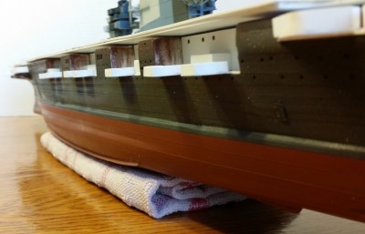

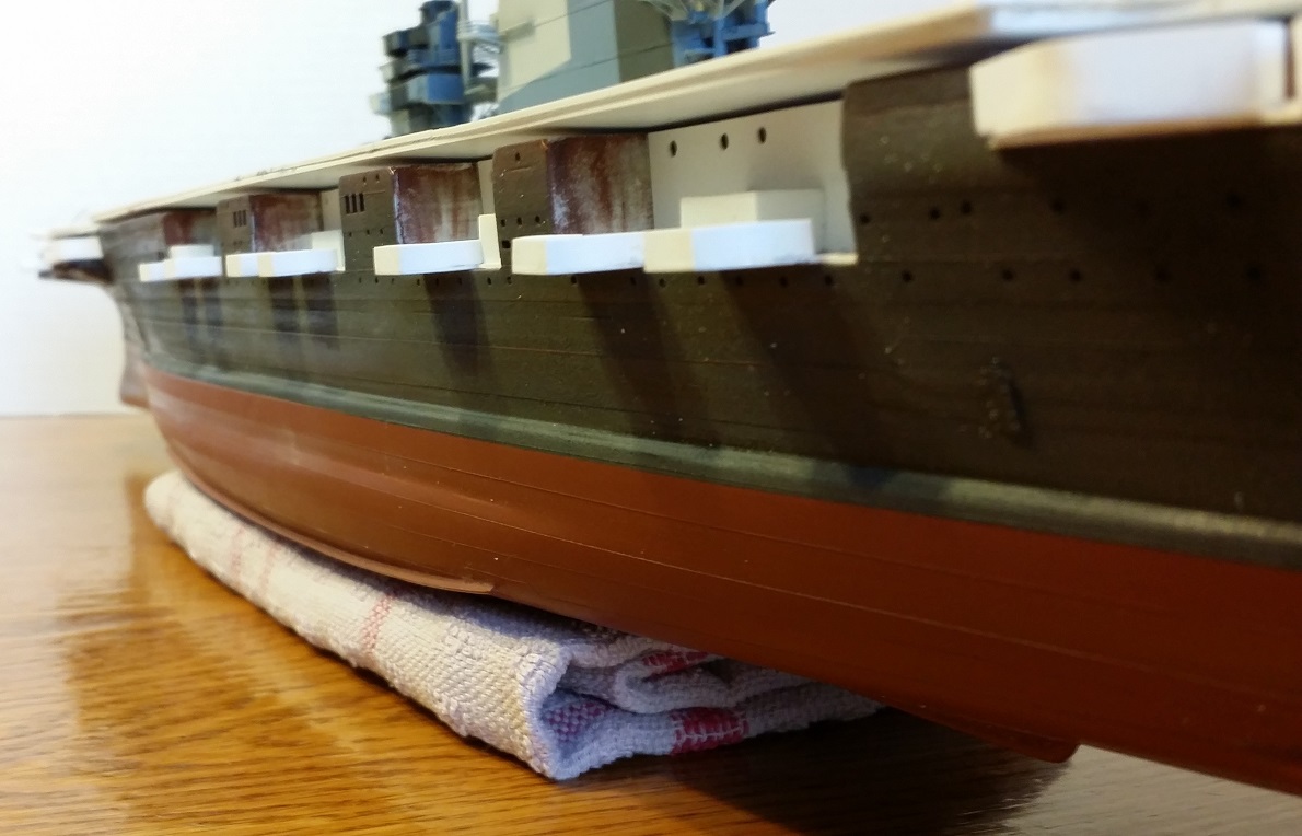

Post by ModelMonkey »
Fliger747 wrote:A building paint such as a high build auto body primer can be used, with masking, to make the plate lines.
I used this technique on a yet-to-be-completed, scratch-built 1/350 USS Saratoga CV-3 to good effect. The trick is using a good primer (Krylon) and good tape (Tamiya).
BB62vet
Posts: 3174
Location: Mocksville, NC
Re: Calling all USS Iowa class fans
Post by BB62vet »
Steve,
Very interesting - it wasn't until I actually zoomed the picture larger to see the lines. OK, so now - how did you accomplish this? I.E. the steps you used and the paints/primers, etc. to get the look.
This just might be the way to go on my NJ.

I guess I wasn't clear but I was trying to say that along with plating detail (in the plans and on the actual ships), the plans show a keel that seems to protrude, ever so slightly, from the bottom of the hull. I don't know if it exists in reality but I was assuming that it does since it's in the plans.
As far as the 'painted on' plating lines go, I think I can give a simple answer: Tamiya masking tape in an appropriate width, let's say 6mm, applied to areas of the hull where the plates underlap which according to the plans is pretty much every other plate section, and then an application of the aforementioned build-up or gap-filling primer and voil�!
The unmasked areas will be replete with raised plate/panel detail...

Yes, that's a good description. When spraying the primer, try not to let the thickness of the primer exceed the thickness of the tape. And, it is best to remove the tape while the paint is still a bit wet. Once the paint hardens, there is risk that when the tape is lifted, the tape will lift adjacent paint with it from the raised strake areas ruining the effect.
Paul Budzik uses an even better technique. It requires more effort but the effect is very, very convincing. Here is a link to his technique on YouTube:
https://www.youtube.com/watch?v=XVULb3sOd2w

Re. the IOWA class hull - As for any centerline EXTERNAL keel, I haven't been able to discern any from the plans except for the extension of the short keel block "keel" that's already been discussed. This is not shown on all plans available but is on others (Booklet of Gen. Plans does not show this stub).
Posts: 5068
Post by Fliger747 »
Cross sections of the hull and Drydock photos do not show any external central keel, just overlapping plates.
Posts: 5068
Post by Fliger747 »
The exception to the keel scenario is a short keel below turret three that is in the fwdortion of the tunnel between the skegs. Mostly I believe to help carry the weath of this turret, especially when drydocked.
