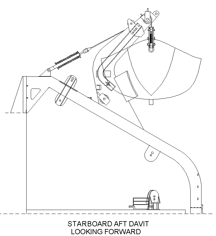

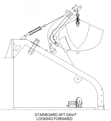

Anyone know the type/mark of the davits for the motor whaleboat on the Adams class ships? What company manufactured them? Better still, does anyone know where to find drawings, tech manuals or training information about these davits?
I am trying to figure out how they work. I know that the upper arm that supports the boat moves down the angled slide to position the boat over the side for lowering, and is then hoisted back up for stowage. I understand how the rigging to the boat winch works. What I want to know is how the davits were latched in place in the stowed position and how they were released for lowering - details of the latching and release mechanism.
Any bosun's mates here with experience operating the davits?

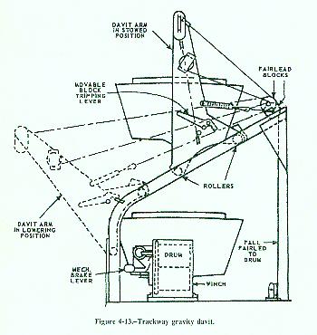

Re: Davit
Like this? If so, I'll try to scare up the link to a pdf of the appropriate manual.
pivoting gravity davit001.jpg (26.35 KiB) Viewed 6833 times
Look in chapter 4 of:
http://www.scribd.com/doc/7823356/US-Na ... 067-Seaman or
http://www.globalsecurity.org/military/ ... /14067.htm or
Chapter 5 of
http://www.scribd.com/doc/7843456/US-Na ... wains-Mate

Russ,
Thanks! The davits I am looking at are similar - I have attached a sketch.
The Seamanship manual answered several questions and confirmed some of what I had already guessed. I was puzzled at the function of the "J" shaped bars on the moving arms. The manual informed me that these are falls tensioning devices that cause the blocks to be pulled up to the highest position when they are not connected to the boat. This automatically pulls them up where they won't be a hazard to the crew or the boat. I suppose I may have "learned" that in a class 42 years ago when I was in training, but if so I had completely forgotten it.
One of the odd things about researching a model ship is that you can find drawings of some parts but nothing for other pieces. I have drawings of the motor whaleboat, and I found a patent for the davit winch online that tells me all I want to know and a lot more. But the davits are still a bit of a mystery.

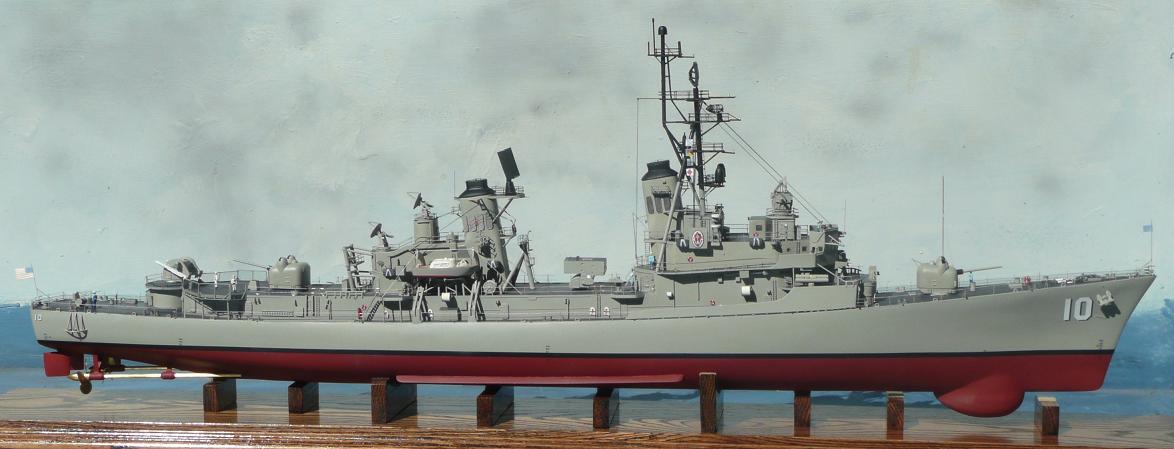

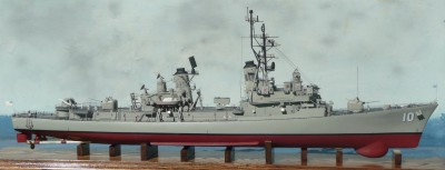

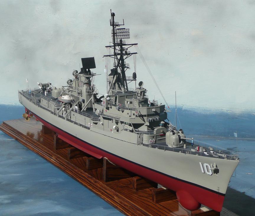

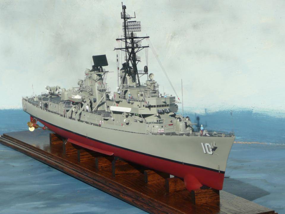

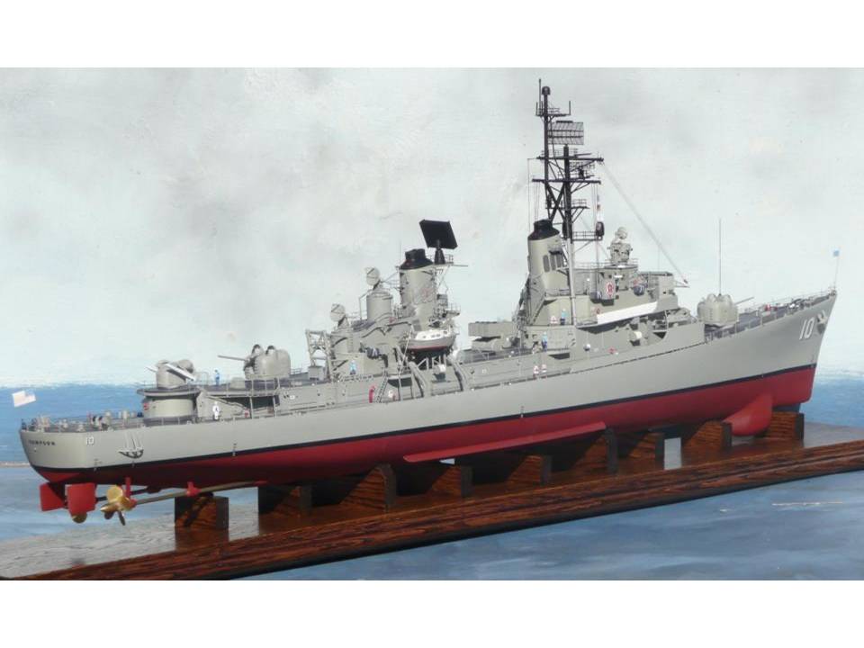

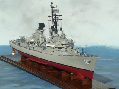

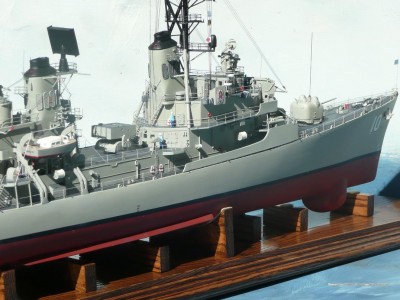

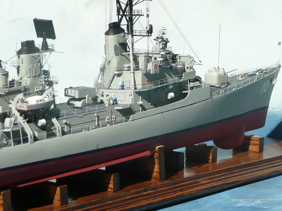

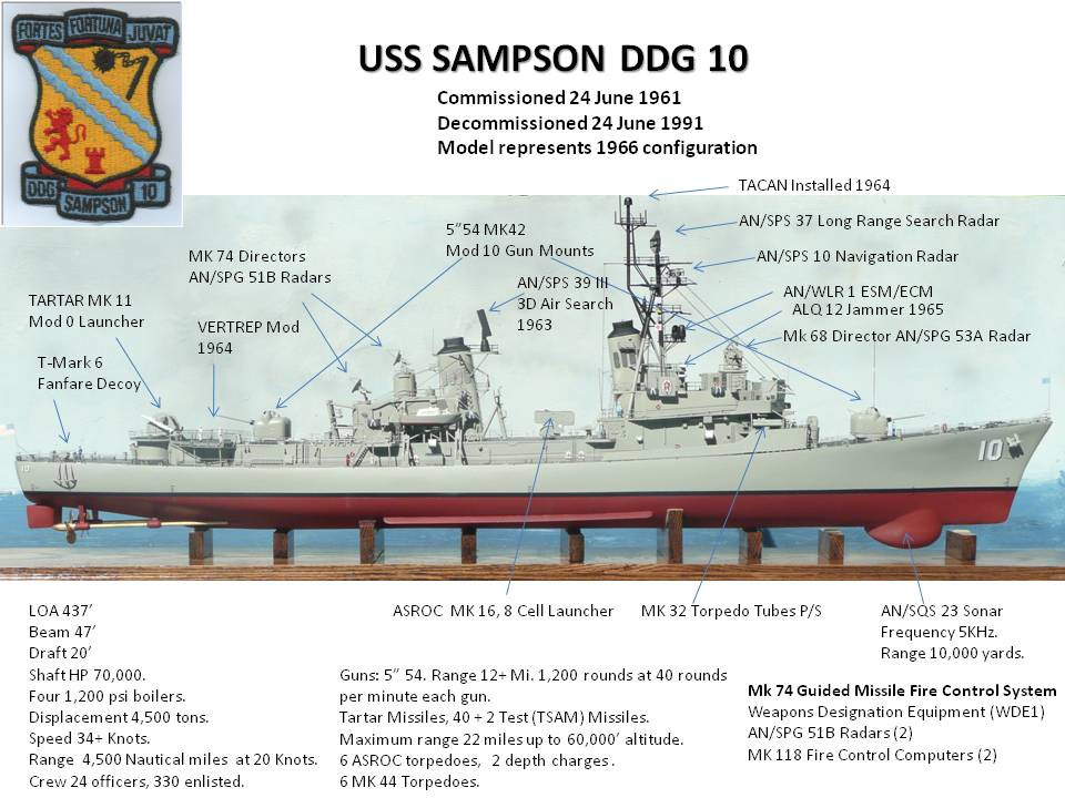

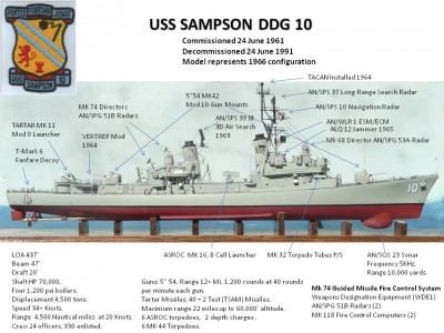

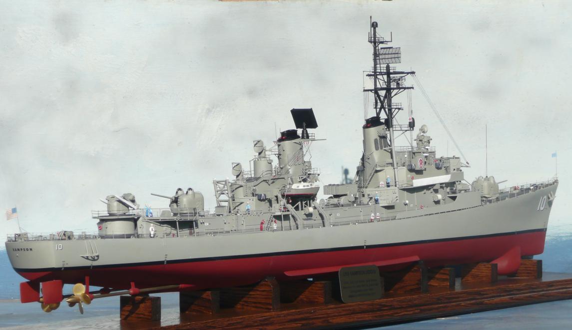

Scratch Model of USS Sampson CIRCA 1966
Scale 1/8"
Configuration with SPS 39 Series lll Radar and ALQ 12 ECM

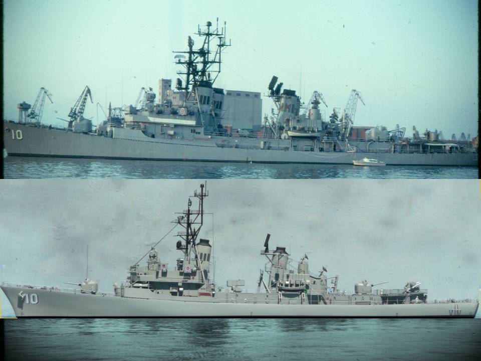

The true test is to compare the model to the real ship
Sampson 1969
Sampson 1969

Post by Tony Bunch »
Hi Guys,
Wes,
That's really sweet! Thanks for sharing with we DDG fans! A 1/96 scratch-built model....no simple task....and it's finished too! Congratulations for that alone!
If there is one thing to say about DDG fans, we're a dedicated bunch! Here's to the Charles F Adams fans!
These ships are extremely sexy! I can still remember one of our own SD IPMS members reflecting on his days as MK68 GFCS officer aboard DDG15 during the early 70's. He was telling the group a little bit about the ship itself, its' ride characteristics at various sea states etc....but when it came to his rather inspired description of the ships powerplant and speed capabilities......" here's this fleet destroyer with 70,000 horsepower.........it had soooooooo much power...!!!.." It was cool hearing his tone of voice and seeing him raise his hands and arms in a certain way as he described how macho these ships were! To be on one of those ships must have been cool! That's all I can think.
Questions:
Did you use a ScaleShipyard hull?
Is your model R/C?
How long did you spend on this?
What other "works" have you done?"
Are you getting involved with the CFA association?
Best wishes and thanks again for sharing!

Post by Wes N »
Tony
The hull is from scratch, plank over frames and then fiberglass. The forward superstructure and mast are brass.
I built a BaD version a year before and found out the proportions were off. This model is not an RC version.
I have had contact with Dave Myerly at the CFA, he helped me with the ALQ 12. The Sampson was the test bed for the Tartar weapons system from 1963 to 1965 and was first with many of the weapons systems improvements. The Sampson was the only ship with the ALQ 12 (1965) which lead to all ships getting the ALQ 32 in the 1970s. Sampson got the SPS 39 Series lll in 1963.

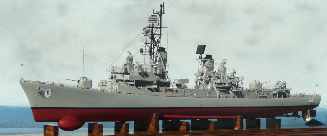

Post by Wes N »

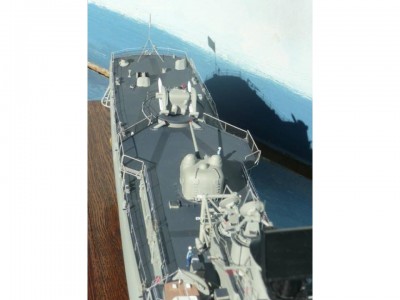

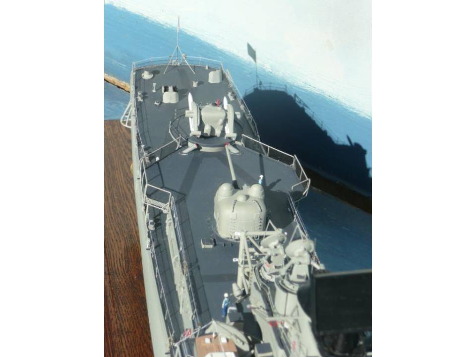

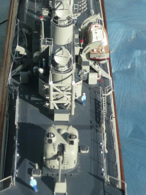

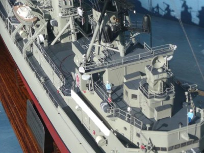

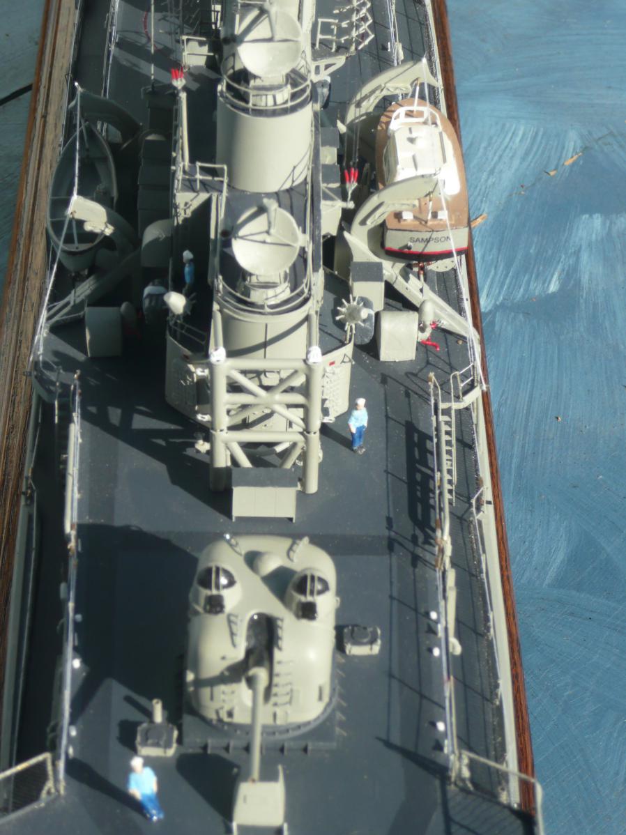

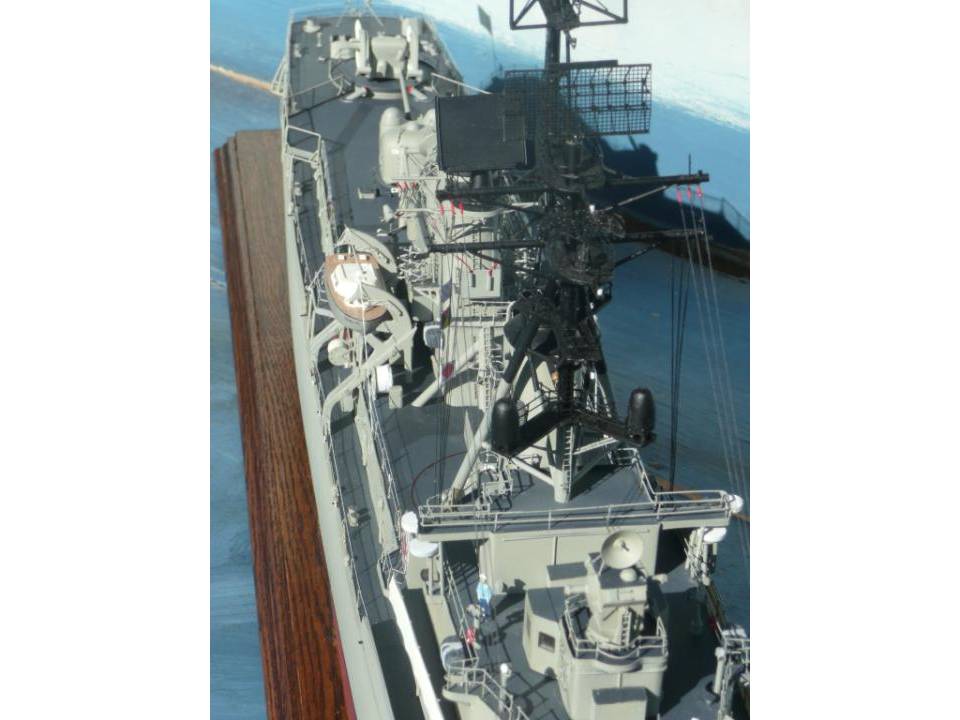

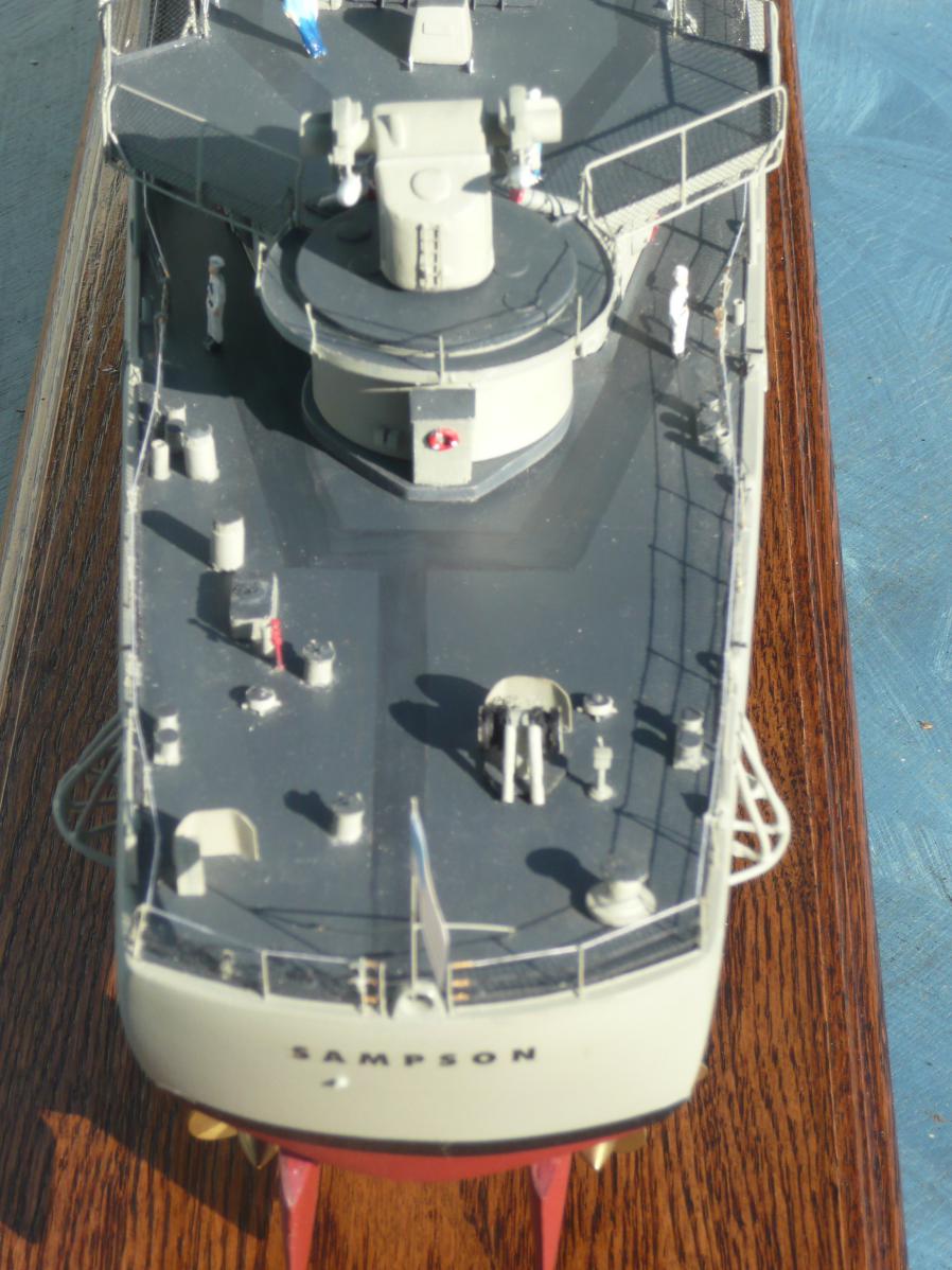

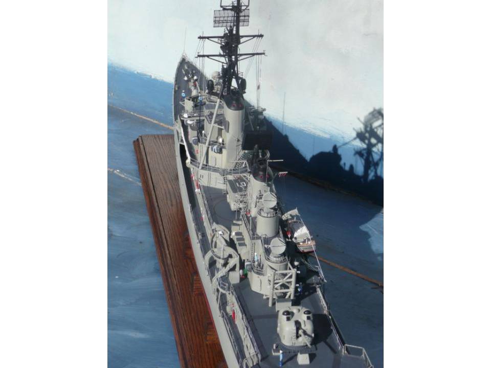

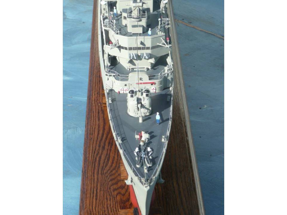

Additional detail added to the scratch model of the USS Sampson DDG 10. I have added detail to the MT 51 and 52, also the davits and signal bridge.
Starboard side MT 51 detail
Bow pix with MT 51
Bow pix with MT 51
Signal bridge with new binoculars, davits with new tensioners
MT 52 detail
MT 52 detail
New canvas on 02 level
MT 52 detail
MT 52 detail
A view of the final version superstructure
Final version starboard side aft
Final Version aft view
Final version 01 level aft

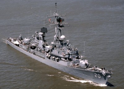

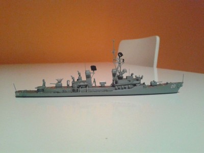

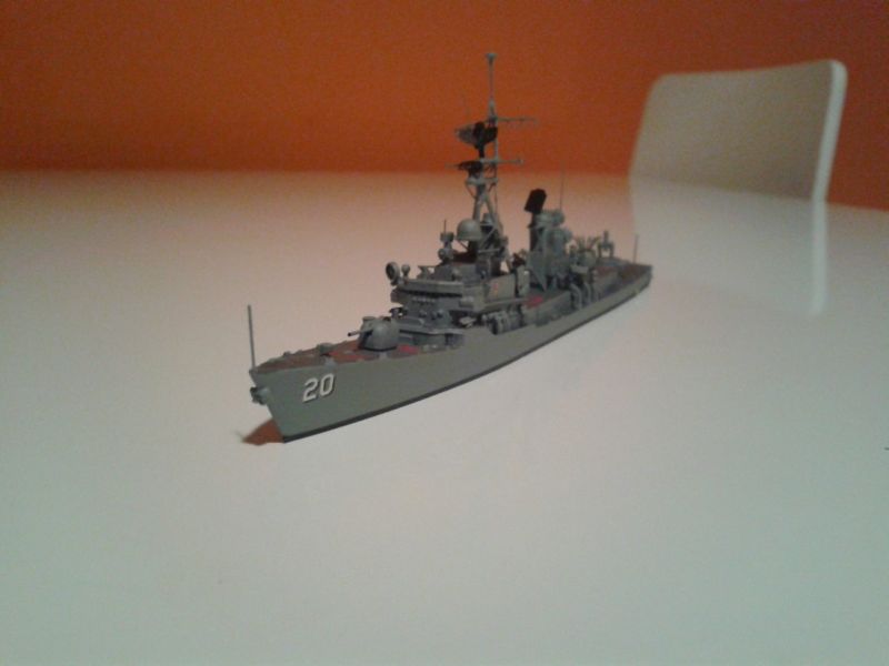

Post by bruno_koob »

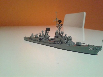

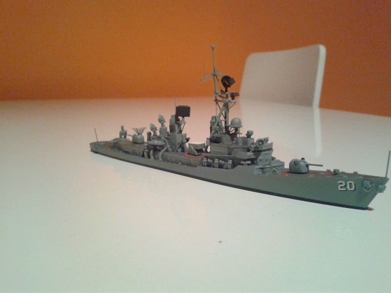

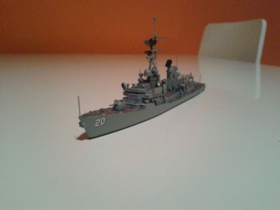

Hi All,

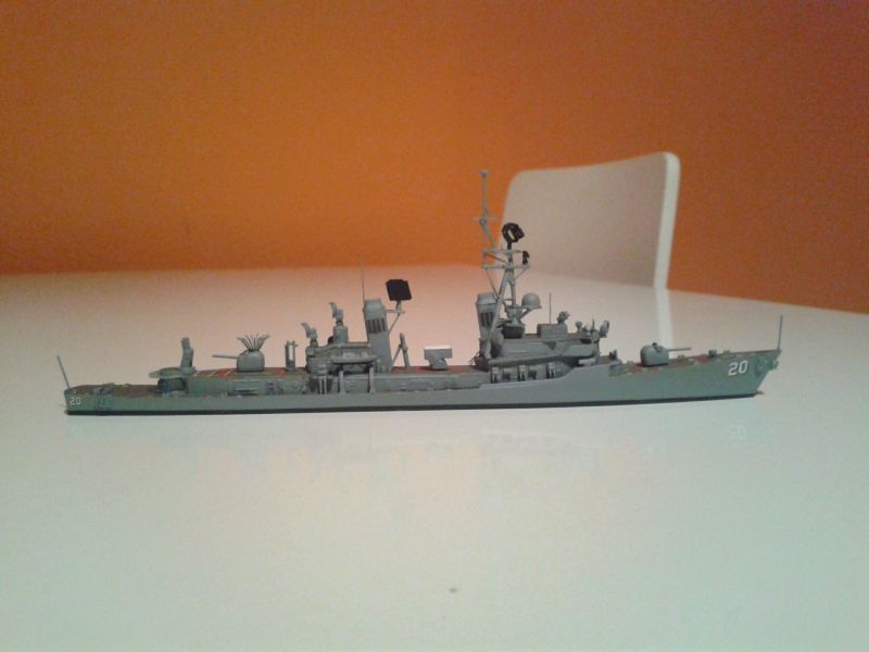

please find below some pictures of my build of DDG-20 USS Goldsborough in her last fit prior to decommissioning.
I used the Revell 1/700 CFA kit, Flagship Models PE details, though i did not use the railings.
Thanks to you all for the great input on this site as it helped my build of this kit!
Best Regards
Hi Guys,
Bruno,
That's a very clean build on USS Goldsborough. You did the memory of this ship proud!
Maybe a DDG-20 veteran will get to see your model here. You may consider submitting your photos and build details to "submissions@modelwarships.com". If you're interested in letting many more prople see your finished model, then this would be the way to do it.
