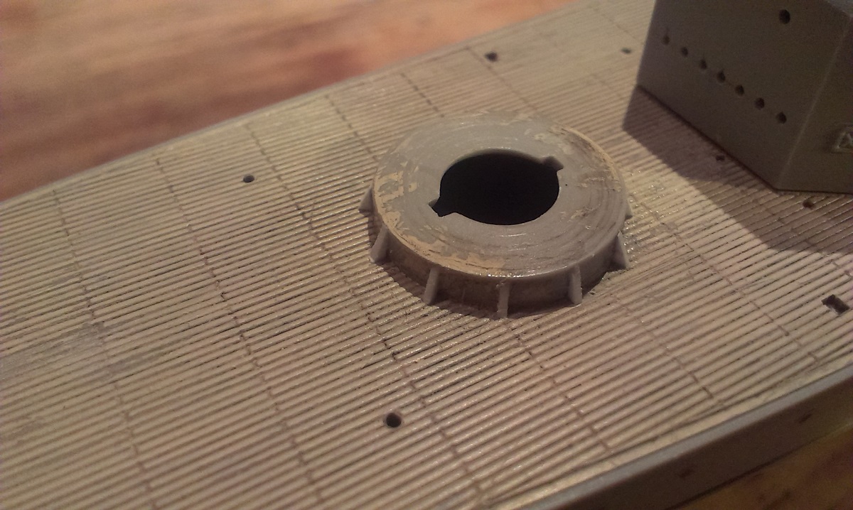

And here are the corrected barbettes, with twelve reinforment plates.
As you see, the replaced deck around B turret from Evergreen is quite nice. The butt ends of the deck planks I scribed in similar fashion like the rest of the kit, not to fall out of tune of course.
On the Y barbette I replaced all the triangles to make them similar with those of the forward turrets.

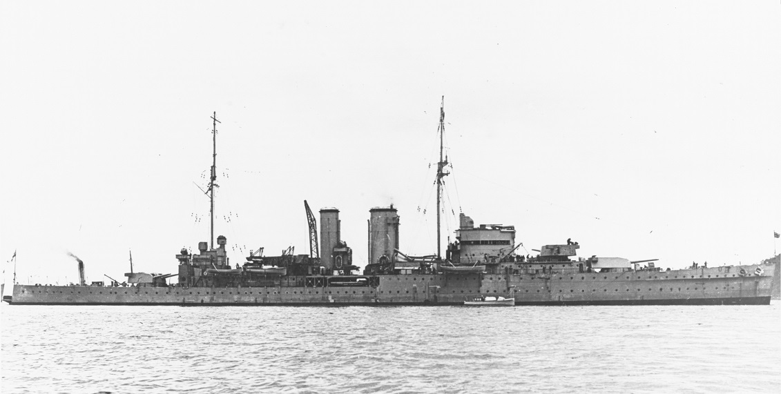

An interesting image, not Exeter, but HMS York.
A Dido in background, likely to be Bonaventure.
York was one of the chosen few to receive some of the very limited supply of MK I oerlikons early 41.
Her qtr deck octagonal gun bin, note the barbette ribs on Y turret.
From the previous mentioned series, incorrectly and ridiculously identified as Perth.

Brett Morrow wrote:An interesting image, not Exeter, but HMS York.
Thank you for this picture, Brett!

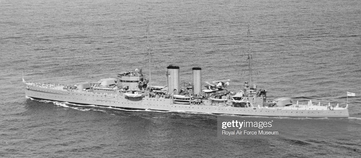

Was there ever a general consensus on if the "EX" on the tops of the turrets were black or red?
Maarten Sch�nfeld
Posts: 1846
Re: Calling all HMS York class (HMS Exeter-WWII) fans
Post by Maarten Sch�nfeld »
FRAMSailor wrote:Was there ever a general consensus on if the "EX" on the tops of the turrets were black or red?
I'm afraid not yet! The red version seems to have emerged from Profile Morskie, but I have no idea on what evidence this was based. As far as I'm concerned David Hogues version in black looks more credible although less colourful to me.

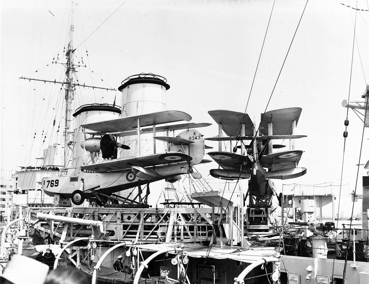

And to add to the confusion: here we have a picture with the "EX" only on the rear turret, and in white apparently!
Roger Whittaker +9/13/2023

Maarteen, interesting photo of Exeter with the white "EX." Can't make out if the aircraft is a Fairey IIIF or a Hawker Osprey but, either way, prewar.

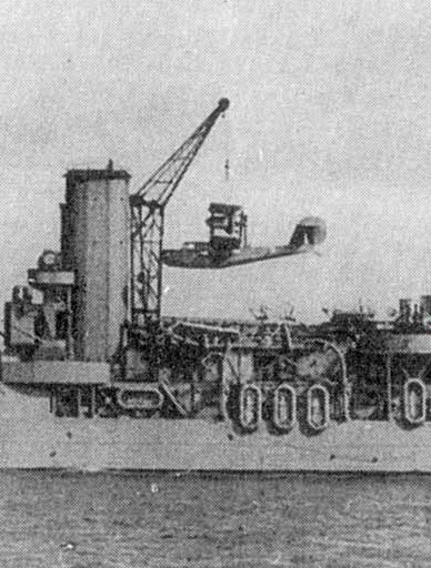

Speaking of aircraft: Exeter had York's Walrus at River Plate, but was it camouflaged or silver?
Maarten Sch�nfeld
Posts: 1846
FRAMSailor wrote:Maarteen, interesting photo of Exeter with the white "EX." Can't make out if the aircraft is a Fairey IIIF or a Hawker Osprey but, either way, prewar.
I believe the embarked Walruses were still in silver paint by that time, and all photo's I've seen of Walrusses on HMS Exeter support that. There was simply not the opportunity to exchange them for camouflaged examples. It's just a peculiarity like the bronze eagle still being on the stern of DKM Graf Spee at that time, although the order had been given to remove all these peacetime markings.
The aircraft on the previous picture seem to be Seafoxes to me, as Ospreys had a longer engine compartment.

Maarten's aerial photo is one held by the RAF Museum - for which gettyimages seems to be able to charge at least �150! Copy online at https://www.gettyimages.co.uk/detail/ne ... /159136974. gettyimages' caption says it was taken in 1933, well before the Seafox first flew. The caption says the aircraft are Ospreys, which she did carry in 1933. The Seafox's nose was rectangular in side view - the nearest aircraft has a pointed nose like an Osprey.

Late 39 to approx. mid 40 silver.
Perhaps there is a site listing the movements of RAF naval co-operation aircraft similar to `ADF Serials?
The aircraft were regularly rotated depending on other operational requirements, damage sustained or maintenance due.
Oddly enough silver examples of Walrus appear to still have been in service late 41, perhaps because they were behind the times in the East Indies and China stations.
The portside image of Exeter which I believe is early 42 in Colombo shows she has an embarked silver, but she also embarked rotated aircraft late 41 which were in camouflage.

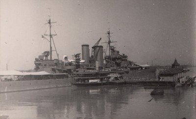

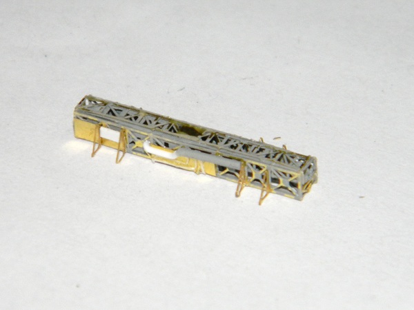

Speaking about the Walruses: I started to look more closely into the catapults they must sit on. To my disappointment Trumpeter didn't quite succeed in making something that could pass. The contraption really should look something like this:
or this:
ref https://www.flightglobal.com/FlightPDFA ... 200186.PDF
Further reference on the catapults on HMS Exeter to be found here:
https://www.seawings.co.uk/images/Catap ... 201932.pdf
Trumpy's cats do not seem quite right, but they are the correct length of 47 ft, the early version. I will think whether I will start modifying these, or scratch built new ones myself.
Wouldn't it be time for a correct PE or 3D printed version of the MacTaggart Scott catapults in 1/350 and 1/700 scale? Both the long and the short versions please! Someone from the PE/3D producers listening to this? I have more documentation gathered!
