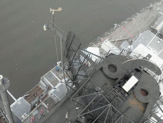

Photos of the NJ's Mast

I am looking for photos that show the New Jersey's mast. In particular, I'd like to find some views that show it from above. Most such pictures I have are so wide that I cannot see any details.

Don't know if this will help, but here is one of the NEW JERSEY's main mast as a museum ship in Camden:
(this is from NavSource)

That's very much. I had never seen anything like that before. I don't know how I missed that on NAVSOURCE.
Unfortunately, that picture raises more questions than it answers. I had wondered why the platform sometimes looks angled at the corners and sometimes looks curved. That answers that. Now I need to know how much is angled and how much is curved.
And what is that ramp?
The various plans I have of this area are inconsistent and at variance with with what is actually in place.

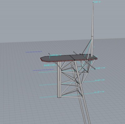

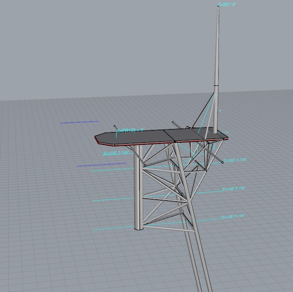

Attached is my WIP. It still has obvious errors.

Ah, optical illusion. It's an elliptical rotating antenna.

Let me illustrate some of the confusion. The picture posted previously shows an elevated area forward and around the edge:
Here's one of the Iowa that does not appear to have that raised area (at least around the edge:

DavidP wrote:those are 2 totally different things as that rig in the 2nd picture is on a roof of some kind not shown in this link. http://navsource.org/archives/01/062/016283t.jpg ends up it is not a roof but the flight deck of the iowa http://www.navsource.org/archives/01/016158.jpg
That big black thing on the helipad is the platform on the mainmast. It was removed at some point and reinstalled.
